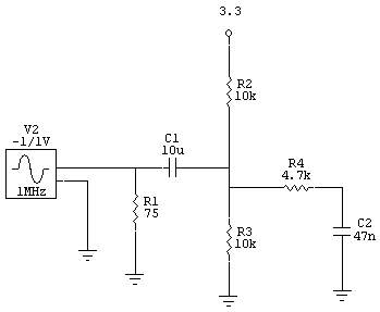

Hi Sidly,
Yes you are right this circuit will not do a true 75 Ohm load to terminate the SPDIF line. It was used since it worked (All the time) . Now that you have brought it up, here is a properly done circuit.
dusfor99 said:
Hi Sidly,
Thanks Dustin, that looks much more conventional. 🙂

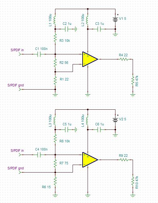

Hi Dustin,
Indeed we'd be in deep trouble if that type of circuit would not work. Every CDP needs a data slicer afterall 😀 (this because despite using NRZI coding, targeted to eliminate the DC content, the RF signal from the laser diode still 'rides' on a varying level of DC)
I drawed quickly two alternatives. Just a note on the bias through R2 or R7: the voltage drop across them, mainly determined by R3 and respectively R8, must be sensibly higher than the hysterezis of the comparator.
I'm using the second one in one of my DACs, inspired from the demo-board of the PMD100 digital filter.
Hope it helps, cheers!
