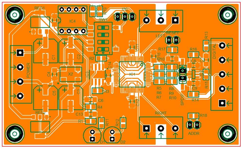

Updated/Corrected schematic
Ok, assuming that its ok to connect DSD1 and DSD3 I am using Dustin's recommendation for supporting 3 signal input and PCM/DSD/SPDIF inputs.
I am using a small PIC12F629 just to do basic configuration like PCM format etc, as well as change the automute setting (thanks Ross!).
More complex control can be added via a separate PCB, and you can simply omit the PIC if you like as it will be socketed.
I am a bit curious about the comparator bit at the SPDIF input. I have never used such a circuit. Does that part look ok? I basically copied that piece from the eval board schematic.
Thanks for the great input so far.
Cheers!
Russ
Cheers!
Russ

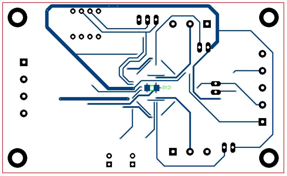

Notice in the new layout the analog output GND traces run directly to their respective AGND pins on the bottom side.

Re: Re: Re: PCB top (preliminary)
I have only done signle boards myself, I think the answer will lie in Russ's board. The PCB looks clean, so it may be no issue. (I hope)
Dustin
Spartacus said:
Dustin, would you recommend against doing I/V on a seperate board connected via wires then?
Dan
Dustin
