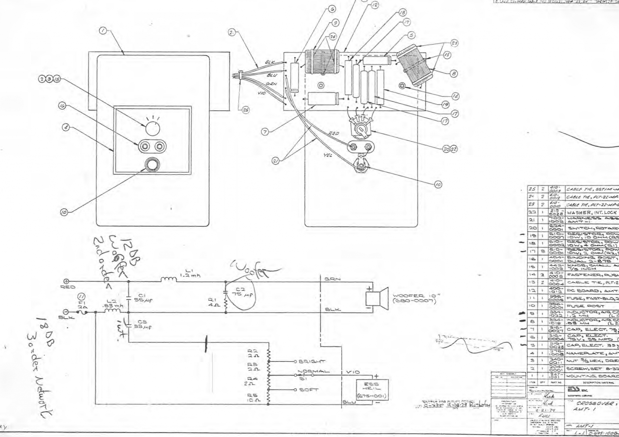

I was referring to the schematic in post #4, that is sourced from the document in post #13.

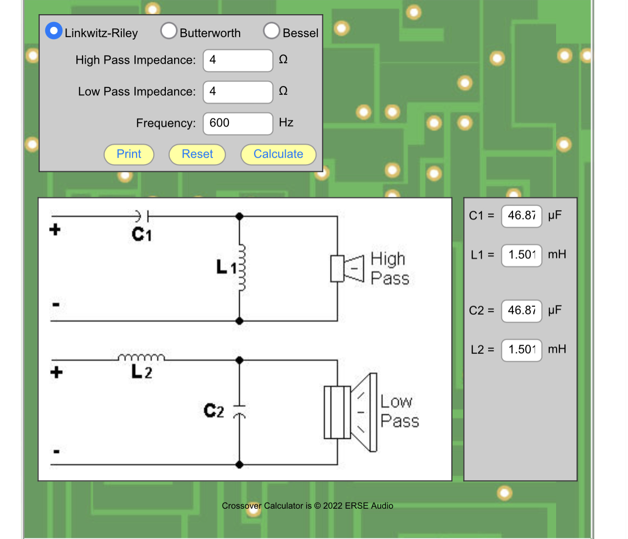

If you have the AMT-1 with the port on the bottom and want to keep the factory crossover point at 600 hz.
Here is a link to some neat crossover tools:
https://www.erseaudio.com/CrossoverCalculators
Having been intimate with the development process, I can tell you the factory crossover was more like 800 Hz. ESS was eager to represent the AMT as going lower, but also wanted it to play loud, so a higher frequency won out in reality if not in the promotional literature.

Thanks Nelson! Nothing better than knowledge from the one who was there and made it happen.Having been intimate with the development process, I can tell you the factory crossover was more like 800 Hz. ESS was eager to represent the AMT as going lower, but also wanted it to play loud, so a higher frequency won out in reality if not in the promotional literature.
I pulled the 600 hz from this. Must have been very early - maybe the we haven’t released it yet brochure.
https://audio-database.com/ESS/speaker/amt1-e.html

That looks to be a later schematic - during my time they used two pole filters.I'm just going to upload this image of the post #4 schematic from the documentation I found
This is the one I wanted to build, though I'm tempted by tjw59's schematic now.That looks to be a later schematic - during my time they used two pole filters.
The original crossover in these is the earlier version with the 20uf and 50uf capacitors. Another variation on that crossover used another 20uf cap instead of the 50uf one. Seems they went through a few iterations.

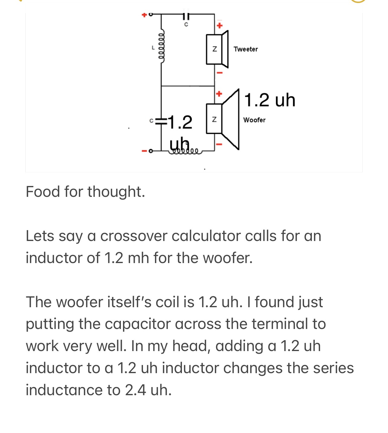

On the first round I used the 16 awg for the woofers. Then switched to the foil for both with the 12 inch project. Then one night - this hit home.You said you used the foil inductors for both positions for the second round. Did you use the 16AWG for both positions?
Here are the specs of the 10” woofer. Note the Le = 1.2 uh.You said you used the foil inductors for both positions for the second round. Did you use the 16AWG for both positions?
https://essspeakers.store/products/ess-factory-10-woofer
Are you saying to omit the inductor for the woofer?Here are the specs of the 10” woofer. Note the Le = 1.2 uh.
I did and it worked very well.Are you saying to omit the inductor for the woofer?
Why would I do that?

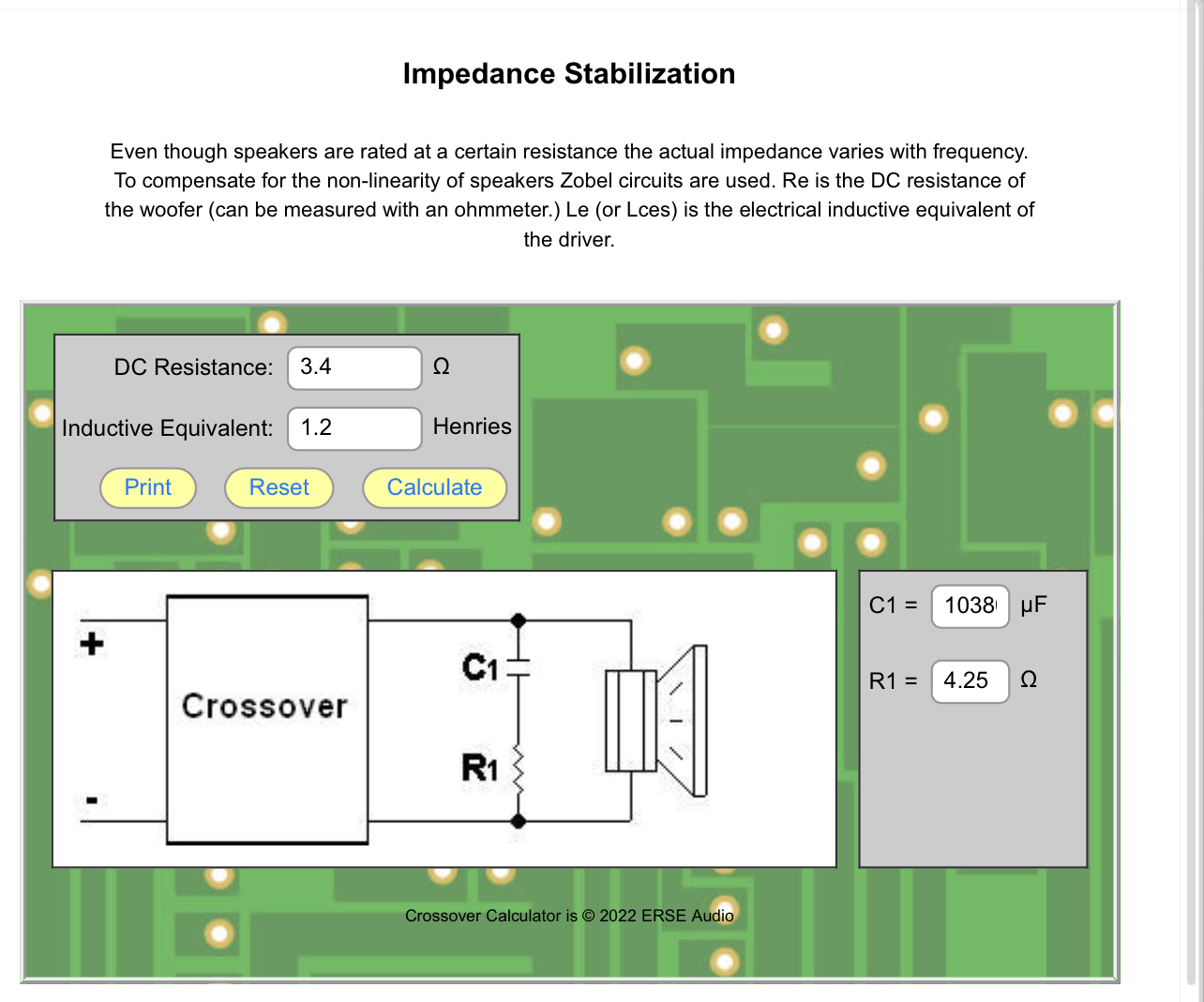

I matched AM broadcast antennas for years. And we always took into account the reactive component of the load.
I never see this talked about anywhere. So one night I took an alligator clip and shorted the inductor. It is kind of blind luck in this instance that the specified inductor is the inductance of the speaker coil. But it is: and it works fine.
What sound difference did you notice when you did this?I did and it worked very well.
