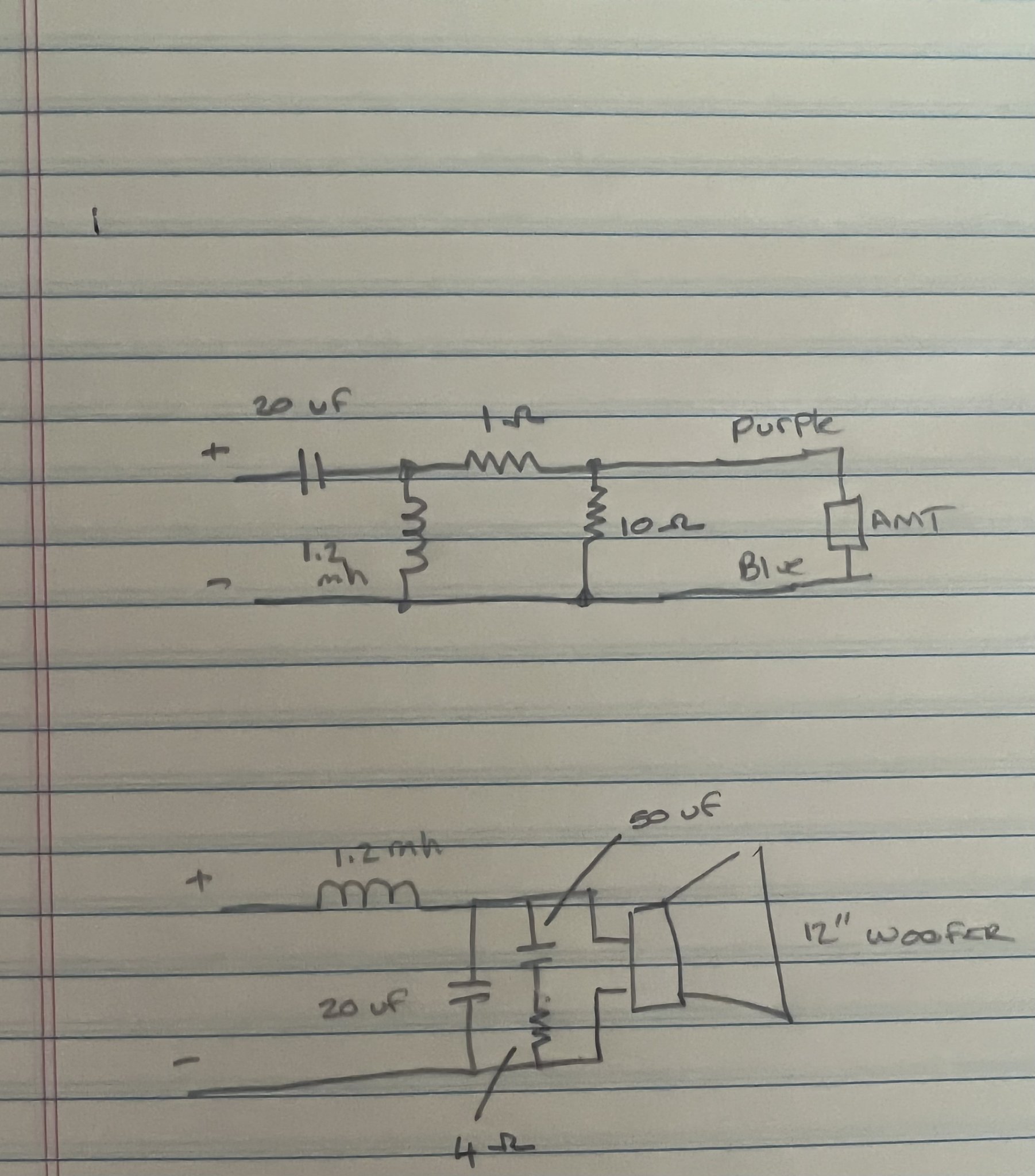

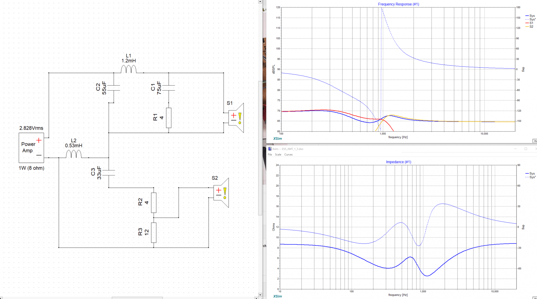

I'm not sure what I'm doing wrong but I'm testing this on the bench with just the woofer at the moment with a sweep test and the woofer is running full range, with or without the inductor. I can't find any mistakes.
EDIT: So the tweeter has to be in the circuit for the woofer to crossover it seems. I'm a bit new to really doing the deep dive on crossovers.
I built the crossover and put them back together. They sound tweeter heavy. Thinking I should add an L-Pad or a resistor in front of the tweeter
The inputs should be paralleled. So no - you shouldn’t need one connected to get the other to work..I'm not sure what I'm doing wrong but I'm testing this on the bench with just the woofer at the moment with a sweep test and the woofer is running full range, with or without the inductor. I can't find any mistakes.
On the notebook paper version of the schematic, there is a series 1 ohm and parallel 10 ohm resistor on the heil. That settled that down nicely for us. Takes it down by 3db. Also run the heil out of phase with the woofer.
I do have those resistors in place as your first schematic shows.The inputs should be paralleled. So no - you shouldn’t need one connected to get the other to work..

I didn’t really notice much change over the time we used that configuration , no. Truly a case of just because it can go down to 500 cps. Doesn’t mean it should. : )I do have those resistors in place as your first schematic shows.

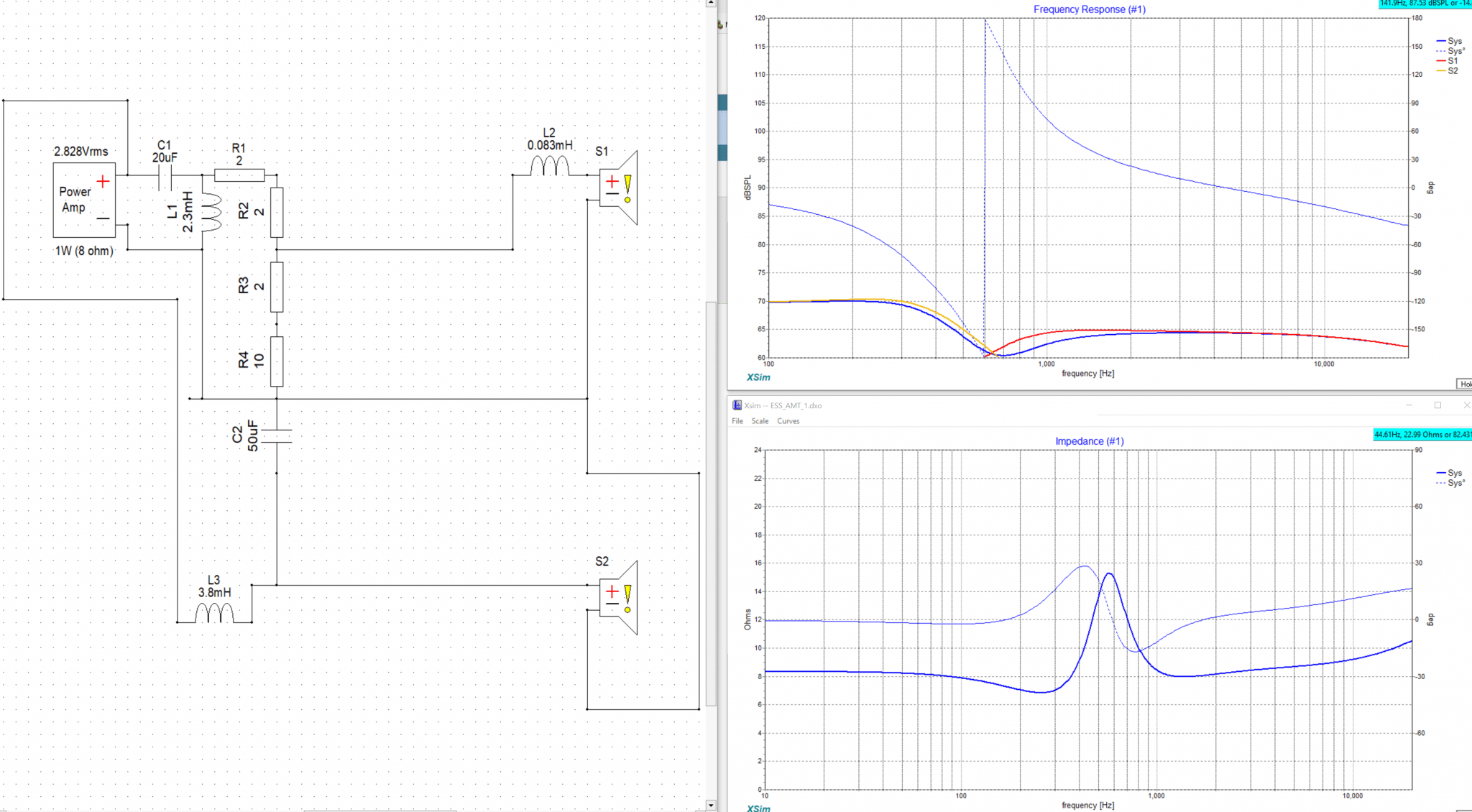

I'm listening a bit more casually now with the amp/preamp the client will be using. I've got a record playing. It is sounding pretty decent at the moment.
I ran a sweep test and used the db meter on my phone and things looked to be reasonably even.

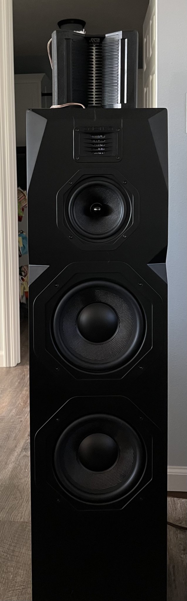

The client's system seems to be a good match for these. The Sansui 2000 as a preamp gives a warm and laid back sound which seems to even out these speakers nicely. And the Kenwood power amp gives them more power than the Sansui would.
The 10 inch cabinet (with the port in the bottom) was by far our favorite and that crossover sure did a nice job when we changed to that. If you don’t need to fill a stadium with sound. That setup gets along really well with (2) Amp Camp Amp(s) in the parallel mode.The client's system seems to be a good match for these. The Sansui 2000 as a preamp gives a warm and laid back sound which seems to even out these speakers nicely. And the Kenwood power amp gives them more power than the Sansui would.

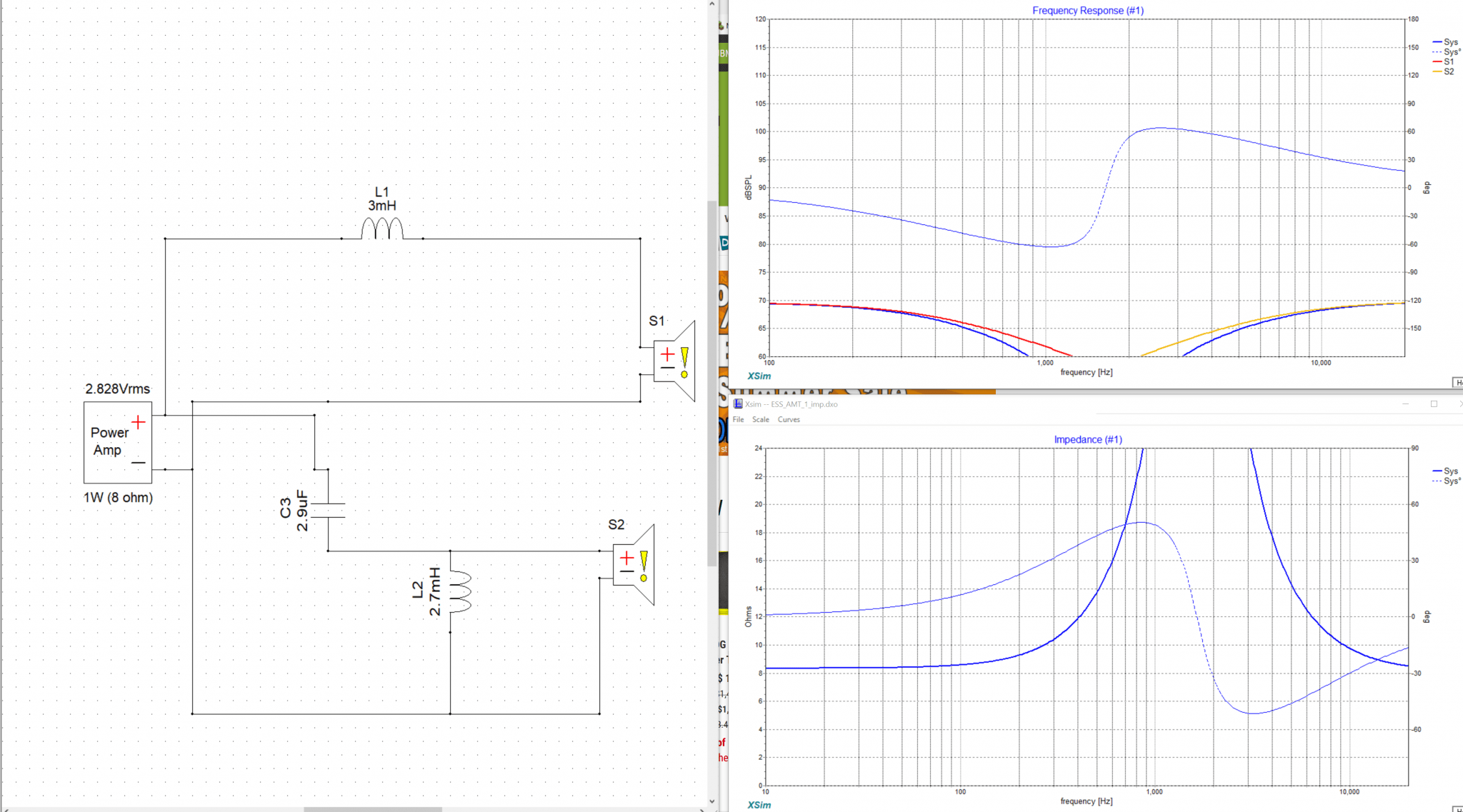

Don’t believe there are any for the AMT. They’re not normally mounted in an enclosure.Let me me clarify, Do any of you have the TS parameters for AMTs?
Mostly, T/S parameters are to help lay out an enclosure based on the mechanical characteristics of bass drivers.These will not be in touch an enclosure
If anyone has the TS values, this would be very helpful. I'm trying to model my complete speaker in basta.

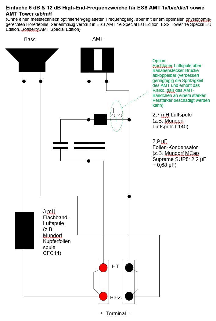

- ESS AMT1 Crossover. What cap values should I use? So many different versions.
