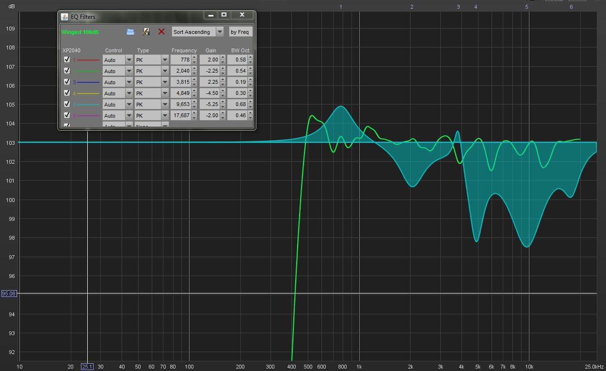

Here is what the DSP PEQs look like for a fully broken in set of two AMT-1s stacked on top of each other with 7-inch wings, showing the corrections from 4-7 kHz as a local rise in amplitude that needs to be attenuated. Note the vertical scale is in single dB increments to highlight the corrections in SPL vs. frequency:
The 4-7 kHz area is affected by using two AMT-1s and side wings--thus raising its relative output a bit around the 5kHz disturbance.
Also note that microphone radial position is pretty critical when taking measurements. I recommend being a little off-axis (about 5 degrees horizontally) in order to catch the local higher SPL just off-axis that I showed in the polar plots, above.

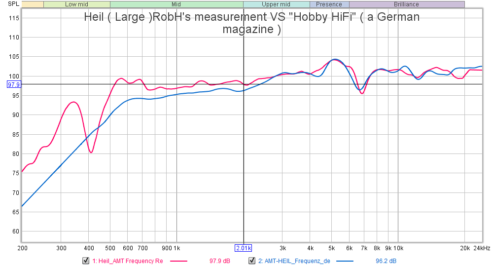

When I started a build thread at Lansing Heritage there were numerous questions about measured Heil FR measurements. There is a comparison with my measurement compared to a magazine posted will add it here. Apparently they seem to have varied over time.
The original measurement was new no real time on the driver. Used that to design a network. Ended up going active 24db L/R with a passive a 5K notch filter to help smooth the on axis a bit. So no real break in time.
For clarification the light grey is raw and the black is with a passive18 db network and notch I didn't end up using.

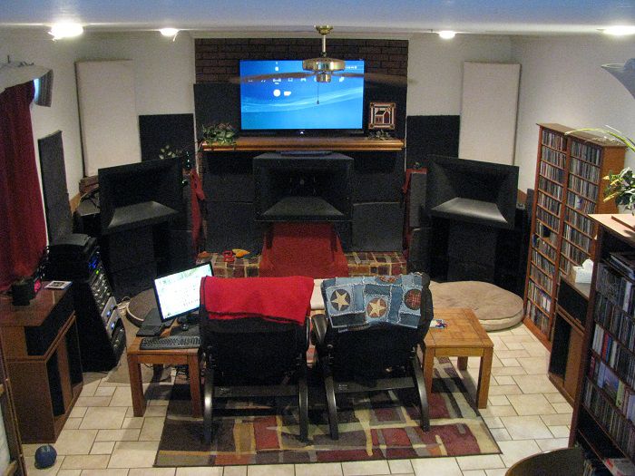

I'm using double-stacked AMT-1s on top of Belle Klipsch bass bins with the top AMT-1 leaning back ~15-20 degrees to spread the vertical response--as two-ways with the bass bin only. The AMT-1s replace the midrange and tweeter horns/drivers in the Belles; the top hats are still attached but not in use--to serve as risers to get the centerline of the AMT-1s at or above sitting ear height without having to raise the bass bins above floor level, thus avoiding cavities under the bass bins. The only down side is the increased vertical spacing between the AMT-1s and the centerline of the bass bins,,,a trade that I made while listening to both configurations (on floor and elevated) while moving around the room and listening....Am I understanding you correctly that you are NOT using wings and still having good response in the crossover region? How large are the bass drivers and crossover point/slope?
I use a miniDSP 2x4 HD to cross them at ~650-700 Hz and to EQ the amplitude and phase response (min-phase only), yielding less than 180 degrees of smooth phase growth from 20 kHz down to ~50 Hz at the -3 dB bass bin roll-off point (in room boundary effect). No FIR filters are needed and there is no added all-pass phase growth from the crossover, which acoustically achieves about -12 dB/octave slopes,
I'm not using wings because these are serving as my surrounds in a 5.1 array, so they never really play music at >100 dB/1m. The double stack arrangement provides enough efficiency to keep the individual AMT-1 diaphragms below their distortion limits. If I needed more efficiency, I'd add one more AMT-1 on top of each existing stack (I have these in storage right now), and if more efficiency were needed, I'd add wings. I found that I didn't need three-high stacks for this application.
If I were using them in one of the front three in a 5.1 or in a stereo setup, I'd use wings because for my needs they need to be able to play well over 100 dB/1m in those positions without the diaphragms running out of low-distortion excursion limit below ~1.7 kHz.
