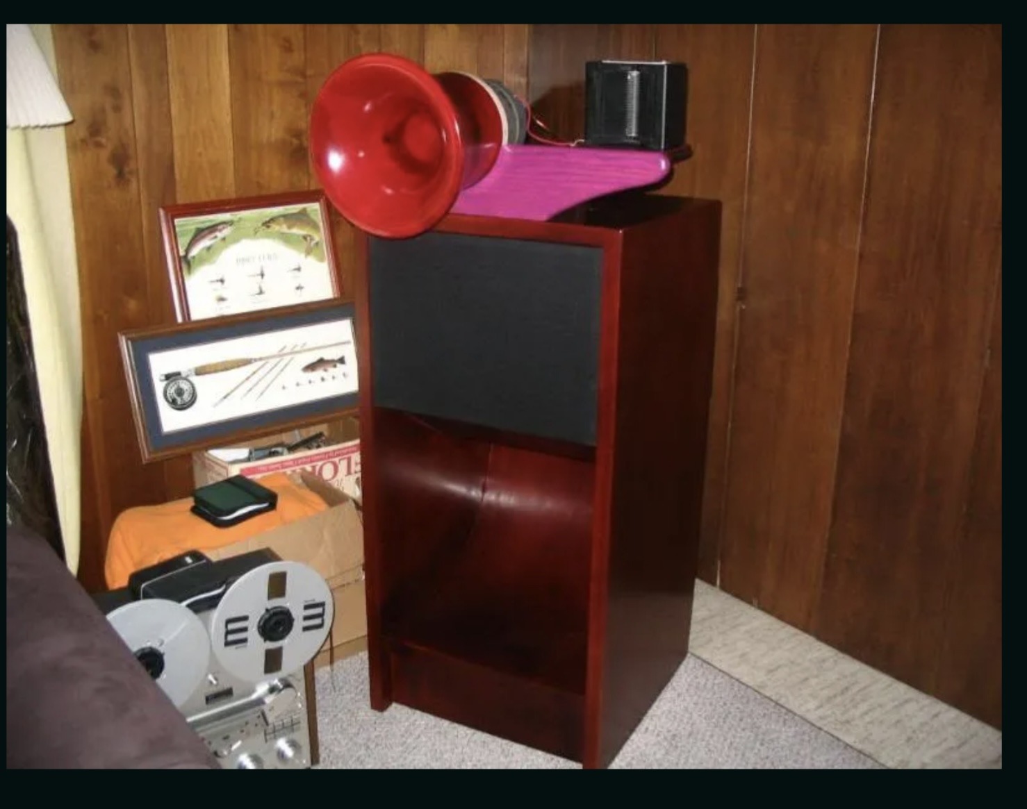

What is the brown curvy piece against the wall below the paintings? Bandpass sub?
P.S. like your style.

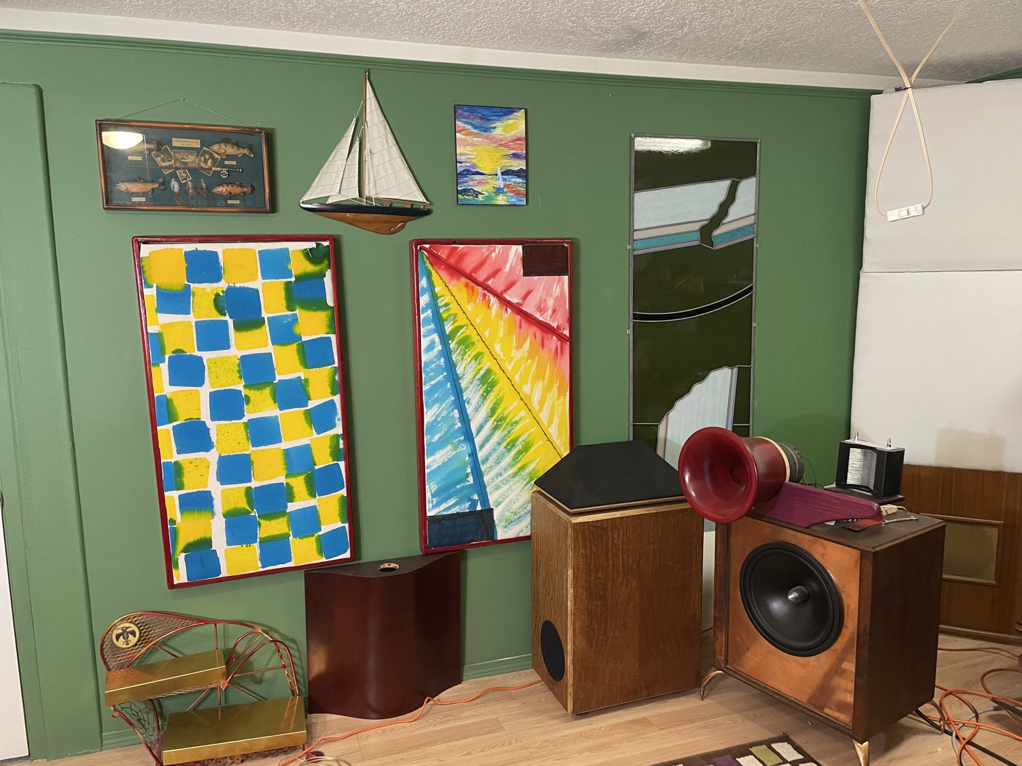

I bought these JBL 4530 scoops and they had those bent pieces on top that held a round JBL tweeter. As you can see, I replaced them with the midrange horns and AMT tweeters.What is the brown curvy piece against the wall below the paintings? Bandpass sub?

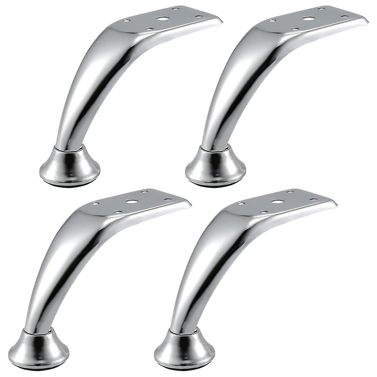

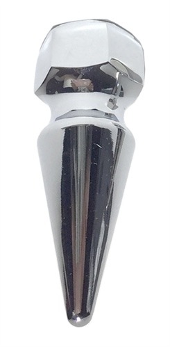

I first bolted the spikes in place then welded them with enough weld to fill in the gap and ground them down so they look like one piece.
