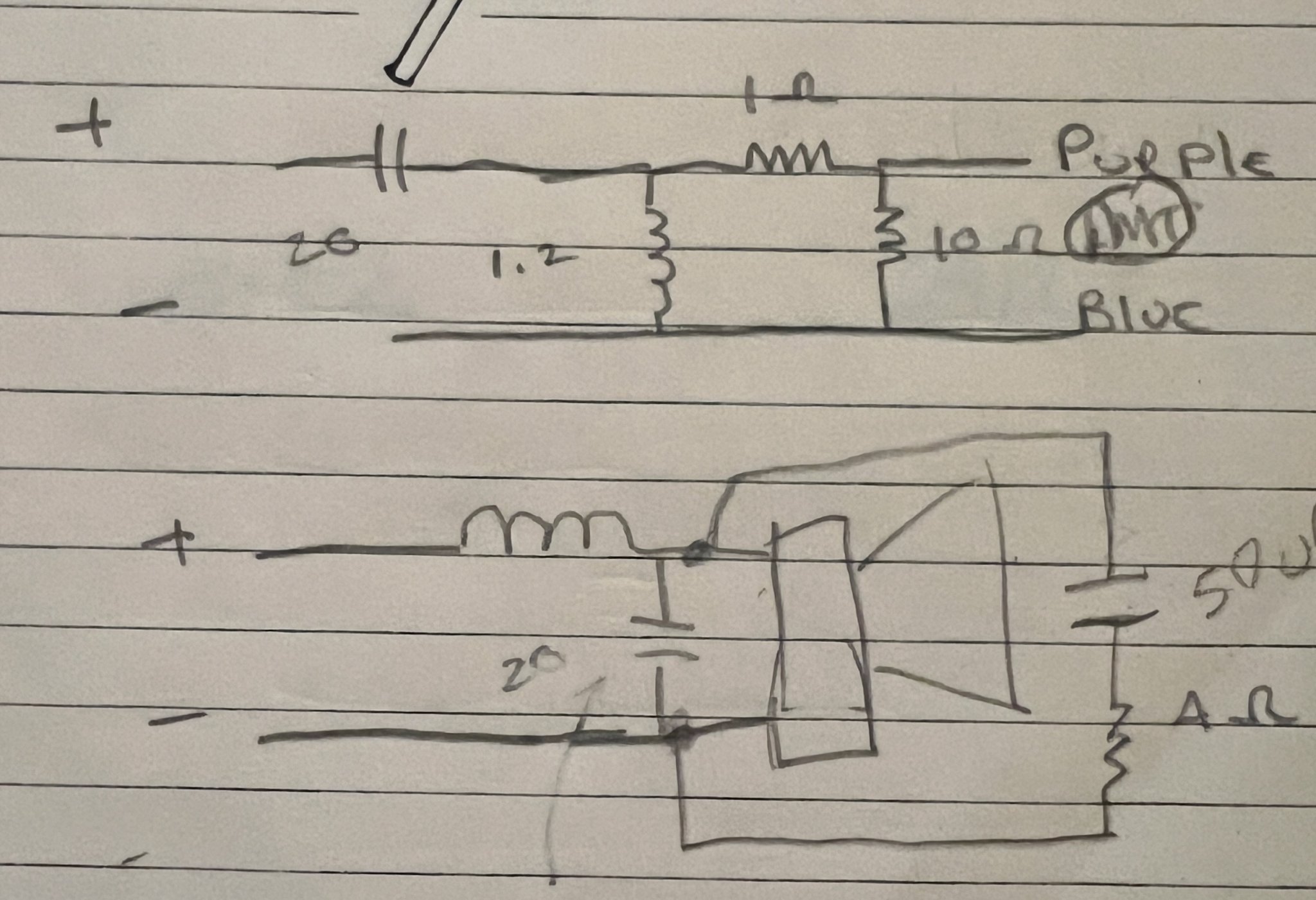

20uf caps
1.2 uh coils
50 uf and 4 ohm resistor for zobel across woofer
1 ohm series and 10 ohm across the heil will tame it down nicely.
It will cross at 990 cps and some change.
When you set the inductance of the woofer coil, measure the inductance of the woofer itself. If it is .8 for example: add the difference (.4) with your coil to get 1.2.
Reverse polarity

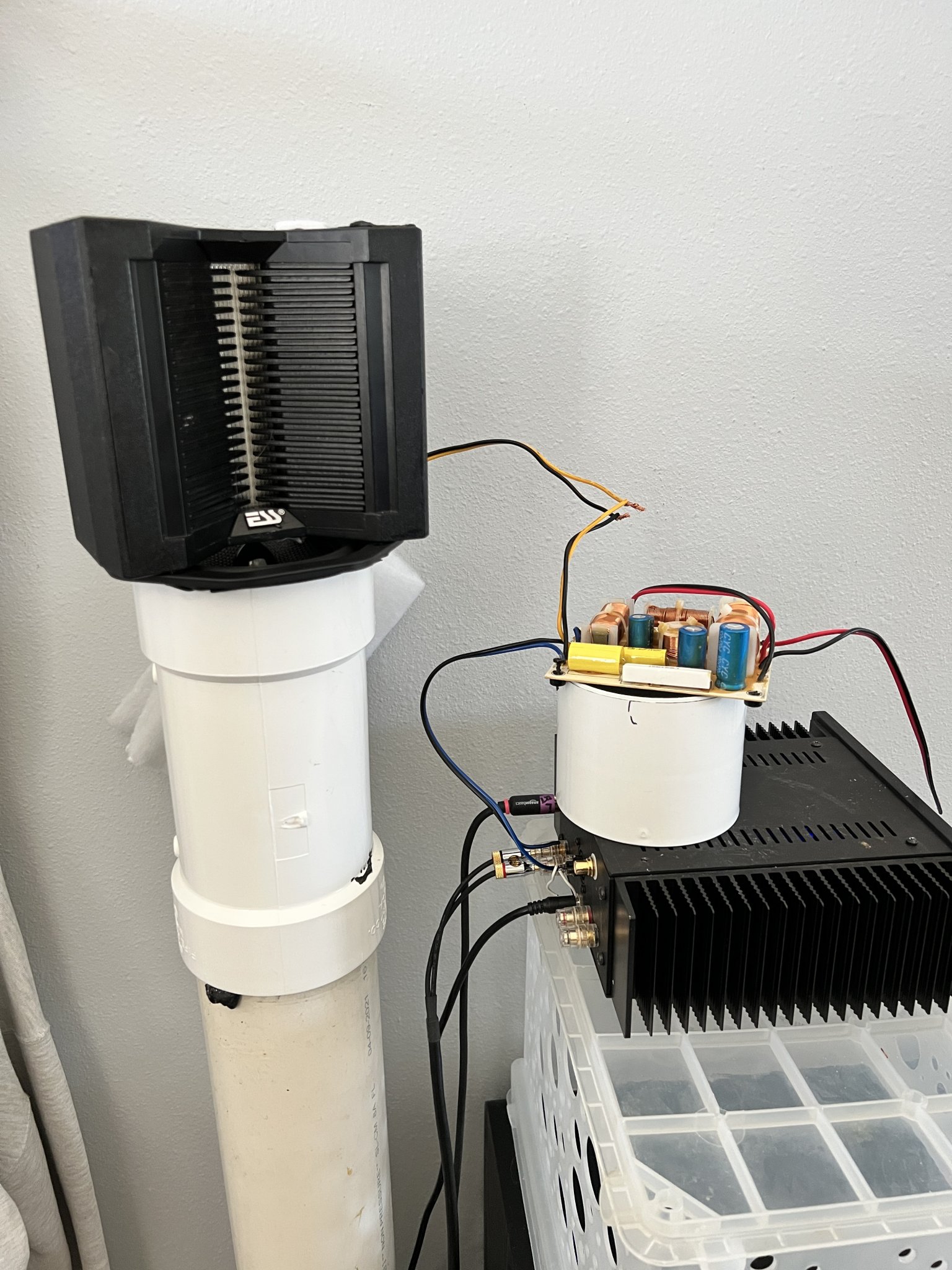

Here is something I have been playing with.
full range driver that is reasonably flat from 100 cps up.
The enclosure in this case is a piece of 4”PVC and its volume is .3 cu feet.

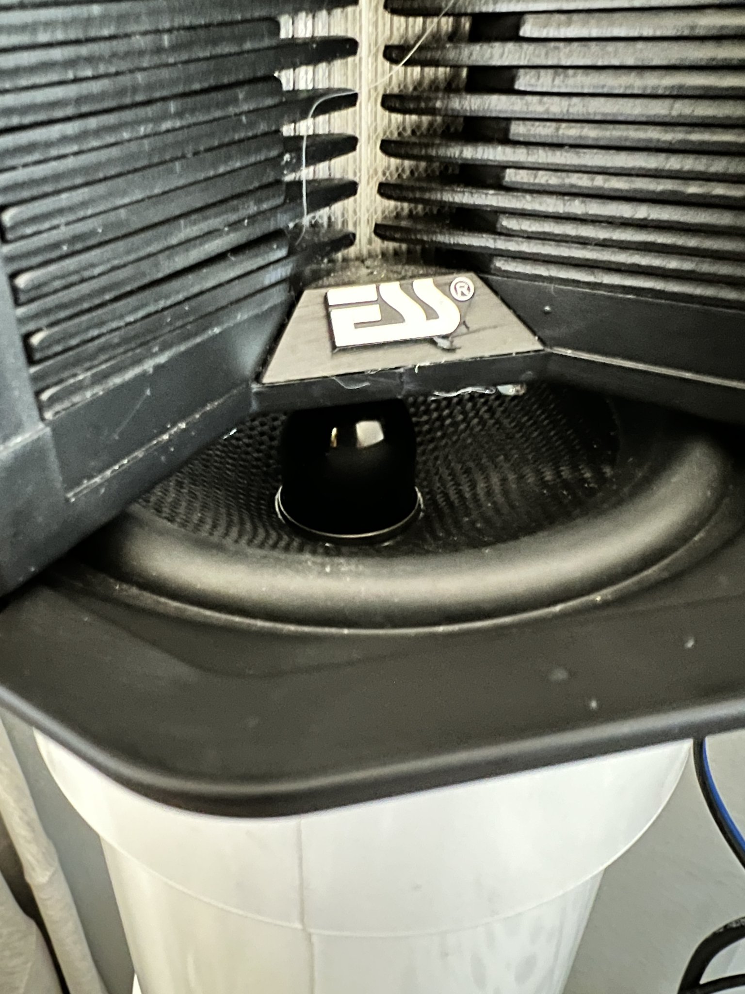

The bass driver is a 5 1/4 inch full range mounted in a 4 inch PVC Tee. The bezel fits right over the top.
The heil sits on the bezel. Centered over the full range.
Because the heil is a flat surface. It acts as a slot for the bass driver. Accelerating the air a bit.
I’m crossing this at 2600 cps because that was the crossover I had available.
Incredibly clear vocals!
Obviously you need something for the rest of the range. I’m using an SVS sub and crossing at 120.
Expand on it! Nothing in stone about it. This is the first throw and it sounds awesome.

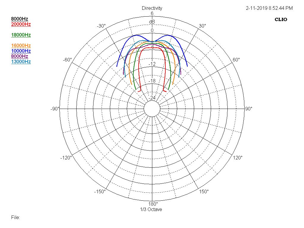

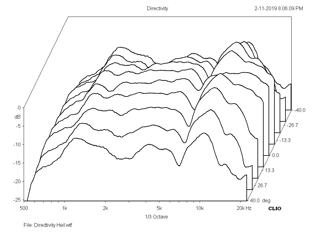

Does anybody know the polar pattern of the ESS AMT in the typical crossover frequency area?
Does it behave like a 'true' dipole or is it more narrow or wider?
Additionally - Is there anybody, who has experience in crossing over the ESS AMT to an open baffle woofer, keeping constant/controlled directivity (horizontal) with e.g. a 15", 12", 10" or 8" woofer?

I would recommend 15" woofers if crossing at ~800 Hz. Smaller diameter woofers can be used if crossing at higher frequencies.
The rule of thumb is the active width of the woofer cone needs to be ~1/2 wavelength at the crossover frequency.

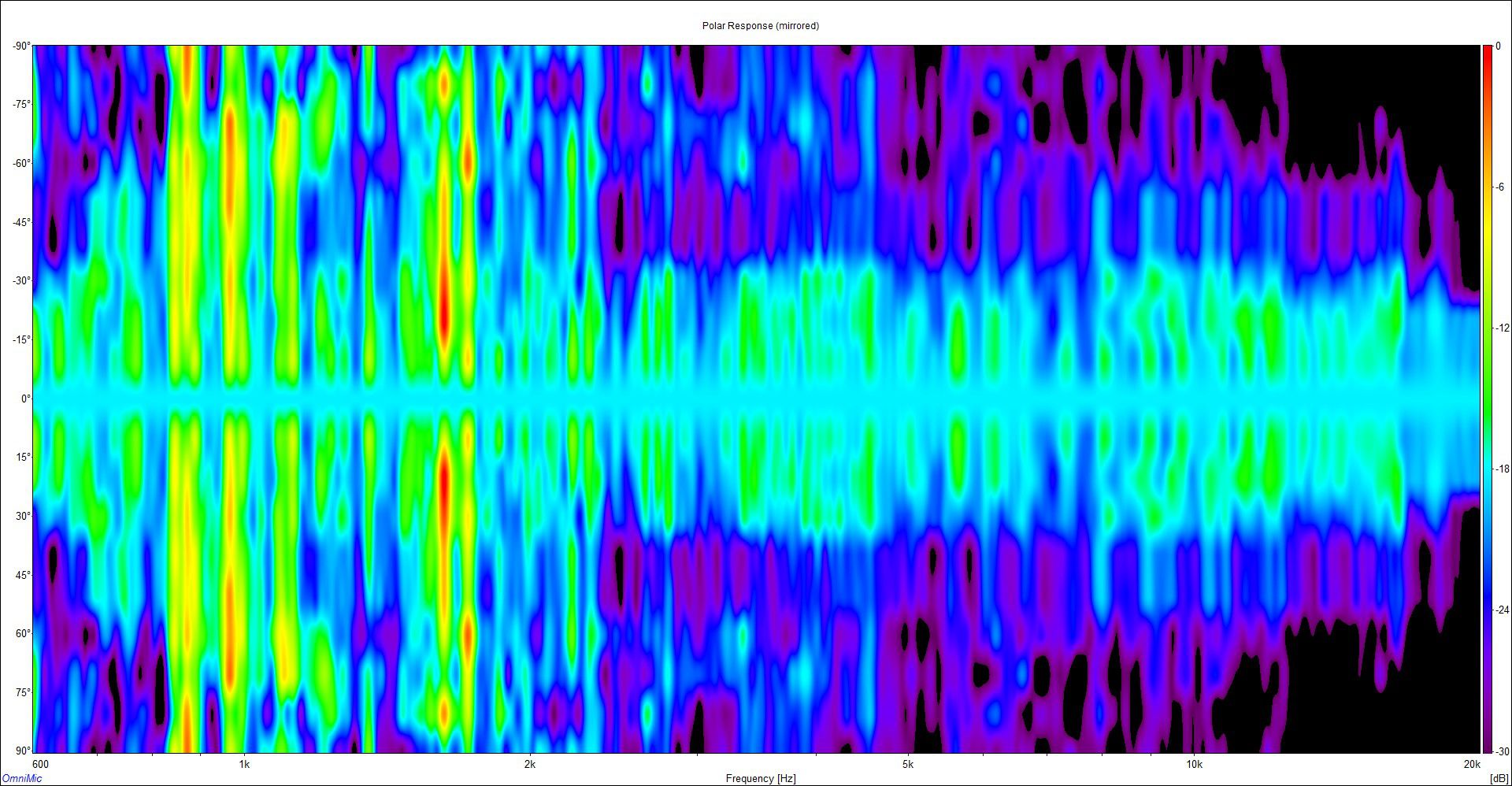

Hi Chris, thanks a lot!
Can you help me to read this diagram?
What I can see, is, that the polar pattern looks quite homogenous from 2kHz upwards.
What I understood additionally is, that you can extend this behavior to lower frequencies by using wings or a horn.
But what does the diagram shows us in absolute numbers? How many dBs less compared to on-axis do you have off-axis at e.g. 30°, 45°, 60° in average on this picture? Probably I overlook something, but I do not understand, where to see the values for specific angles.
Thank you in advance!!!
This is the same data in a normalized polar sonogram format. It's a bit noisy since it was taken on top of my right surround loudspeaker in 10 degree increments:How many dBs less compared to on-axis do you have off-axis at e.g. 30°, 45°, 60° in average on this picture?
This is actually the only data I have on the polar performance of the AMT-1 (on top of a loudspeaker--i.e., half space).
Chris

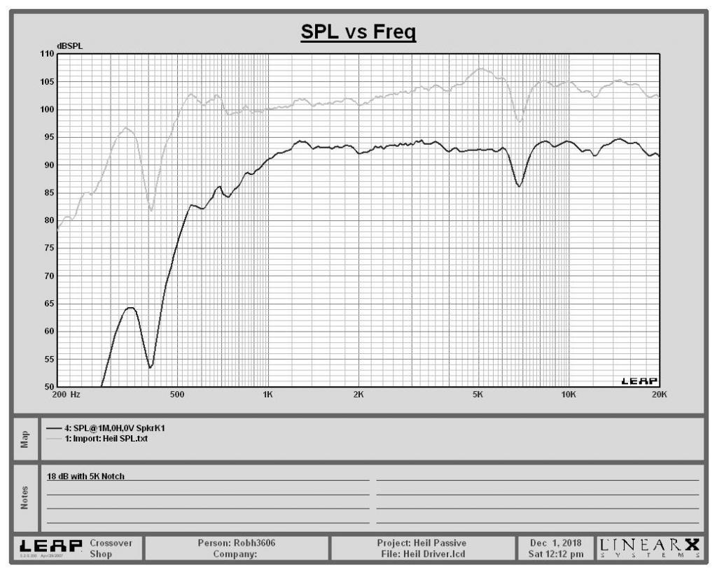

One of the features of the AMT drivers that I've found is that they really change their SPL response quite dramatically over the first few hours of their use. The changes were such that I had to re-EQ and cross the AMT-1 after the diaphragm had worked in/relaxed. I have not seen such change in any other drivers that I've owned.Not sure of the difference but this is what the currant version measures like. Top light gray curve.
Rob 🙂
After a few hours/days of use, however, I noticed that the changes completely stopped and the driver was extremely stable in terms of SPL and phase responses.
