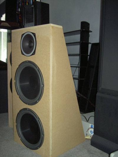

The fronts are 1" plywood and have no vibration to speak of, especially on the edge. The Heil's weigh 12 pounds so are not easily shaken anyway. They go down to an honest 32 hz and will startle you with transients like the 1812 Overature has. I literally jump at times. Always available for an audition.

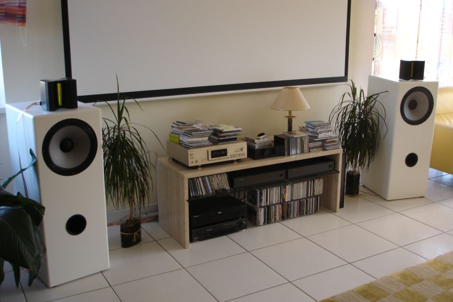

Let me present my system (which is quite not definitive....and should evoluate to an 5.1 system with 5 ESS).
Drive: Micromega CD3.1
DAC: Perpetual audio P3A
For home cinema and SACD: Sony DVP NS9100ES in digital stereo interconnection with the DAC
Préamp: passive (selector + Noble volume attenuator)
Aktive Filter: Kaneda circuit (from La revue de l'audiophile- french), a very fine and transpoarent filter: still in work after 20 years and always on ! crossing at 800hz (!) and 18db/octave butterworth.
This part is in progress (I am about to buy a filter -for the 3 front 2ways - from Thel audio in Germany)
Amps: 2 amps (one for each channel): Naim NAP 180 ( really powerful but a little bit transparent ! ) a third amp is waiting for the center channel.
And finally the drivers in a 100l ultrastrong bass reflex enclosure with:
- 12'' ultrafast bass (big motor) with light paper cones (coated special): made specially by Davis acoustique (french constructor) for the MHP in Paris.
- AMT V (yellow membran)
-The center channel, made in the same way...(3 AMT on progress...)
A 15'' FOCAL subwoofer on constructioni
- some cables (for a next reply, could be told in another thread )
All the system is in a room of about 45 m2 (on corner), and was measured and corrected with a friend on PC and after, optimized ''à l'oreille'': with the ears...
I must say that this system is ultra fast even in the bass and so powerfull even cut at 800 hz!! which can reproduce the finest violin without some cut between the drivers (thats a big point) and If I turn the volume, it can be so powerfull that your ears will fear!!!
What can be better: there is always some thing to do and perhaps should I work on my passive préamp, change and match some cables (important, but I aml not the guy who spends the money with esoteric and expensive cables)...
Allways intersted by your replies (but excuse my poor english)

I enclose a photo of my system (when it was in stereo only: not mutichannel)

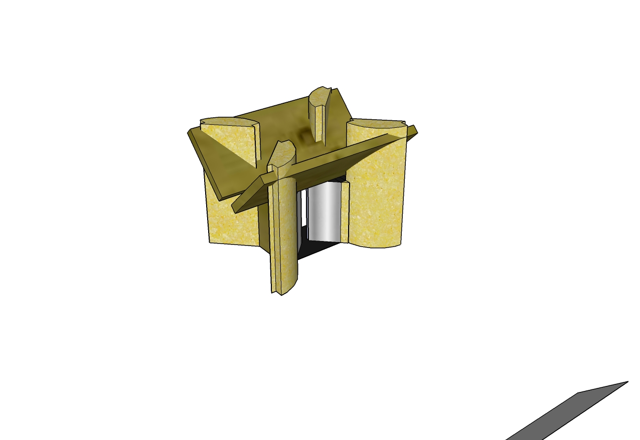

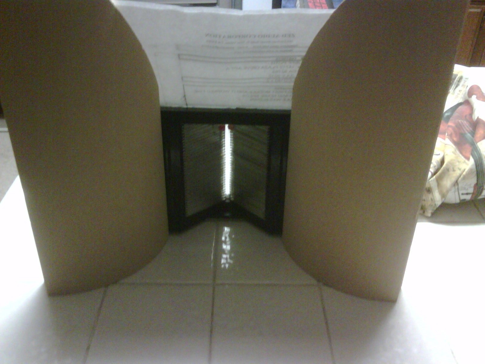

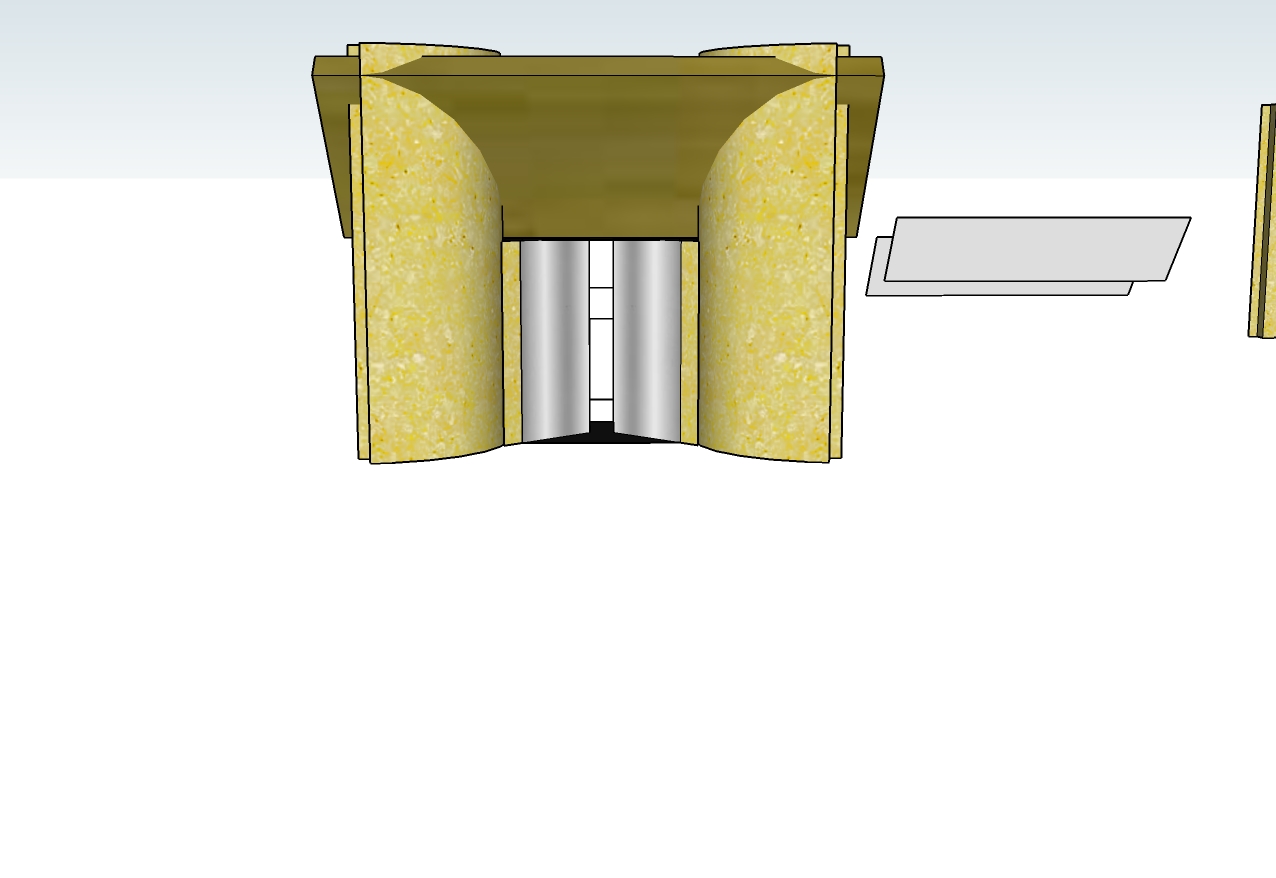

I have been trying to voice a design with an AMT, and I feel adrift without a compass. Setting this up measured flat, or with a couple dB of BBC dip is pretty useless with the dipole AMT shoveling HF energy into the room with great efficiency. 6 dB down on the AMT? Sounds like excessive "reverse" baffle step, but its very hard to tell. I have an active crossover, and have tried everything from flat to -12 dB on the Heil, and all I really know is that flat is too bright and -12 dB is too dull. Anybody ever come up with a typical setup for the AMT that stood the test of time in terms of relative amplitude with the midbass? BTW, the crossover is 4th order LR, nominally crossed at 1200. The midbass pair should be giving me 101 dB half space efficiency according to the data sheets.
