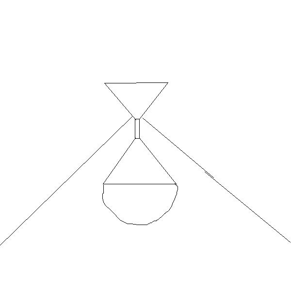

The shape of the horn is the minor issue with throat reflections. The cancellation is the major issue, you'd get not only an incredibly jagged (and unstable) F.R., it'd be nominally LESS sensitive than the forward wave of an unmolested heil. If it were a bipolar source rather than a dipole, the better method would be per this pic, with the ribbon as the source and the expansion utilizing the one magnet wall, and a round section added to the side of the heil, basically forming a teardrop phaseplug. But because it's a dipole, they don't sum but rather cancel, and you'd get an even lower output from this arrangement than yours, because the summation would be much more coherent and there wouldn't be the randomizing factors of stored energy in the throat.

Only works with a bipole source, not the dipole that the AMT is. Dispersion would be defined by what you did with the round part of the teardrop shape, and the angles of the sidewalls. I'd expect it to be fairly good at constant directivity in the horizontal band, but none of it matters. It's a dipole and won't work accordingly.

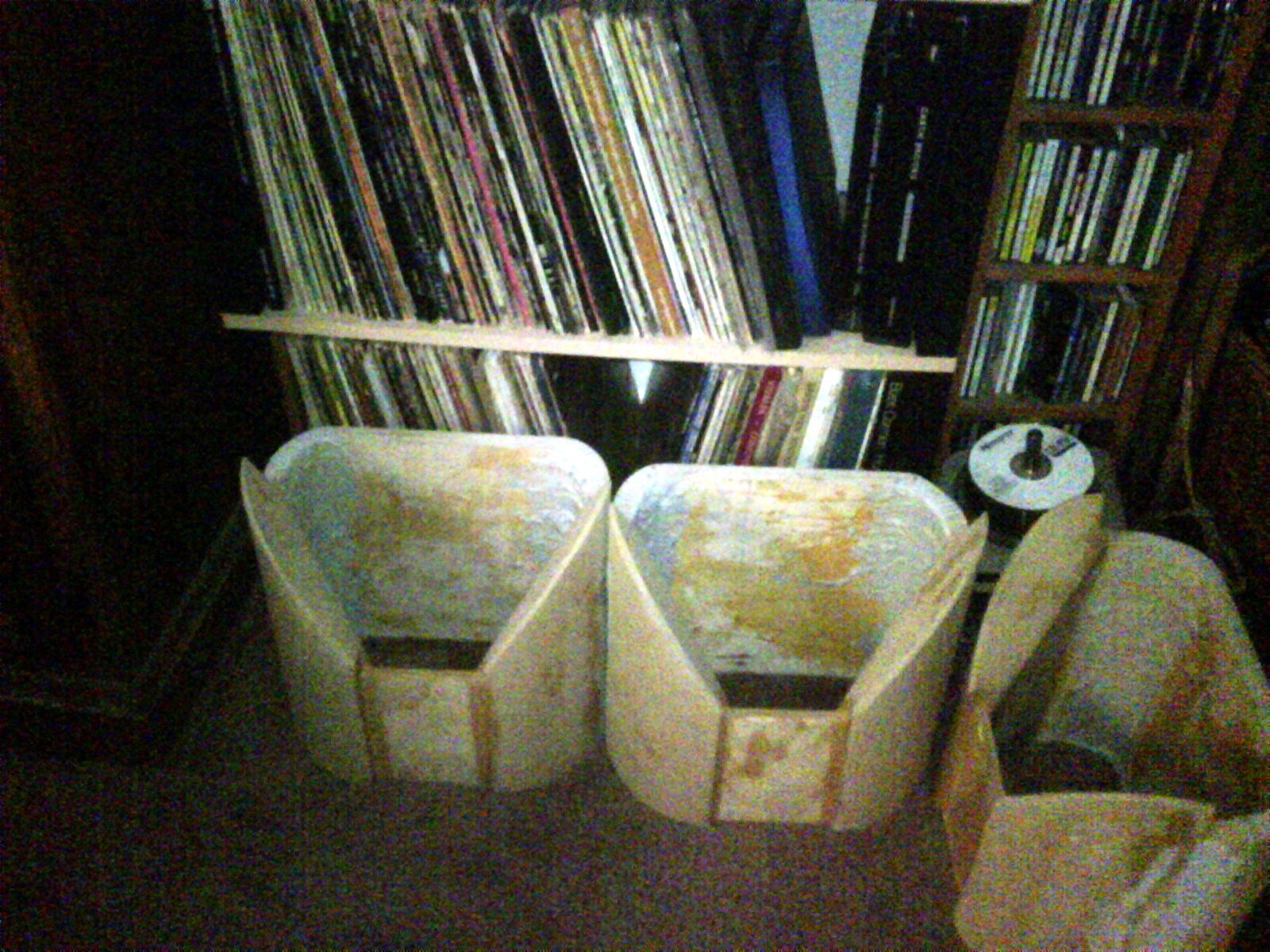

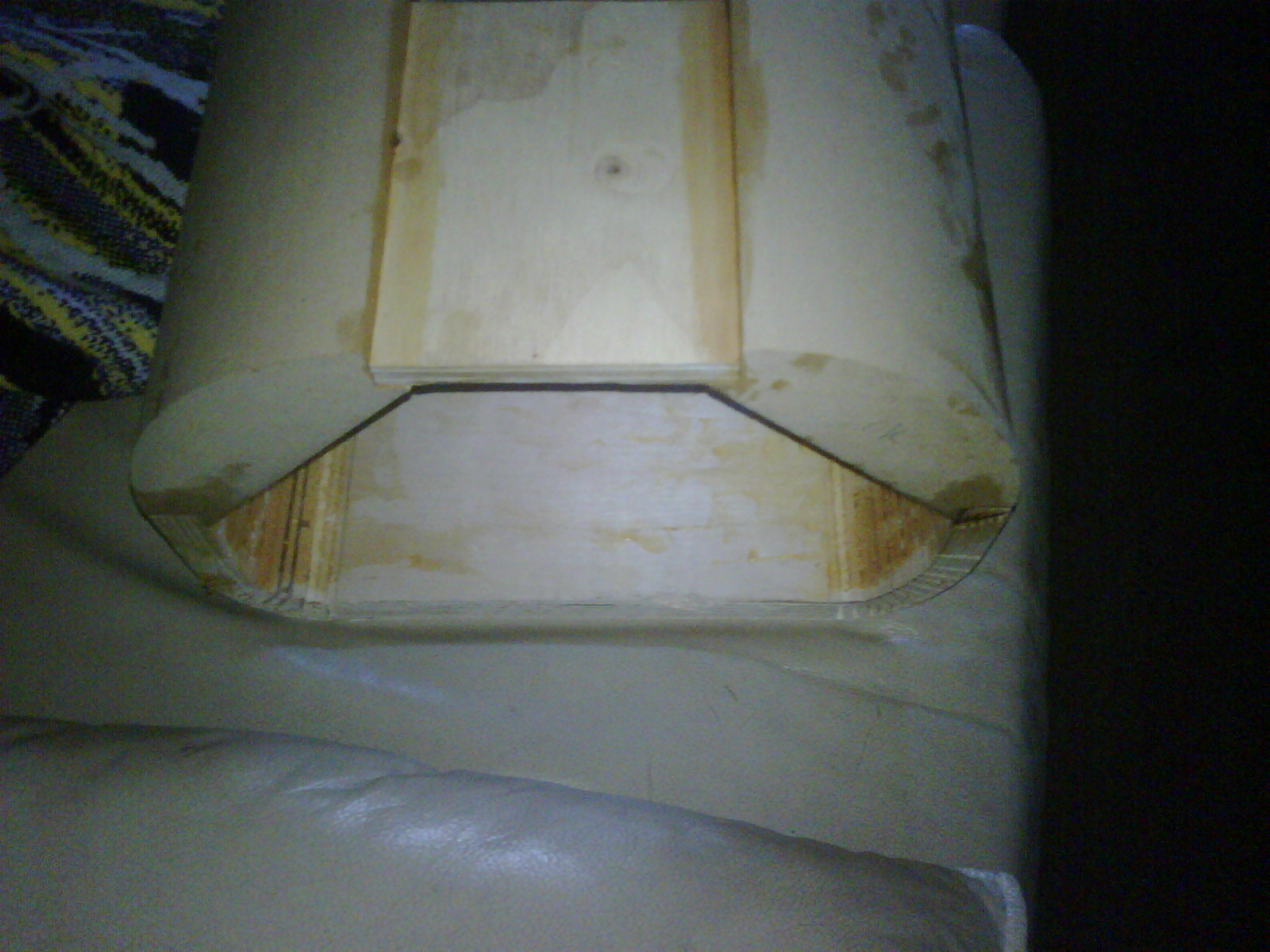

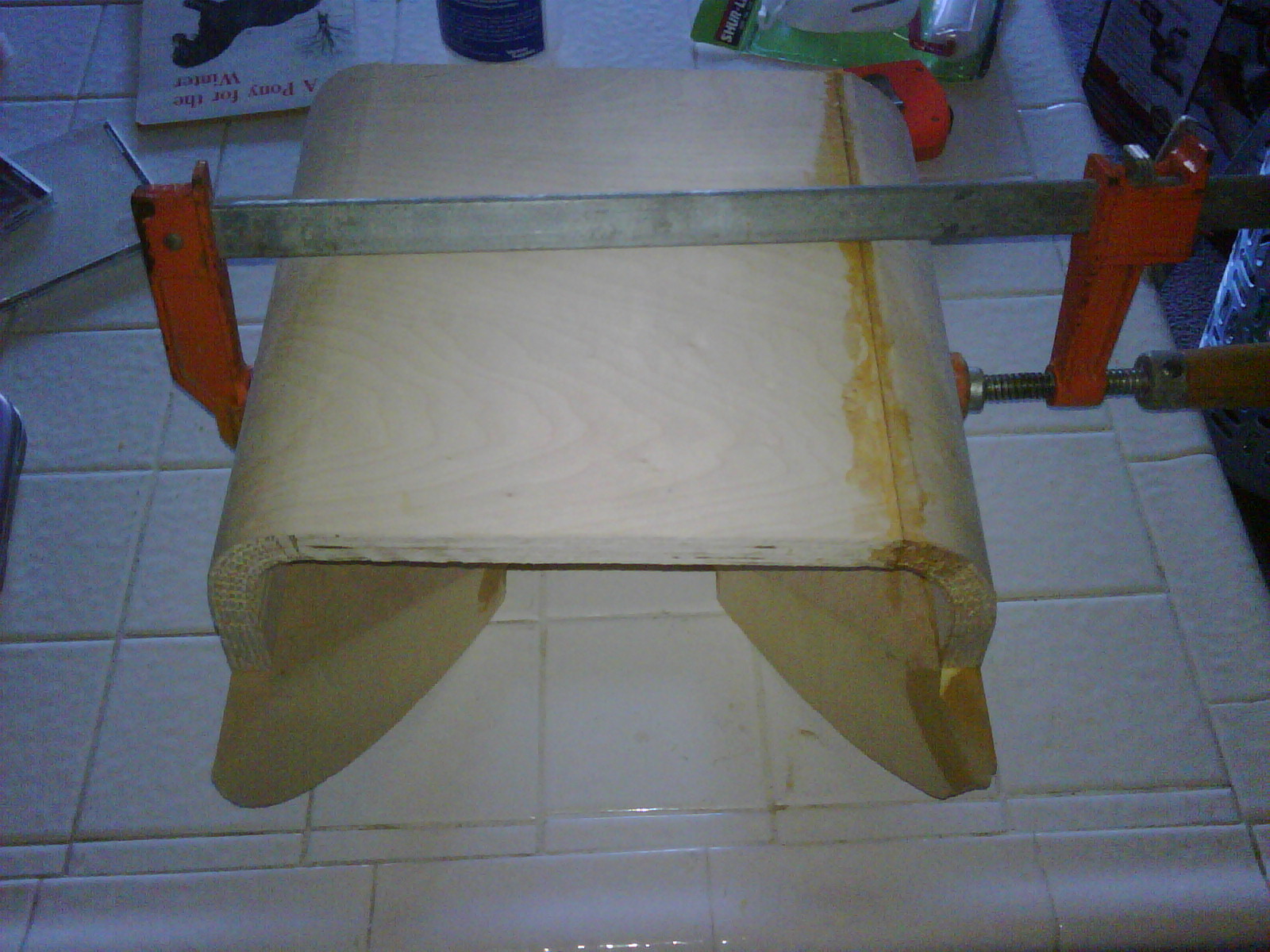

Let me see if I can rig that up when I get measurements done. I'm still in the assembly phase. I need to create and mount the triangular insets, as well as apply the kerf-cut rounded outer pieces (which are all cut), and smooth the top profile for mounting of the vertical horn component.

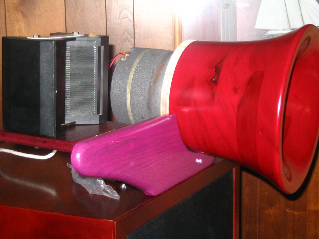

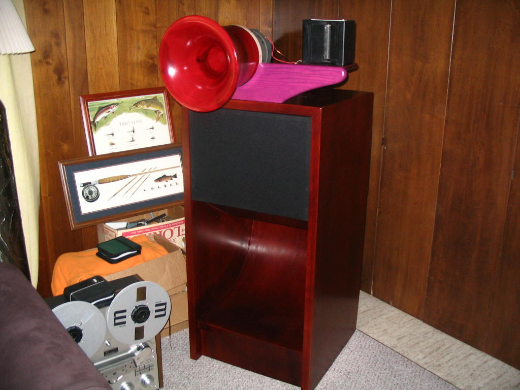

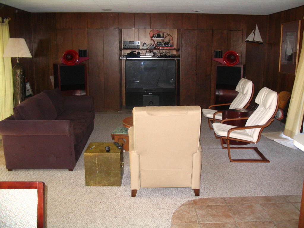

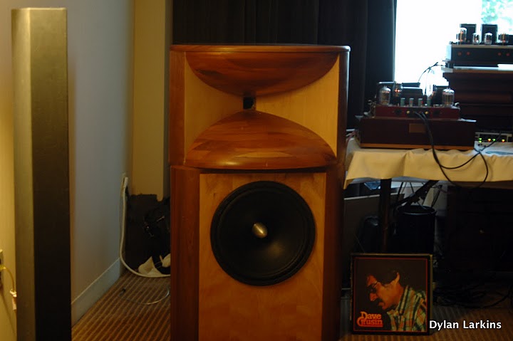

I've read through this tread from time to time. I love the AMT. Here is a pic of how use them. Those are Edgarhorns with JBL 2441 Compression drivers, and the bass bins are JBL Scoops with JBL 2205 15" woofers. I also have a DIY Martin Logan sub in each corner. Cheers.
10k first order or thereabouts? Tractrix bowl from 1k-10k? 2205 is like 2225 with AlNiCo, right? Purpleheart on the support?
At the time I was tri amping through a Behringer 3400. Crossed at 700hz and 7000hz. Yep the 2225 is just an updated version of the 2205 but still alnico. The support is oak with Cherry Bloosum stain. I've changed over to horn a friend and I design and had CNCed out of pine just for the test bed. We had a pair CNCed out of Mahagony and had a local woodworker build bass bins for Lamda TD15s. In the pix we were not running the Heils but are now. Here are pics of the first pair.

I clamped up some of them last night, but the kerfed piece broke partway through the glue-up on one.... which is a real stinker, re-fabbing that piece is going to be an excercise in patience (cut, move fence 1/4", cut, move fence 1/4"). I'll have to move the fence 50% more times too, as I have to kerf the replacement panel differently than I did the originals since a section of the piece is permanently attached and I don't wish to refabricate the roundover section.
