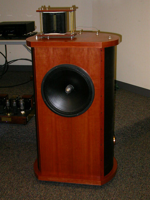

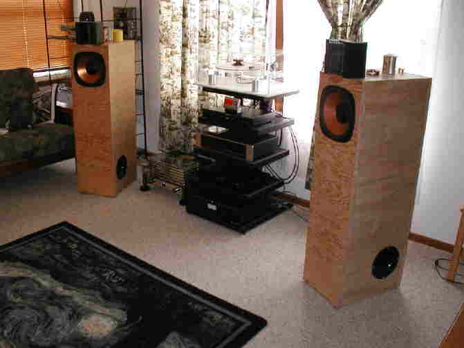

Hi dshortt9,
they look great - one in the eye for the small footprint brigade.
Is that a port on the side or a passive radiator?
I was going to bid on a pair of 12" Klips here in Europe but they went for a pretty penny.
Are you using a passive or active x/over? Anyway I'd like to hear them.
Have you considered removing the Heils from any possible woofer cabinet vibration, or is there any vibration coming from your cabs.?
There are 2 4" ports, one on each side. One 10" woof on front and one on the rear. I am using a passive series crossover, just one cap and inductor. This contributes to the excellent performance. Higher order parallel crossovers can work but are much harder to design and IMHO can arguably degrade performance. Maybe I am just going through a phase of minimalism. I like to keep it simple as possible. The drivers seem to match well since the woofs were meant to be used with a horn they are fast enough to keep up with the ribbon. The series crossover is easy since it is very flexible - regardless of the values used they will mesh the drivers well. I calculated the original values and tweaked them by ear. No boom or overhang, very articulate. can seperate 2 basses playing with no problem.
The fronts are 1" plywood and have no vibration to speak of, especially on the edge. The Heil's weigh 12 pounds so are not easily shaken anyway. They go down to an honest 32 hz and will startle you with transients like the 1812 Overature has. I literally jump at times. Always available for an audition.

Hi dshortt9,
you can never go wrong keeping it simple. Using the Klipsch woofers is exactly right - as you say they keep up with the Heils.
I'd love to hear your speakers but Andalucia to Wisconsin is some trip.
Active x/overs - take a look at Rod Elliot's, Elliots Sound Products site & TNT-Audio for the articles on active x/overs. Until I read Rod's take on it, I just did'nt realise how much of an amp's power is dissipated in heating up the components in a passive x/over.
I've bought a Berhinger to start with but I can see a valve active x/over in the pipeline.
