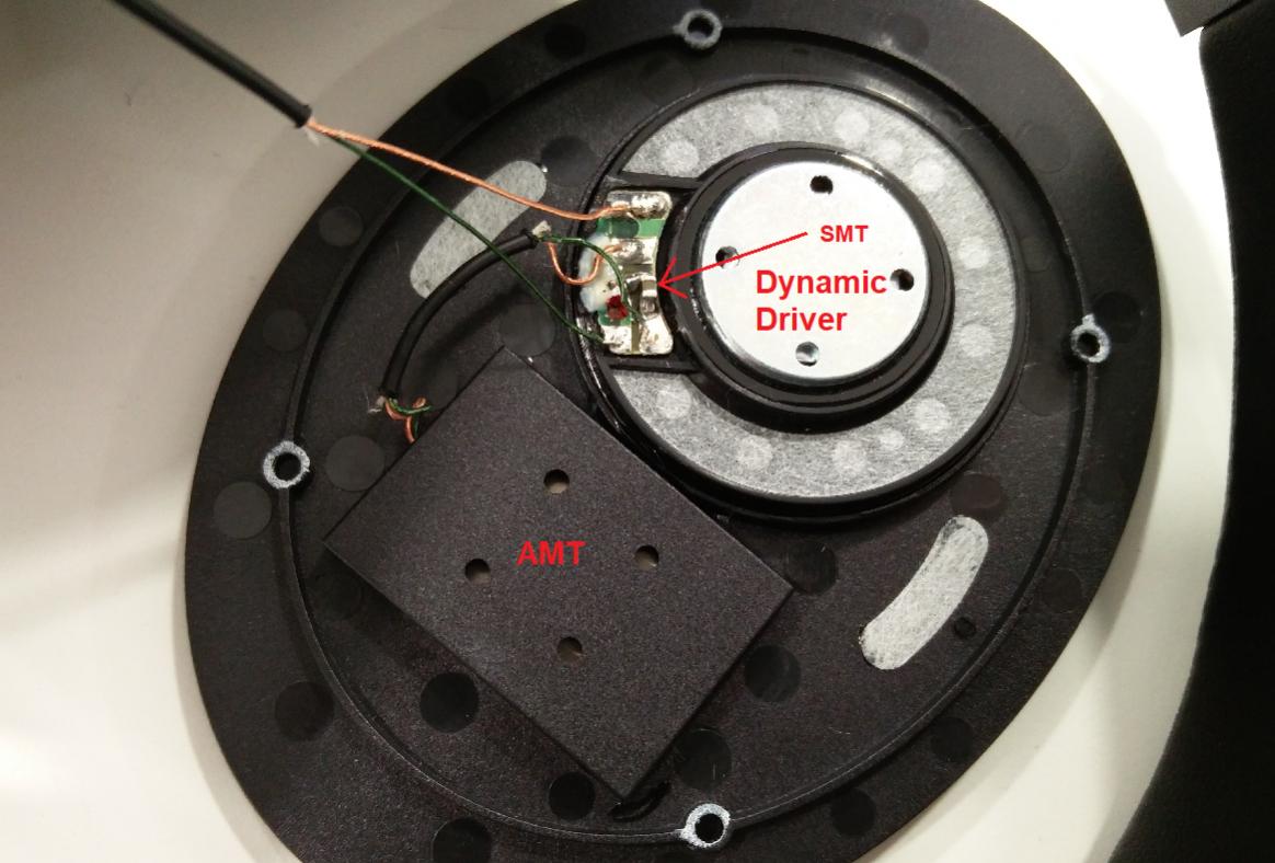

Here’s a sneak look at the insides from a Head-Fi post:
I see a single SMT cap as a high pass filter for the AMT and the dynamic driver runs full range.

Good afternoon everybody. Sorry for rebumping this sleeping thread, but I could just manage to buy a pair of NOS ESS 422H. When I learned about their short-lived existence, they were discontinued already, so I had to wait for a NOS unit to surface.
Frankly, after reading so many mixed reviews, I knew beforehand that they were not going to play any good, and indeed they don't, but my desire to own a pair of headphones with an AMT prevailed. The lack of trebles is so abysmal that I wonder how is it possible that such a product had been marketed at all by an experienced brand such as the one in question. I have tried most of the suggestions given in this thread, but to no or only partial avail:
1) reversing the headphone chassis - this actually caused further loss of trebles in my case;
2) inverting the AMT polarity - wether this had any percievable effect, the jury is still out; for sure it didn't "solve" the issue altogether;
3) adding a resistor in series with the dynamic speaker.
Tweak 3 had a clear and obvious effect on the sound, but unfortunately very far from fully balancing the trebles. I then tried to increase the suggested 10 Ohms, but when I got around 30 Ohms there still was lack of trebles but on the other hand the sound begun to get noticeably unbalanced between left and right channel. Uncreasing the resistor value even further seemed to have no longer any effect with the bass/treble ratio (which I fail to understand why, I have to admit) but further worsened the balance between L and R channels.
Did anyone made further tweakings to these headphones? I have in mind to try different voltage dividers in place of the simple series resistor and see what happens, but honestly I'm quite discouraged. If someone succeeded in rebalancing the sound of these headphones somehow, I'm... "all ears". 😉

Mine did not lack treble. I wonder what the issue is with yours? You might look at replacing the high pass cap with a quality film cap vs the (ceramic SMT?) that came stock.

I should do an impedance sweep of my headphones using DATS to see what kind of an amp this needs to drive it and if others with a version that lacks treble can also do a sweep. If the high pass filter was changed it would show up.
Looking at post 1 there is a single SMT cap for the high pass filter. I would bet changing this to an appropriate MKP film cap will do wonders.
I never took mine apart but now remote to and will swap the SMT for a film cap. Looking at the size of that cap, it’s probably no more than 1uF X7R ceramic. X7R is terrible for audio path signals.

Mine is exactly as the one in picture, and it lacks trebles tremendously. The reason why I insist with it rather than simply trashing the headphone, is that the bass is instead excellent. If only I could rebalance the trebles, it may very well rank among my favourite headphones.
I haven't changed the capacitor so far as the lack of trebles is so abysmal that I doubt that a better quality capacitor could fix the issue: there are better or worse capactiors for each application of course, but none that can do miracles. If anyone who has experimented with the cap may suggest an appropriate value, I'll try to change it, although I can very hardly foresee any radical improvement.

Before you continue the repair, I suggest getting an Apple Type C to 3.5mm dongle, model A2049 specifically for $5-10.
I suspect the output impedance of your sources may be responsible for poor treble performance.
The dongle has less than 1ohm of measured impedance and outputs ~30mW@32ohm which is plentiful for this high sensitivity headphone.
