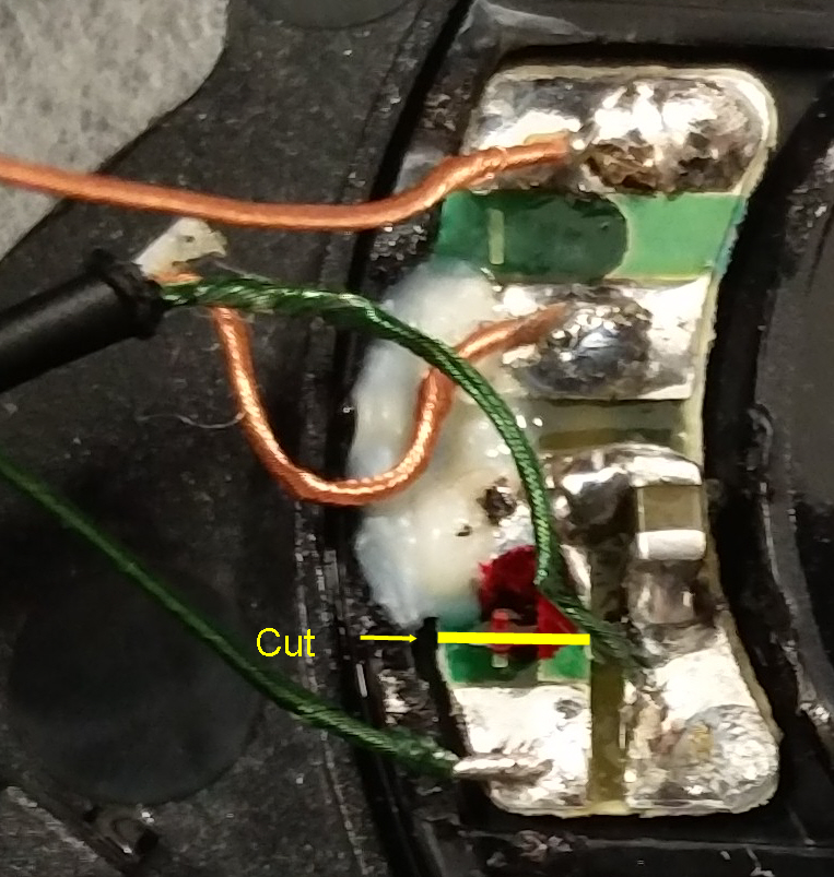

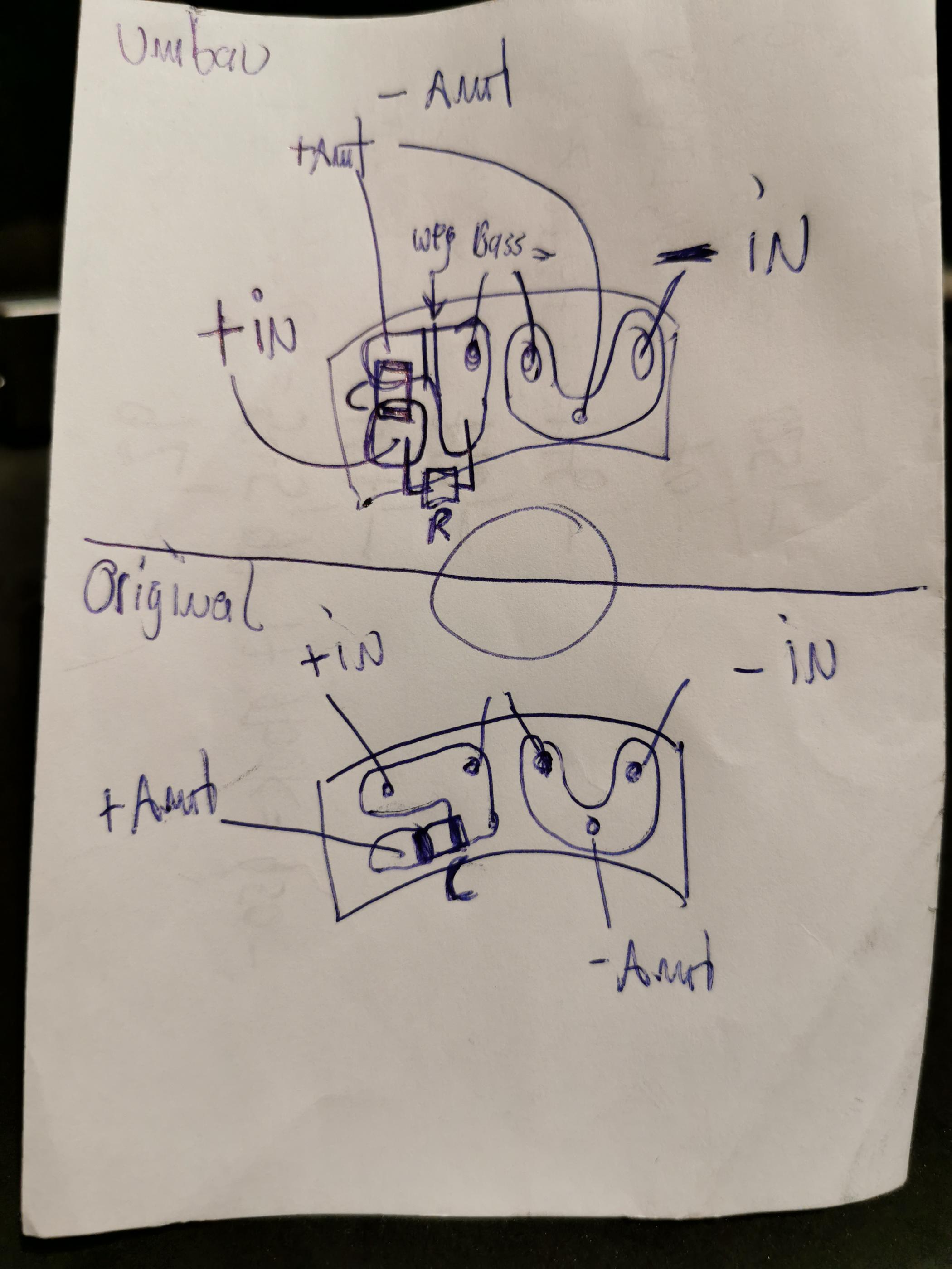

Yesterday I found the Time to open up the ESS422H and tried a mod for less bass.
The Dynamic Driver has 27 Ohm and the AMT has a capacitor with 10µF in line with +.
I changed the Layout of the Little Board on the Dynamic Driver.
At first i made a cut, see the attached Picture.
Then I changed the capacitor Location and insert a 10 Ohm resistor instead.
The capacitor went to an other Position and the + in and the +AMT cables have to be changed.
I hope you see it on the second attached Picture.
On the top you see the changed layout and on the Bottom you see the Standard layout.
I tried some resistor values, and the 10 Ohm Version was the best in my eyes.
The bass is always good (like in the DT990 i think) but much less than before.
The treble and bass are at the same Level now and it sounds much better then before.

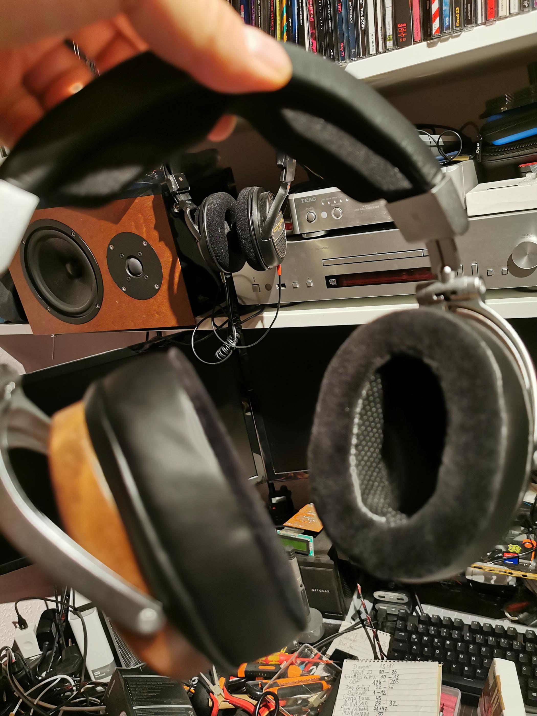

Btw. I ordered these cushions from Ebay, they Sound and feel good:

Yes they are, I got my second pair of cushions yesterday and installed them on the ESS422H and together with the 10 Ohm Resistor they Sound great.
And the cushions feel very comfortable, because they are very thick and soft, more comfortable then the sure ones I also own.
The leather is the same material like the headband is, so it looks original.
Two weeks ago i testet the cushions before I added the resistor.
I ordered the cushions for my Sony MDR-ZX770BN and when I saw that they fit on the ESS I ordered another pair for them.
