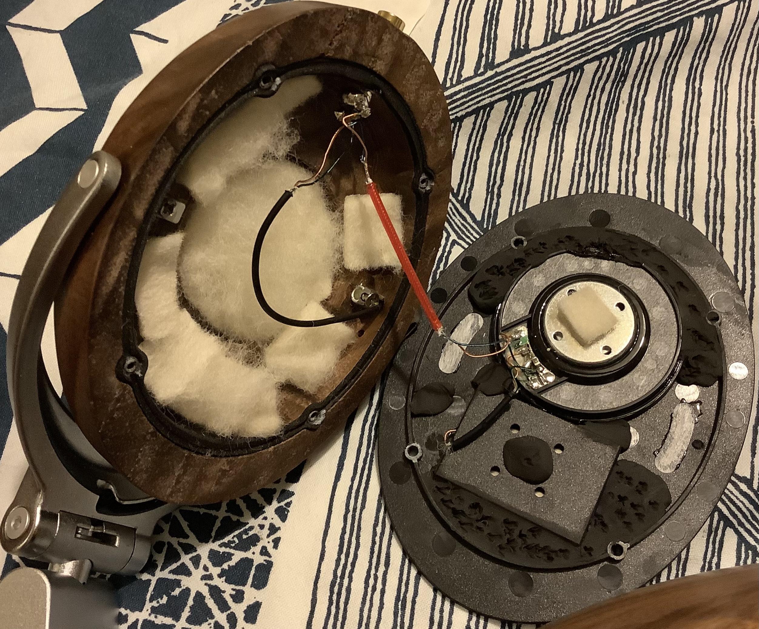

So time to mod . Unfortunately my replacement pads seem to be on the slow boat from China so in the meantime I have used a bit of 2mm wool felt teased out on the cups and put some Newplast on the baffle perhaps I may add a little more later .
It hasn’t dramatically changed the sound signature but I am fairly sure that bass has more punch and is cleaner sounding .

Hi there! Thanks for posting this mods! I just received a pair and put them to burn in. I am curious how do you dismantle these cans? can you post some pics and some instructions? I want to change pads and they seem to fit very well into the cans. I do not want to break actual pads and I am afraid how will I put new pads onto them... sry for this stupid request...
The pads just need to be pulled off gently. There is a rubber band around the edge, you can carefully remove it with a toothpick. I have the Shure earpads installed and they do not need the rubber bands.
removing looks easy... but what scares me is putting new pad into this small gap... I ordered brainwavz ovals. Will be replacing after arrival
When you remove the rubber band, the gap is actually large enough. I have read in a review, that the rubber bands are there because the original pads have a loose fit - and I can confirm that. Installing the new pads was prety easy.
Thank you. I inspected the whole thing once more and I discovered this ruber band fitted nicely into the into the slot on the edge - I removed this band now I can see it is so easy. Sorry for troubling you!

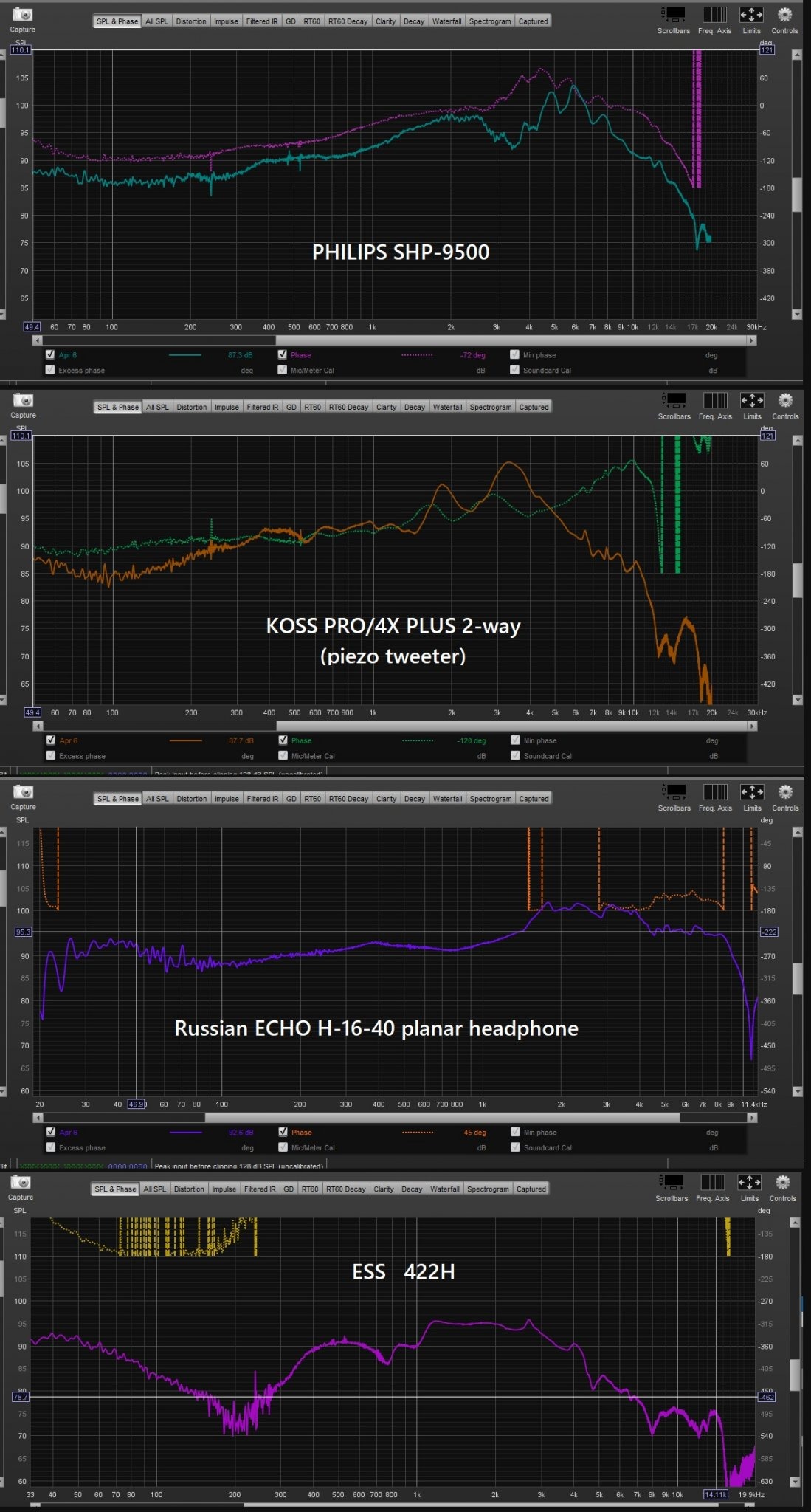

quick and dirty measurements with Dayton mic and a comforter and notebook separating the two cups - - cups faced down at the comforter - no real seal - but the little ECHO was interesting.
