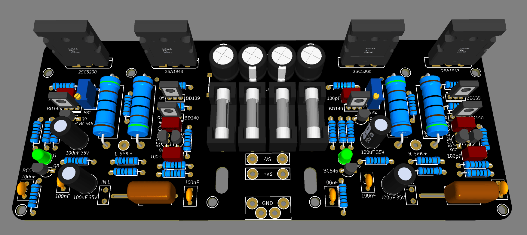

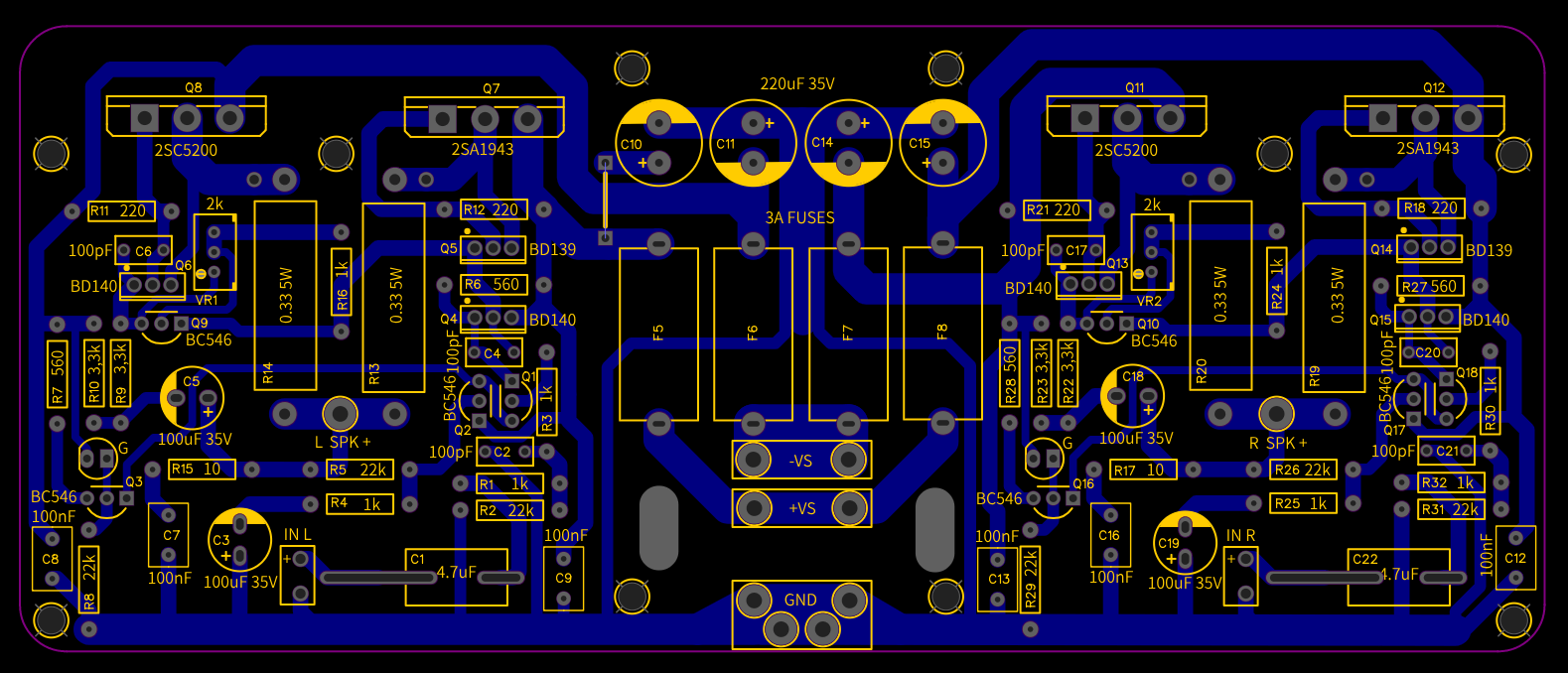

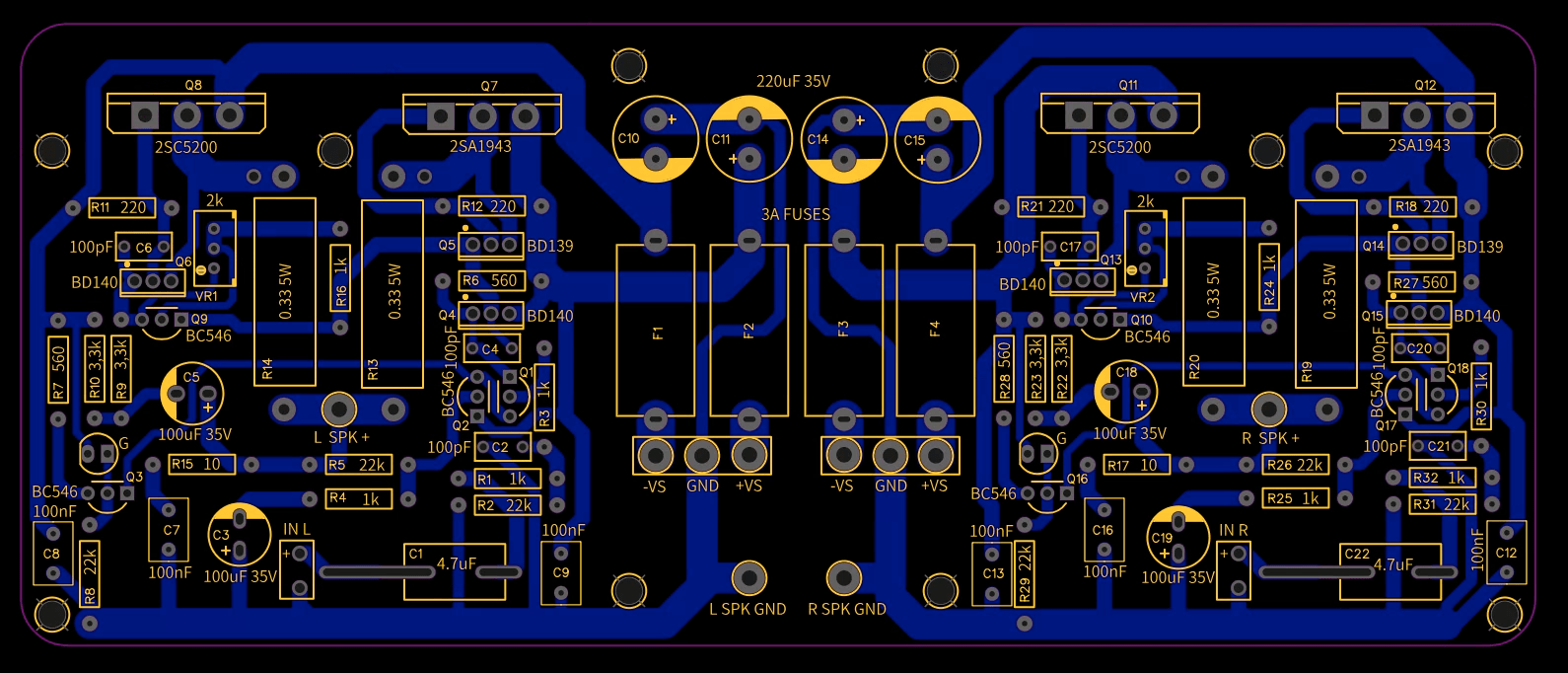

More space for bigger input Caps, better footprints for BC546, added probe points for Bias adjust.
Gerber files attached.
