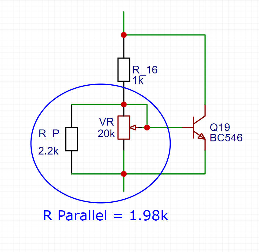

I've been wondering if a 20k would do the job as well...
You might try to put a fixed resistor in parallel.Didn't tested it yet, I don't have any 2k Multiturn Pot 🙁
Look here.
Yes that would do the trick!You might try to put a fixed resistor in parallel.

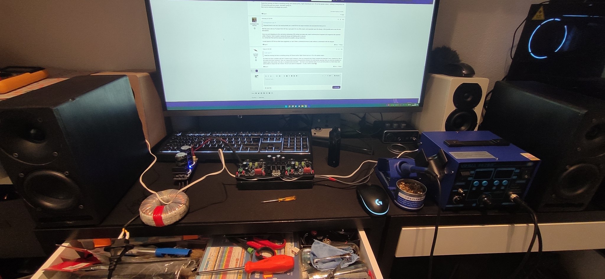

Up and running ✌️
After 1 hour listening, I can say it's really good, one thing is missing though... bass!
Used a 3.3uF C1 input cap instead of 4.7uF but I don't think that's the problem.
How good at reproducing bass, are the speakers (the black boxes, I guess?) that you are using for the test - assuming you do have a reference amplifier that doesn't have any form of bass boost either, for the purpose of fair comparison.
@Ian Finch @jacques antoine those little black boxes are terrific at bass response, they can easily reach 40Hz... Reference amp:

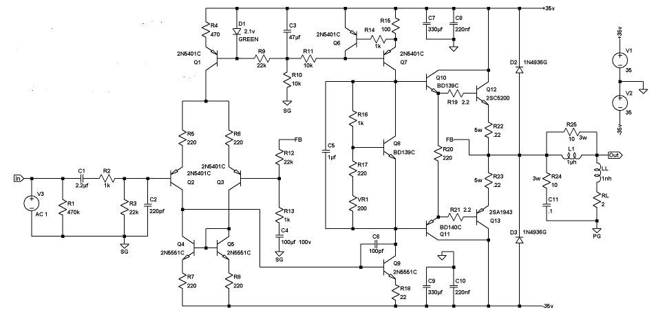

Do you have any 2N5551 lying around? Same pinout, higher voltage.
Not exactly same pinout.
EBC vs CBE. Easy to make mistake when soldering them.
I'd like to see the relevant datasheets for CBE 2N5551 type in a TO92 package. Every basic type I searched from Motorola/Fairchild/Onsemi to NXP and others, comes up EBC. Note the transistor outline/pinout sketches may not be generated by the same graphic projection method (i.e. 1st angle V 3rd angle method) so the leads could appear to be in the same arrangement when they are not.
