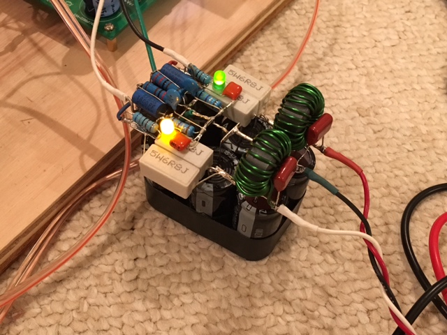

Those were all the recommendations I gave which you implemented here, why are they removed and then put back in again?
Note, it's also very easy to make these point-to-point in free space, or point to point on perf board. Here is a very compact DX PSU based CRCLC PSU with diode bridge (buried on back end):
Compared to how big a Dx PSU can get when made on a relaxed perf board:

first components mounted
show us the underside - we want to see your soldering skills 😀
The ground lug needs more space - can you move that blue box cap to the underside ? better still, drill another hole in the copper ground bus and move the lug sideways a few mm for clearance.
