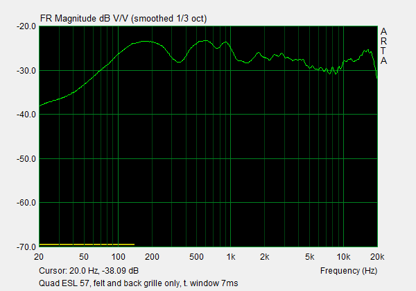

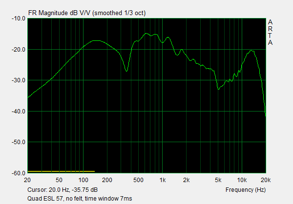

Recently I have measured Quad 57 original speaker(not rebuilt, but not too bad) in three configurations:
1) No damping felt, no front grille
2) Damping behind treble unit, no front grille
3) Damping felt & back grille with its own damping pads, no front grille
Some quite important conclusions can be made :
a) There is a large peak in frequency response without damping felt peaked at ~650 Hz. This can be attributed to resonance of treble unit. Where from is the idea floating around that its resonance is supersonic ?!
b) Added damping on the back significantly influences frequency response of this speaker, making it a lot more linear.

The HF peak is at 15 kHz, it is determined by the diaphragm thickness. But what is the dip at 350 Hz? Some phase cancellation of the bass and treble panels at the measuring distance?
I measured mines at 3m, using a pink noise generator and an Leq meter with 1/3 octave filter. It gives more realistic curve (closer to what you hear when listening to music).
The peak at 15Khz is most likely caused by the resonance of the tranrformer from its leakage inductance and the total capacitance of the panel and the transformer self capacitance.
Its common that this resonance can occur in this range and is normally damped by using series resistor in the primary side of the transformer.
To test this you can add a small bit of capacitance to the panel by paralleling it to the panel and see if this peak shifts down in frequency.
Just make that your added capacitor can handle the voltage.
A piece spare piece of double sided PCB may work nicely for this test.
As for the dip at 350Hz this could be caused by room reflections.
Check for any distances that correspond to a wavelengths of this frequency.
I get a similar dip at around 250hz at a spot in my room (in the corner above the cabinets) and I determined that it was caused by the distance from the top of cabinet to the ceiling as it is approximately 4.5' to 5.5' or so.
jer 🙂
I have used windowed measurements at 7ms and mic distance of ~1m.
Bass frequency response should be taken with a grain of salt, as room will have some influence despite it's a dipole speaker.
My interpretation of the dip at 350 that its just because the frequency is right between two resonances : bass panel centered at ~95Hz and mid/treble panel at ~620 Hz. My DIY speaker does not show similar effects but its much taller(and narrower) than quads.
The rise of treble could be attributed to both transformer resonance and maybe even more important increasing beaming of the treble unit which has a center strip about 50mm wide.

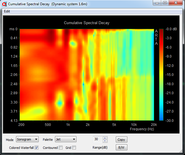

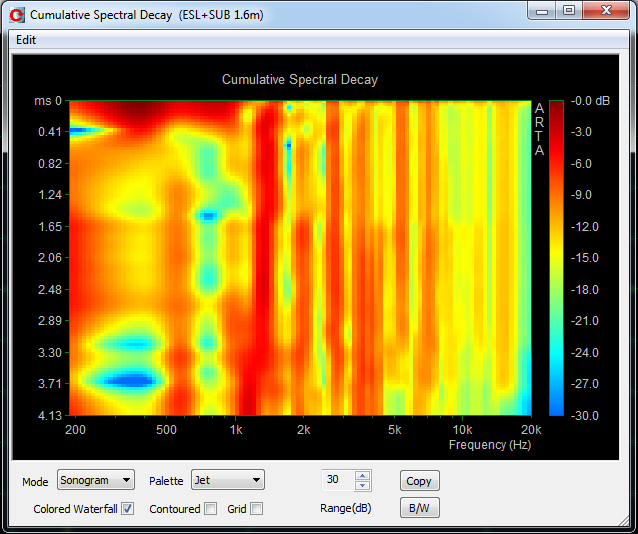

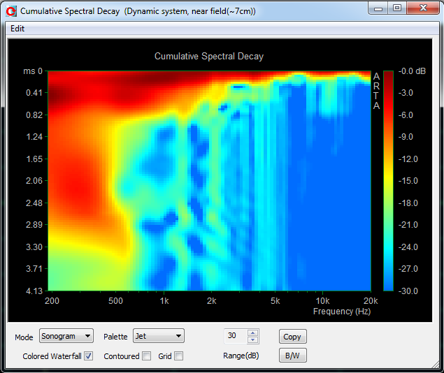

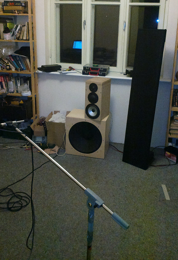

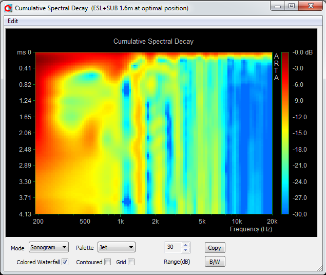

Dynamic vs cone sonograms
Today I have run some experiments comparing dynamic system to an esl.
My main question is how do these behave in a typical living room. Mine is 3.6x3x2.8(h)m.
Systems under comparison :
ESL is a DIY segmented element having radiating area of 24x145cm.
Dynamic system: AL170(visaton)+Dayton RS-52AN(dayton)+KE25SC(visaton), box sealed and stuffed with fiberglass.
In both cases active crossovers were used implemented via miniDSP.
The run :
1) ESL element at compromised position(close to the wall , but at an angle), near field
2) ESL element at compromised position(close to the wall , but at an angle), at about 1.6m
3) ESL element at good position(far from back wall), around 1.6m
4) Dynamic system next to the ESL, near field
5) Dynamic system next to the ESL, 1.6m
Plots were calculated using FFT length=256 samples, 100FFT blocks max.
So, my conclusions :
a) ESL element shows more reflections at higher frequencies if placed close to a wall.
b) ESL system has degraded performance between near and far field measurement
c) Dynamic system shows very degraded performance in far field compared to near field , f < ~2kHz.
So maybe it's the dipole action and large radiating area is what makes ELS so special ? 🙂.
Any one has performed similar tests or maybe has an interest to do so?
Lukas.
