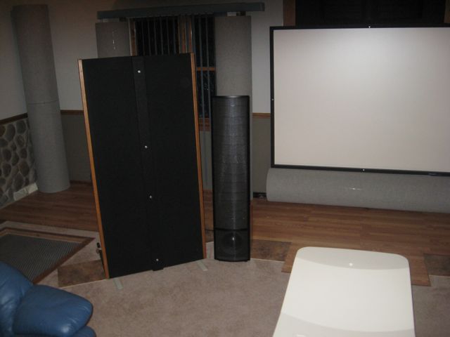

I am also rethinking my entire build. I currently have 16X48 panels with perforated steel stators. I was hoping to augment the LF response with panels of similar construction. My main panels sound fine, but they are beamy as hell in the high end, and there is only one spot I can sit that lets me hear everything. I am crossing at 200 Hz using 24 dB per octave Linkwitz-Reily filters. I would liked to have gotten another 2 octaves (50 Hz) with ESL panels.
SDStokes mentioned in his first reply (#21) using wire stators and "mechanically" EQing the panels using resistors. The more I think about this, the more I think I want to try it.
When you think about it, a wire stator panel is a big array of small value capacitors. Putting a resistance on an individual wire will result in a low-pass response within that area of capacitance. It strikes me that at the very least, we can taper the HF response over the width of the panel, and thus control the HF dispersion.
If we make the panel big enough, we can get pretty decent response in the low end as well. If I could get response to 50 Hz before I cross into my subs, I will be a happy camper.

Check Out the cores from Alpha core !
It would be very cost effective to wind a custom transformer.
Start with a very large core in the 2000 to 3000 watt range this would get a good low frequency handling.
Also a core this size will have enough room for thick insulating between the layers in order to keep the stray capacitance to a minimum.
A core this size won't require as many turns either on the primary possibly keeping the secondary to only one layer or two depending on your chosen turns ratio.
This would be much cheaper than the custom wound ones from over sea's.
Yes,it would be tedious,But it is DIY and a larger core will also be easier to handle and wind, except for the weight.
This is something I plan on doing sometime if I decide to build some larger panels just for the low frequency's.
Cores that size are in the $25 to $65 range from Alpha Core.
They do have custom winding available as well but I have not inquired about their services yet.
Right now I have plenty of 200watt cores to mess with and I am planning on stripping one or two stacked and giving it a try myself.
A very large core and a 1000' spool of some kynar covered 30 Ga. (wire wrap ) wire seems like a very viable alternative of around $100 for two complete transformers.

I ve got some of the 39 pound Dayton Wright ESL step up transformers with 80,000 ohm secondary coming up for sale soon if you want some real ESL iron.😱

My only concern is the voltage breakdown between windings when the bias is pushed up.
Right now I am using about 8kv to 10kv.
My supply can do 13.8kv but I am experiencing leakage some where in the panel or the transformer as the most I am getting with the supply full on is slightly above 10kv and there seems to be a considerable amount of current draw but no arcing.
This is of importance because a large bass panel with a large D/S will require these types of operating voltages.

Combining ESL with Maggie bass
Combining Martin Logan Summits with Magneplanar Tympani IV bass
panels is what I put together. Provides great bass to 25 hz with
outstanding transient response. Below 25 hz is handled by a rotary
subwoofer and all three together are coherent and give me all the output
that I need.
that I need.
