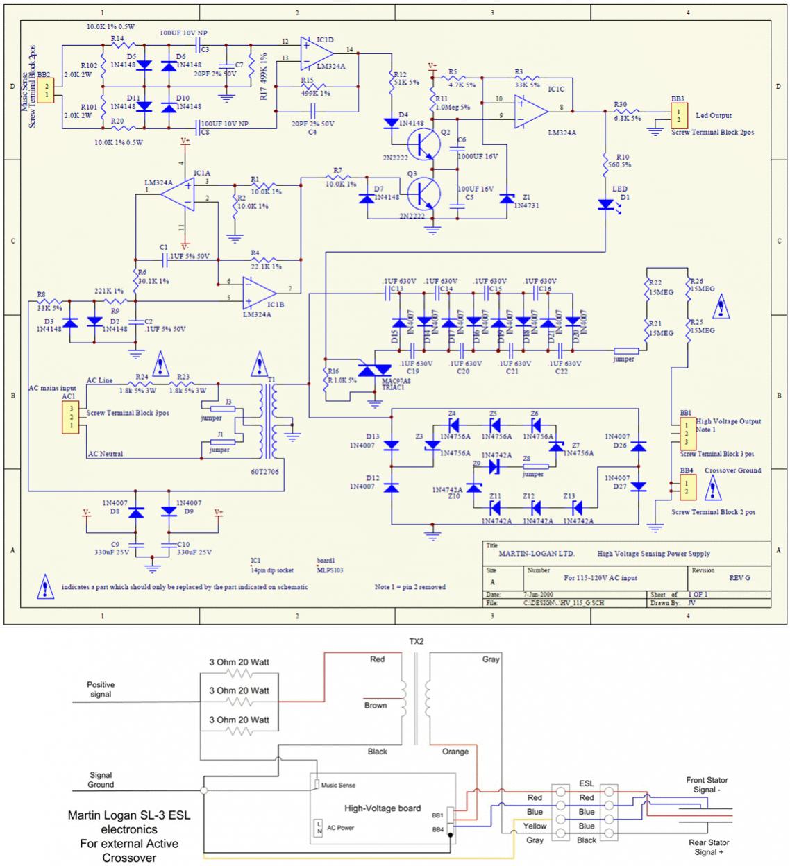

Where is the other terminal of the bias supply connected to?
Were it should be ...it a bias... it stans on it own....who that would like to get the best sound thay could ...would wont to put one side of a bias tranfourmer AC winding that in the Acoustats would be 750v AC....Now if the earth is there with all it noise... it would on paper be 0...not what i call hi end sound but will work....let the bias be on it own.... sounds best
I understand you prefer to not connect the earth ground from the mains power to the bias supply.
That was not my question.
The bias supply still needs to be connected somehow to the stators, or the diaphragm won't charge up since it is in reality one plate of a capacitor with the stators being the other plate. I was wondering if ML retained the bias supply connection to the center tap, or moved it to the front stator along with the audio input ground reference. After rummaging around on the ML forum for a while I found the attached diagrams where you can see that the bias supply ground is connected to the front stator thru connector BB4 rather than the center-tap.

Hello Tyu,
Um...there must be something lost in translation here...
I wasn't disagreeing with your posts about ML moving the ground reference from the center tap to the front stator.
I was only trying to determine how they connected the bias supply since I could not figure it out from your comments or diagrahm in post#19
There is no right or wrong here. ML did what they did.
I've been listening to, building, and repairing ESLs for almost 20 years now and I find there are always new things to learn.

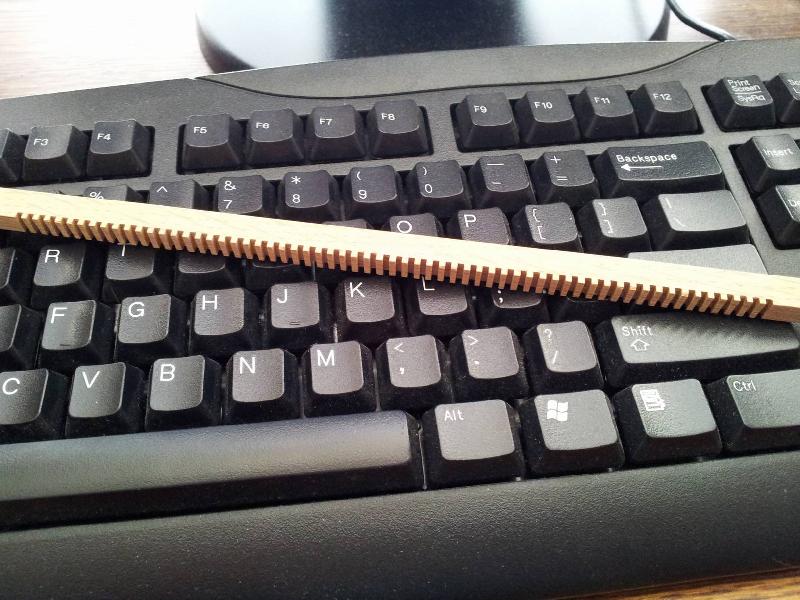

Sheldon-
Years ago, I visited the Gibson guitar factory. They have a saw that cuts the kerfs for the frets in the fingerboard in one pass. A lot of very thin blades were spaced on a single arbor at appropriate spacings.
I can cut dados up to about 1" wide with my old table saw. A number of blades spaced correctly could do 8 or so slots in a pass. They do make very thin blades for plywood and plastics- just need to find 'em. Makita makes them, but the arbor hole is small. When I find the blades, I'll let everyone know.

How are you planning on cutting the guide channels for the stator wires on your spacers? I have an idea forming, but I need to try it in the shop.
My very first wire ESL project involved 8" wide panels built with 14 gauge wire. I figured slotted crossbars would be the way to go. So, having access to a table saw I went looking for a blade of proper thickness. I finally found one...cut slots just a hair over 1/16" wide.
Rather than cutting slots in already dimensioned crossbars, I cut slots down the length of the crossbar material. Then when all the slots had been made, I could cut the cross bars to width. I chose to use 50% open area to make incrementing the rip fence easier. Also, I cut an even number of slots(62) working from the middle out in a symmetric fashion so I could cut two slots for each setting of the rip fence by flipping the board around 180 degrees.
Attached is a pic of one of the leftovers I kept as a souvenir.
