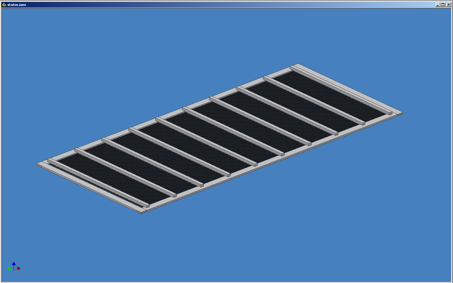

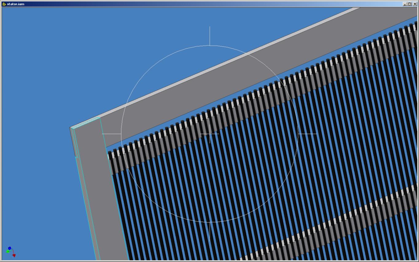

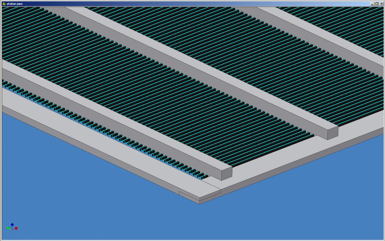

Perhaps you will share your ideas for building a wire frame? I tried to build one many years ago ala Roger Sanders and it was a build nightmare, ultimately not ever working.
I'm planning to use 14 gauge solid core conduit wire that I straighten on a jig. I'm building the rest of the frames with lexan. Here's my first cut at CAD models.
Here is a link to a thread from last year that includes some good information on building wire stators.
It's fairly short, but has some attached project files, and several links to other postings with information on wire stretching, gluing, and the like.
http://www.diyaudio.com/forums/plan...-esl-project-file-translated.html#post2241752

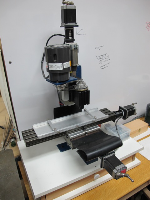

How are you planning on cutting the guide channels for the stator wires on your spacers? I have an idea forming, but I need to try it in the shop. If I have any fingers left, I'll let you all know.
BTW, I'm not trying go get subwoofer response with my project. (elctrostatic walls anyone?)
