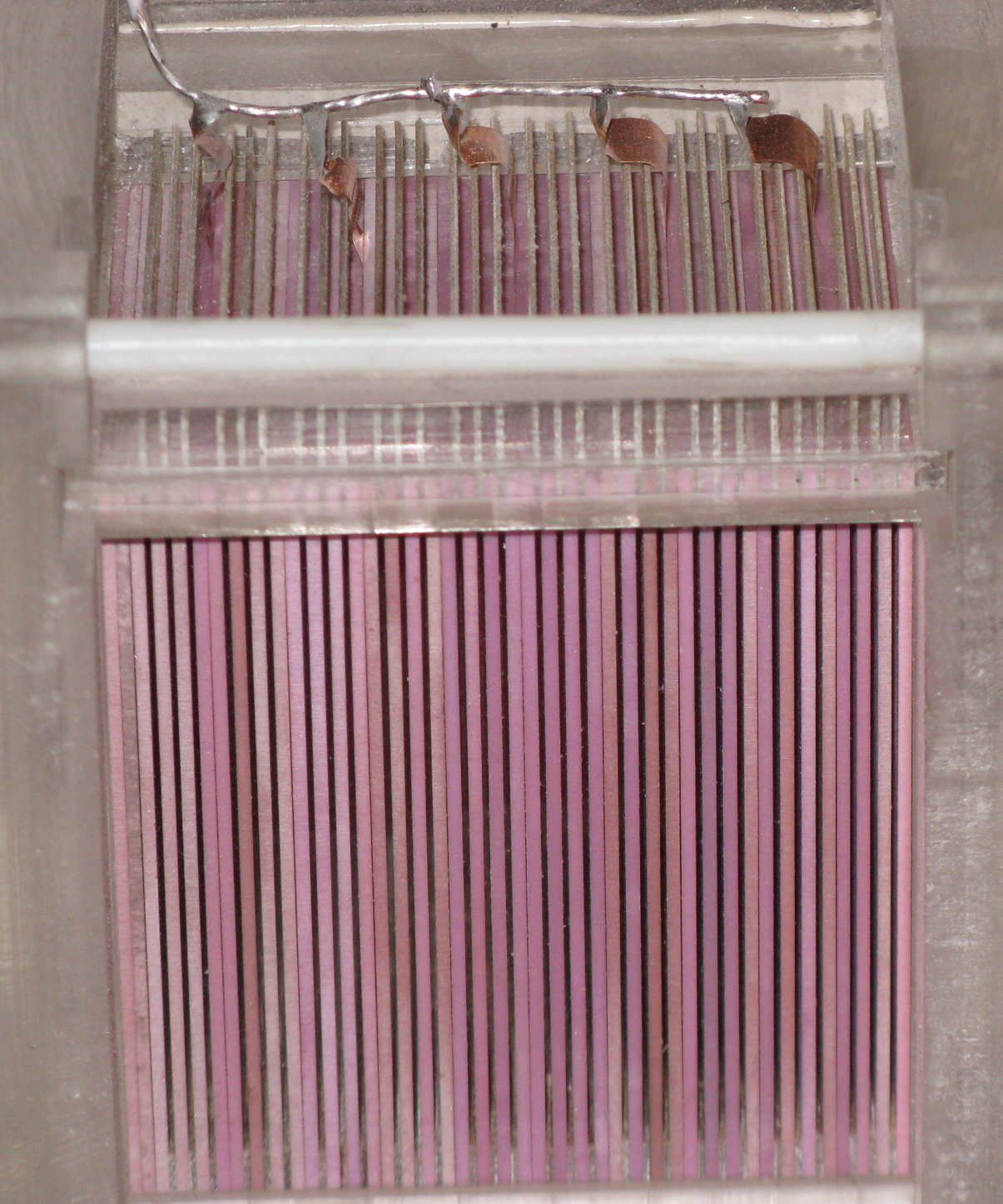

Attached pic shows high % open area mesh used as grounded safety shields on some models of King Sound ESLs.
Concerning HV bias contact corrsion:
Back when I was building stacks of test panels and Licron didn't exist, I come up with the following solution. I applied coating to the diaphragm leaving a 1/8" border inside the spacers. Copper tape was run around the panel in the middle of the spacers. Patches of Dag graphite were painted on to join the copper contact strip and coating.
This minimized leakage currents across spacers in humid conditions and avoided any possibility of corrosion. One of my favorite coatings at the time was Ivory dishwashing liquid soap thinned 1:3 with water and air-brushed on. Even that has shown no corrosion tendencies with the graphite after 15+ years.
Very slick! And the original soap coating has lasted 15+ years?
Yup, I still have a few panels from the "early years" still playing with original soap coating.
I don't recall ever having problems with deterioration in the conductivity of soap coatings, but experienced many cases of contact corrosion leading to loss of bias charge.
At the time, soap provided a nice cheap way to get a high resistance uniform coating. It was much easier to deal with than rubbing graphite. However it has its own set of problems. It adds more mass than most other coatings, and remains slightly tacky so it tends to make vacuuming off dust more of a problem. It also changes resistance with humidity and, for whatever reason, is more prone to hissing/sizzling noises in high humidity/high bias setting situations.

Just adding to Geralds post:
One should take the HV specs with a grain of salt. Especially if test procedures remain uncertain. A quite common test for laquers is to coat a flat sheet of metal and test with either DC voltages or low frequency AC of 50 or 60Hz. This test procedure will give larger numbers than anyone could reach in praxis on a punched sheet metal stator. If the laquer is agitated well before painting wo degassing, chances are high that air bubbles/pinholes will develop.
Similar tests apply to wires. Apart from magnet wire most wires are highvoltage tested only for LF AC voltages. With increasing change rate of dV/dt, hence rising frequency, the flashover treshold sinks. You can find the effect also in datasheets of film caps, at least those of Wima film caps.
Regarding the issue of painting stator sheets with spray cans.
Just one advice: "Forget it!" You won't achieve the homogenity and surface smoothness and quality that You require. Spray coating is not a terribly efficient way of coating. Even spraying a flat sheet 20-30% of the paint, maybe more, is wasted and not deposited on the sheet. Painting a punched sheet with an openness of up to 50% wastes more paint than putting it to a good use -- way too costly with cans. If You want to pant wet, use a proper spray gun or roll the paint on.
Powder coating is much more efficient and offers a good base coat onto which one can add layers of wet painting for improving insulation and for optics.
