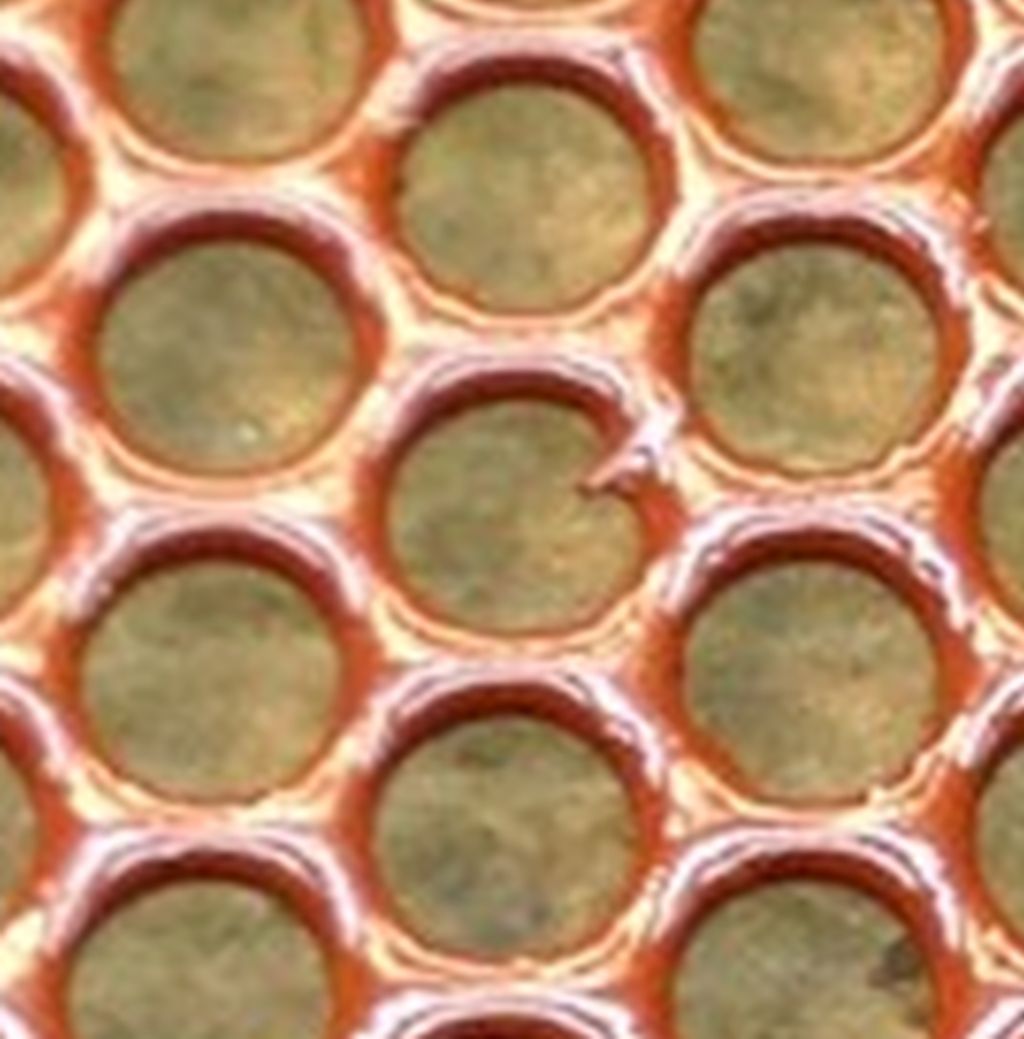

Syborg, in your second picture I noticed a sharp point in one of the holes.
It is areas like this that can and will wreck havoc on your newly built panel.
Especially when you start to crank it up.
You should consider removing this sharp point and then add some more coats to the coating.
Especially along the edges .
Even though you may have passed an arc test with your bias supply you will be applying well over 10KV to more than 20KV p-p across the stators on music peaks.
The high frequency ones are the ones most prone to cause punch thru of the stator coatings.
I was pushing 25KV P-P when my panel lit up like an arc welder on the side and finally on the edge on the inside from the very same bad spot that had been repaired before.
Burning the stator very badly.
Once it burns it leaves channels of carbon left behind buried in the coating and this is like little rivers that are just like exposed wires at a high voltage.
Very difficult to real seal once burned and usually requires completely stripping it down to the bare metal to reseal it as Charlie had mention.
Cheers !!
jer 🙂

Sheet with 6mm holes is not the best candidate if you are targeting uniform electrical field and good efficiency. 3-4mm should be much better.
Powder coating of just a single layer of polyester is almost equal to nothing in terms of insulation. However some people have had had success with multiple layers of powder coat made from different materials. Problem is that most of powder coaters won't accept to do this.
I do not know Plasti-kote but I can say that you should prepare for a difficult job if you want to make perforated sheets insulated well(>>8 kV or so) over it's entire area. You will need to round sharp edges of holes and spray many, many layers of paint. If you want to use canned stuff then prepare to buy loads of them. The problem with perf. stators are edges of each hole.
3) What is the best way of insulating the stators? I heard that powder coating isn't usually that successful as the holes in the sheet can get pretty small. I have used Plasti-kote before for various DIY stuff, would this be any good for stator covering?

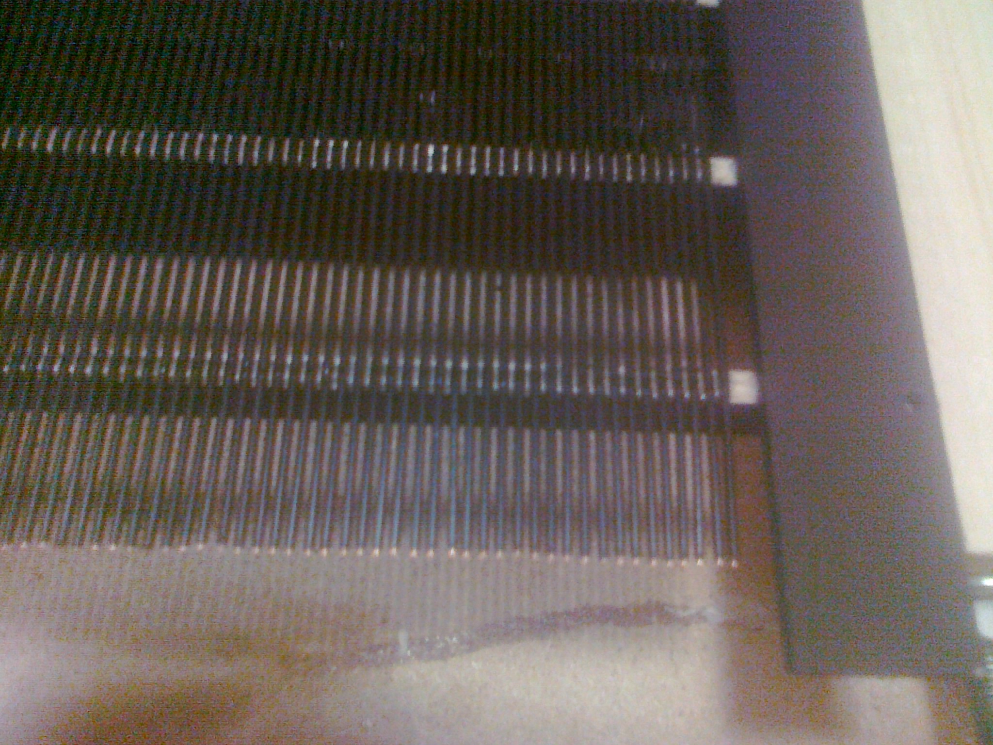

Thanks for the info and the link to the other thread (post 24). The wire method looks interesting as I can get hold of some enamel coated motor winding wire, which could work well. In the other thread they are using light louvres or egg crates to help hold the wire, so do the final panels have the louvres still attached, but obviously facing away from the centre where the mylar sheet is to allow for a close gap?
If you use a magnet wire be sure that you get the heaviest insulation build you can.
Even at that I am not sure how much it can withstand.
PVC coated wire is what is commonly used and is good for about 500v per mil.
I have always wanted to try some Kynar coated 30ga wire wrap wire and a few have claimed they used it with good results as well.
The plastic grid method is how the Acoustat's are made and is what inspired me to build my first panels only I used spray enamel on aluminium window screen for my stators and this worked very good.
I sealed the sharp cut edge with some clear silicone.
You must first be sure that the coating thickness is plenty becuase any later add coats do not bond to the silicone to create a good seal.
It was a just one sharp wire on the edge that wasn't buried deep enough in the silicone that started to leak and eventually gave me problem when I ventured past 7Kv of bias voltage and more than 20Kv p-p across the stators.

The wire you posted is double insulated with three wires inside. How do you plan to extract these wires for hundreds of meters?
I have used 0.5mm^2 wire with 0.6mm insulation. The threaded rods are 27mm in diameter each.
BTW I want to warn that if you plan to use plastic louvers it may not be easy to glue relatively thick wires to it reliably as gluing surface of plastic is very thin, and material is somewhat brittle. Acoustat used to dissolve the same louvre material in methylene chloride and use it as a glue with a viscosity like a thick syrup. I have tested this under DIY conditions and it seemed to work.
Later I have decided to make frames from other materials which accept many different glues and are stiffer.
Lukas.
Thanks again. I realise the link I posted has 3 cores inside of it, but by pulling the centre core (earth) back on itself it simply rips open the grey sheathing and you can take easily take out the other wires. Maybe 1mm^2 cable is too large anyway.
I like the idea of your jig, using a continuous wire wrapped round and around and making 2 stators at the same time. How much stretch did you put on the wire after you wound it? and how did you fix the ends after you separated it into 2 stators. Sorry for all of the questions, I want a good idea of what needs to be done before I start playing around.
If you can find single wire it would be a lot simpler to do so and there is no risk of accidentally damaging the insulation while pulling center conductor out of the 2nd layer.
I am not sure if H05 wire(I think its an EU standard) is available in UK but in LT it costs like 8 EUR/100m.
I do stretch stretch the wire to about 1-2% and then release to a point when they lose tension again. At this stage it is easy to see if there are still some small radius wrinkles in wires. If yes, stretch a bit more. If no, then stretch just enough to get them straight and then proceed to gluing to stators.
It is not a good idea to glue wires under high tension; combined force of them can be very high and will deform or even break supporting construction when removed from the jig.
After that there are 3 steps left:
1) Clean ends of each wire. It is a bit of a pain.
2) attach spacers at the ends(glue or otherwise)
3) Solder wires either together or with segmentation resistors
Sorry for poor quality photos but I do not have a better camera at this time.
Photo below is of not completed stator yet, after being removed from the jig.
Lukas.
Very neat. I was wondering whether this idea would work.....Building the stator using 1inch x 1/2 inch oak.
Putting two 4 foot lengths about 1 foot apart and then using pieces of the same oak glued (or joined using half cut joints) every 8 inches up the length to create a ladder. The wire would then be put onto the stators using a jig similar to the one you showed a couple of posts ago. Now instead of using glue to hold the wire in place, I was thinking that the 3m double sided foam tape could be laid over the top of the wires when the 'steps' of the ladder are. This would then act as the spacer when attaching the Mylar.
Would this work, or would putting foam tape every 8 inch create a kind of array of smaller panels with a higher lowest frequency response?
