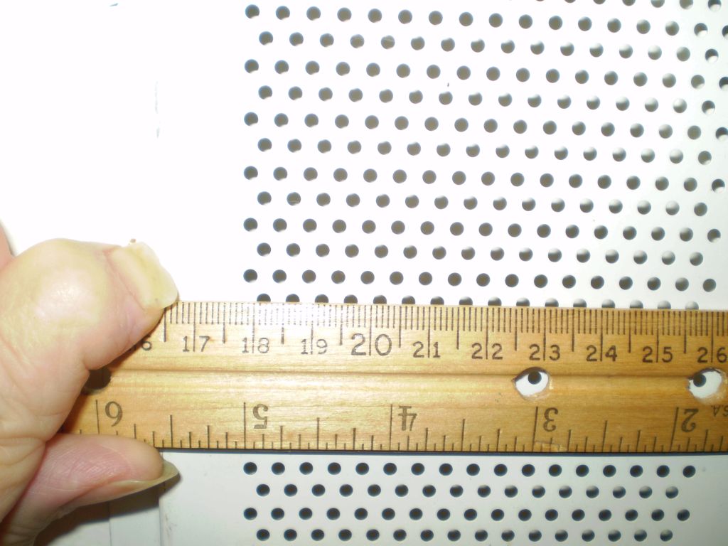

I agree that the perf metal shown in your photo has too little open area.
I would use either 40% or 51% open, with .125" diameter holes. I'm currently using 40% open perf, which I think is the lowest open area you should use.
Quad ESL 57 used considerably less than 40% open area, something like 20% or so.
The target is between 20-30% after insulating layer IMO. Lower open area can help in damping resonances and gives more field strength.
However I think holes are a bit too large in photos. It would suit an experiment perhaps.

The metal sheet in the picture looks like a RV5/8, which means "Rund, versetzt", round, staggered hole pattern of 5mm holes distanced at 8mm. This is kind of standard off of the shelf pattern. MartinLogan used a RV5/6 (or something very close in imperial measures).
I'd not use so big holes and so low opening, but on very large panels with high d/s value.
RV3/4 seems to be a very good compromise for metal sheets.

Here is a picture of the material I made my very first panels out of.
It has 2.5mm holes on 5mm centers and has a open area of about 22.7%.
By the time I got a good coating on them of about 10 mil or so my open area had dropped to 12%.
They worked but the sound was restricted quite a bit and didn't get very loud at all.
It was just too restrictive.
Then I made a identically sized panel using wire mesh and my open area was about 4X that of my first panel.
What a big difference it made as far as the quality and especially the sensitivity.
The third panel I made used an even better coating material (powder coating) and this allowed for on even greater open area and higher voltages as well.
What a difference this made!!!
Your material has bigger holes and this will help a great deal compared to what I used.
That was when I got the idea of trying wire mesh as this gave me higher concentration of holes per area while still giving me a large open area.
The thin wires allowed enough room for a decent thickness of insulative coating as well.
This also allowed for a more uniform highly concentrated static field across the panel than what larger holes would allow.
Not to mention the cost difference between the two materials as I couldn't afford metal panels at the time.
