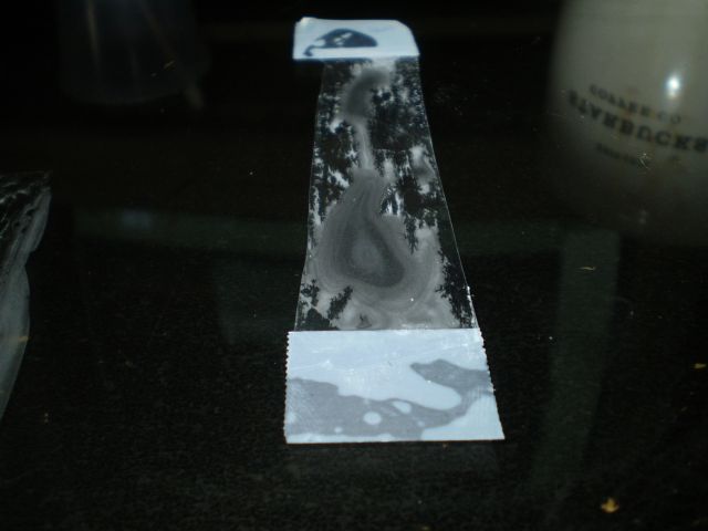

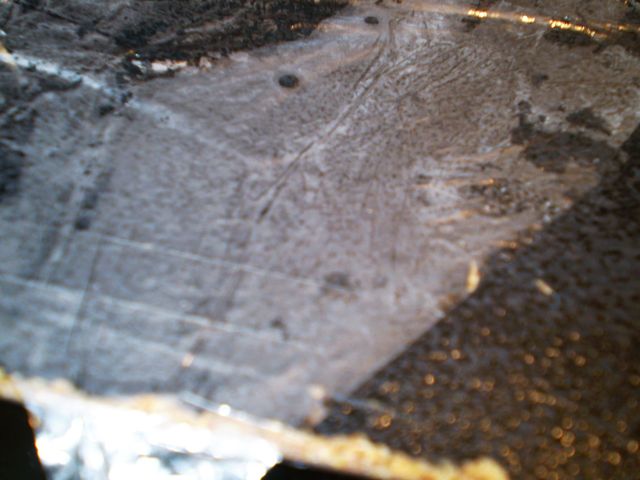

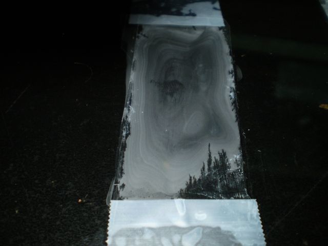

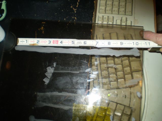

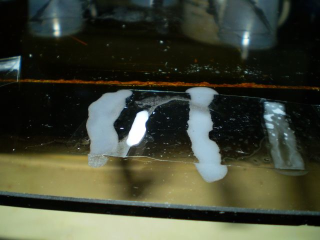

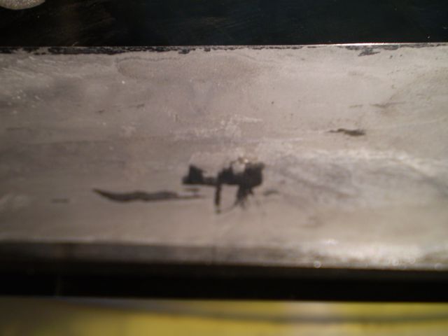

i have been messing around with the pva glue trick it seems to be a viable altrenative.i made several differnt test samples it seemed to adhere well to the polyester type material(and some mylar) i used.the scratch test seemed as good as if not better than licron.it took quite a bit of force to mark it,only in a couple of spots did it rub of probaly due to finger print oils on the surface as with coating mylar, extreme cleaning is a must.i used 1:5 ratio split in 3 plastic dixie cups 1#plain 2#printer-ink 3#powdered-graphite.for some reason the aditives caused wetting problems so i added 1 1/2 drops or so of dish soap(dawn) and it seemed to correct the wetting problem.since my vom won't read any thing greater than 2megohms i decided to add more graphite to cup#3 and ended up with a high resistive conductive paint adding more graphite cuased more wetting issues and a couple more drops of dawn solved the problem.curious about the wetting issue, i made a new batch .this time i used 1:8 ratio and split it in two cups in cup#2 i put in 2or3 drops of dawn and promlem solved (see pics).i was able to get coating thicknesses of about .15mil or less, .2mil to .3mil or so on a double coat. using mixture #3 after heavily doping with graphite for the conductive experiment i swabed up some .1mil mylar scrap and using two dimes spaced 1/8" apart i am measuring between 200k to 500k or more as mileage varies, with a coating thickness that is barley mesurable.i will keep experimenting until i come up with a final mixture and have a product that is consistent.so far it looks very promising.but first, i have to get or build a meter that will measure 100megohms or more. mean while i will still build a new diagphram and test it.i will keep everyone posted on any new findings.jer

Try to use wide and short piece of coating to ease the measurement.

Adding soap as wetting agent is not OK - soap stays and collects dust as well as rendering adhesion unreliable at least plus wet soap conducts electricity - you do not need to add carbon...
Try degrasing using washing soda (sodium carbonate) instead, 8 per cent solution should work fine.

Your PVA coating is way too thick. I coated mine very lightly and the diaphragm stayed transparent with just a little change in color. There is no way that a multimeter can measure the resistance. I once did a measurement using a high voltage resistance meter, and I got a reading of around 50 Giga ohms per square. I like using black ink much better than graphite powder because when on the shelf, the solution has no deposit at the bottom.
i yes i am aware and worried about using a soap as it was a very very small amount per liquid i used .any way im going to build a new frame and diagphram soon to try it.i am very impressed with the results i have so far.i have been using licron in the past and just wondered if anybody has used the new stuff it it supposed to be transparent.i ordered a sample and i hope they send it(for free) like the(orginal) last one.anyway i'll do some practice runs while i'm building some new spacer frames.yes i agree about the ink vs graphite issue.the ink i used is from a T0601 inkjet cartridge will that work? or should i high tail it to an art supply, if so what type and/or brand should i be looking for to use.jer
Jerald, if You need a lot of doping agent then there is something different with Your glue formula. Not every kind of PVA base material works! Instead of doping more and more You might try a different PVA. I gave the recipe which should work to Your confidence and only tiny drops of Ink are added.

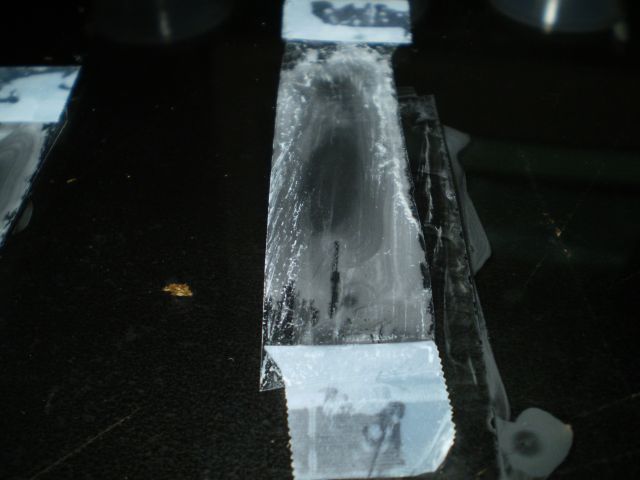

ha ha ha,don't worry it's glue.im not aware of any other types besides white glue such a tightbond and elmers.elmers is what i used.i have yet to find tesa brand localy.im still seaching and will try whatever i find.some say elmers is pva ,some say it's not and some say it is but with additives.how ever it seemed to work.after my last post i did another test on some cleaned mylar with the ink solution and i had the same issues.the solution would just contract it self into a ball as in pic #5 .but buy using just enough dawn to coat an 1/8" of the tip of a toothpick was enough to cause it to form droplets on the surface of it's self.at that point i swabbed the mylar as lite as i could with a cotton q-tip swab and let it dry.i finaly rendered a coating i had problems measuring the thickness of(yeah!). so now i'm in the in the process of rebuilding my tiny driver(pics on materials for esl thread) and luckly a managed to get it apart without creasing the spacer frames.i'll keep you posted. jer p.s. it was just a quick test and wasn't strechted out on glass like it should have been.
