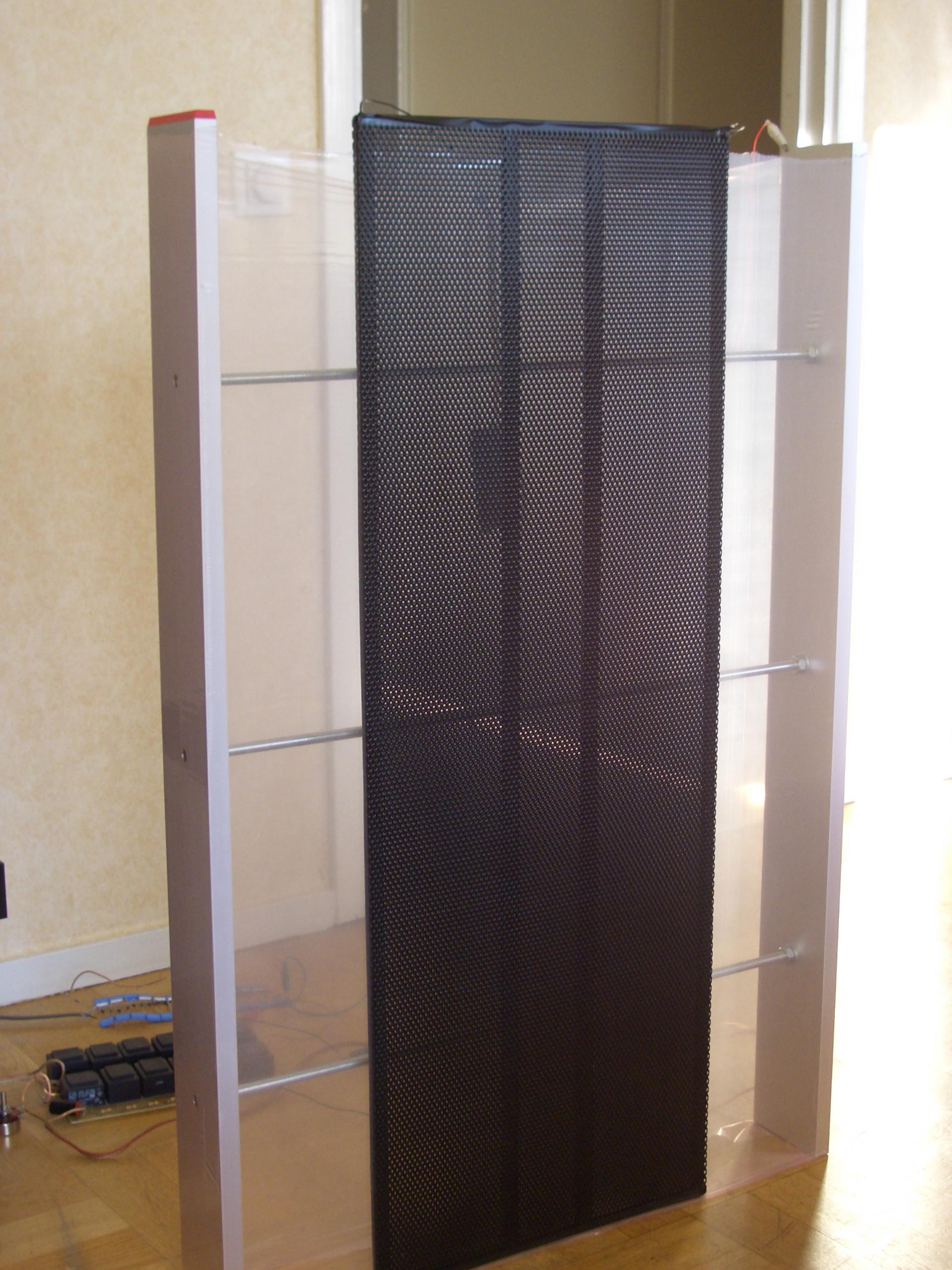

Hello,
I noticed the array of 12 small transformers on the floor behind your ESL.
Could you provide some details on these units?
What are the step up ratios, and how did you wired them up together.
Any problems with core saturation?
Thanks,
bolserst
Yes, they have their secondaries in series and primarys in parallell, 230/9volt which gives a step up to about 25 times and 300 times for the array.4.5 watts each and worked ok down to 50 Hz and up to 7-8kHz depending on the capacitive load.
