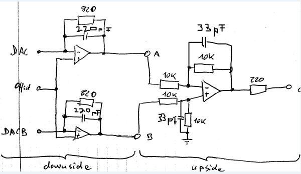

My understanding was that the best approach in SQ terms is to take the raw DAC output and feed it into an output stage, thus bypassing whatever output stage is built into the board, which means that SQ is then dependent on the implementation and design of the output stage.
There will be more than one design of output stage that will work well, different designs will have different pros and cons, I was hoping that people had tried various output stages with this board and could share their experiences. One thing I am wondering about is discrete vs op amp, many people swear by discrete output stages as being superior to opamps.
I'm just interested in exploring different options before making a decision as to what I will try to build and implement.
The way I see it, most of the effort should be put into the power supply and output stage, that way, the DAC board can be changed and all the effort and expense involved in creating the power supply and output stage isn't wasted.

@Ian - I don't know if anyone's mentioned this before, but seems to me that @opc's NTD1 project might be of interest to you as you're looking at discrete stages.
opc's NTD1 project
One drawback of his approach (at least as it seems to me) is his use of high voltage supplies and consequent high power dissipation. There are other ways to crack that particular nut which don't call for double-digit Watt dissipation.
opc's NTD1 project

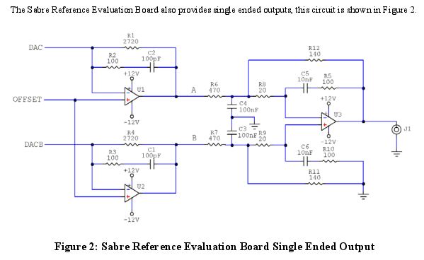

Mark put a lot of effort in trying to help you, but since you have made up your mind that you know better, this is what is going to happen to you....
ESS designers also put a lot of effort into testing and recommending circuits that will get the best out of their chips. I agree with Mark that those recommendations should at least be the starting point for design of the ancillary circuits that support their DAC designs. If you think you can do better, good luck.
Maybe you should check out what Twisted Pear is doing with I/V stages to understand better. They are known to have worked quite closely with ESS.
You need to educate yourself about the difference between current output dacs, and voltage output dacs and why a good I/V stage is so important for ESS dacs..

ESS doesn't specify a number for AVCC line noise. What they do is say the following:
AVCC:
"The choice of opamp varies for each design and budget. The power supply circuit shown in Figure 4 (opamp AVCC supply) is necessary to provide a clean 3.3V to the analog section of the Sabre DAC. The opamp used for this circuit is the most critical for optimizing the THD and SNR performance. Use of a poorly designed opamp will degrade both the THD and SNR."
"The +3.3V required for the analog section of the DAC needs to be as quiet and well regulated as possible. "The design uses the +3.3V DVCC as a reference and filters this signal with a RC filter. The opamp is configured in a buffer stage to supply the +3.3V for AVCC. As shown in Figure 8, the decoupling capacitors should be kept close to the supply pins and the filter should be close to the opamp input. The output trace with should be large and provide a very low impedance path to the DAC AVCC pins."
Then they suggest by example to measure DNR and THD+N at the end of the output stage, to listen, and to try to optimize performance that way. Since as engineers we don't have a good way to translate listening into specifications, they don't have much advice on how to do that part. In the video on their website Martin Mallison of ESS says he is not good at the listening part but they have people who are good at that. They do have some tables showing how different op amps used to make an AVCC supply can affect output DNR and THD, so I think they would suggest comparing AVCC solutions by measuring and listening at the line level output.
