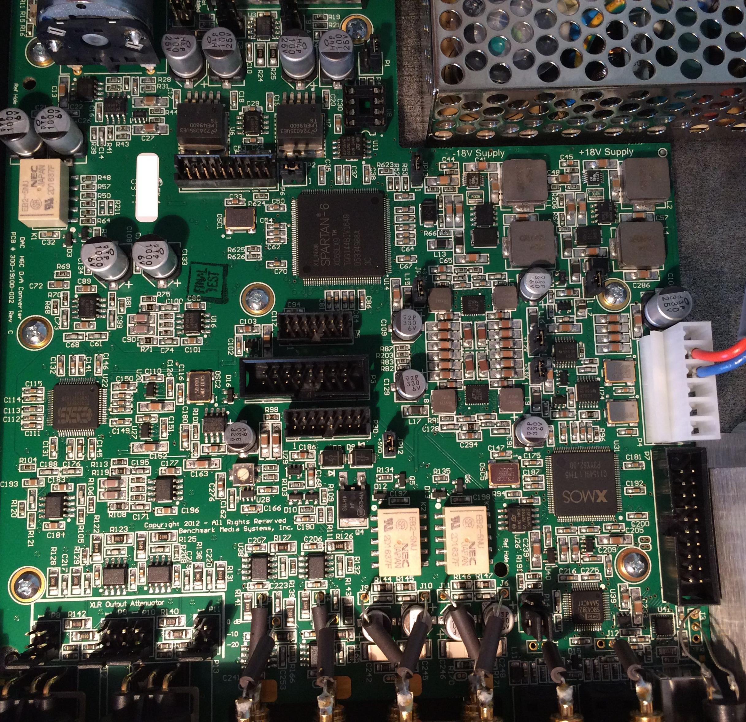

What do you think of it?
Probably anticipate not as good as one of the boards in this thread when fully modded, which in turn is not as good as a Benchmark DAC-3. Don't think it probably lives up to the moniker 'audiophile.' Phase noise appears cut for the same reason some of the other info is displayed in lo-res images or otherwise obfuscated. It probably would not be something I would like or use if somebody gave it to me. Then again, don't know about the market it is positioned to occupy or how much it sells for. It might be good given such considerations. All the above my personal opinion only. Have not listened to one of the units, so opinion could be subject to change but not likely by much.
What kind of sound difference could this board bring comparing to the su5? Is it something relatively similar?
Hard to say given how little we know about this one. It was hard to say about su5 before listening and looking close up. Obviously, this one has much less circuitry in it. DAC-3 has a lot, and for good reasons (see pic below).
