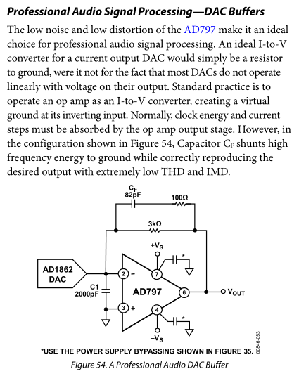

One thing which caught my eye there and which looks to differ from ESS's own recommended circuits is this, written by John Siau :
One complication is that high-frequency switching noise is always present on the current outputs of sigma-delta converters. This high-frequency noise must be bypassed with rather large NPO or COG capacitors before entering the I-V converter.

Oh and a useful link pertaining to ESS DAC common-mode noise (referred to by Mr Siau) : Hi-end DSP based multi-channel integrated Preamp/Crossover/DAC project

Scott Wurcer's applications info for the AD797 suggests a 2nF cap prior to the opamp I/V. I'd not say that 2nF would count as 'rather large' though as C0G goes up to 100nF comfortably.
Given that Scott Wurcer and the guys at ESS are old friends, and that Scott maybe not too long ago did some tests on an ESS DAC for them and found some problems for them to work on, don't know if that question ever came up.
It could be that putting a modest C0G cap there would be a good idea.

The 2nF C0G cap should be tied to offset voltage (AVCC/2) though and can be soldered to the 2 input pins of opamp directly, right? Would be interesting to see if opamp temp falls with this measure. Could this also help on ESS recommended AVCC reg in parralel to the 10 uF input filter cap?

The 2nF C0G cap ... can be soldered to the 2 input pins of opamp directly, right?
The cap would go across the input pins of each I/V opamp, as you say. Do you by chance have any way to measure the results? A sound card with a 24-bit A/D could probably work.
Also, I would not add a C0G cap from AVCC to ground. It could cause the AVCC voltage regulator opamp to oscillate. At the very least, one would probably want to watch what happens with the AVCC opamp with a good scope if trying something like that. Even if no oscillation one would still want to verify it did more good than harm downstream. Another reason to have something on hand to measure the audio output with.
