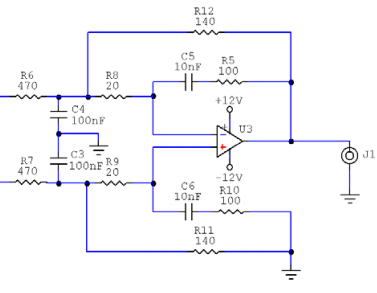

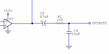

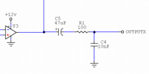

Here are three snippets where I'm of the view there are worthwhile improvements to be made:
In the first, the output impedance (2k per leg) is rather too high for driving a cable.
In the second, the input impedance of the bal-SE stage is too low (presumably for noise purposes) and the output padding resistor is missing.
In the third, there's no R to 0V to establish a DC bias across the output 'lytic.

Hey abraxalito
I really appreciate the suggestions you've made. In the third illustration. I see the tail end of the single op amp IV circuit that ESS recommends. I built it intending to see how it would sound compared to the 3 op amp just so other builders would know. As you pointed out, it didn't work at all and the fault was clear to you but I don't have your knowledge and abilities. In the end my searching for a build fault of my own ended up with me making a mistake and shorting the power pin and AVCC out with my meter tip with the resultant 12V delivered to AVCC which meant instant death to the DAC chip.
Markw4, looks like I was right all along. The circuit that ESS provided is indeed missing something. An EE would have caught it but I had no chance. As it happens my last PM to Markw4 warned him that I was sure that the schematic that ESS put out was incorrect as I checked over 10 times at different periods to see what I might have done wrong and could not find any fault. If there was an error, then someone should also try it and point out the error to potential builders using ESS recommended circuits. We owe future builders that.
The other thing about hat document that ESS put out is the date. Since then many newer LDO regs have been put made. The ESS9008 referenced in the PDF when I checked goes back nearly a decade ago so time has passed but keep in mind the fundamentals of what needs to be done is the same. So the paper is still valid in most ways and it is indeed interesting to see that products ten years after it was known how to do it right is still not being done right...Reason? Must be cost and complexity and the realities of the marketplace.
I am in the inkjet printing business and despite Canon and Epson being large companies with great engineers you sometimes see them making errors. It happens.
Guys, please.
abaraxalito, you make some valid points, don't know why you didn't bring them up before. The resistor to ground to define the voltage on one end of an electrolytic cap came up before and I explained why one might be put in that type of location, but speaking generally not with respect to that particular schematic.
Also, with respect to your comment about the second schematic, if you are referring to the 20 ohm resistor being too small then it isn't necessarily a problem if you see how that part of the circuit works. The current through that resistor is only for very high frequencies and because the amplitude at those frequencies is low, the amount of current needed from the opamp output though the 20 ohm resistor may be well within the capabilities of the opamp to deliver. It depends on how much HF is coming out of the DAC outputs, something that ESS would presumably know.
Mikett, please don't jump to conclusions. An EE would know a missing resistor there would not explain your circuit failing to work at all. It could cause a little 2nd harmonic distortion to appear until the cap self-biased to an appropriate voltage level. To explain further, an electrolytic behaves something like a diode in parallel with a capacitor. If the diode is biased off then no current flows through it. If the diode is not biased off then some current will flow through it on every half-cycle until it is charged up and the diode is biased off (or perhaps until the cap self-destructs from over-current, a very unlikely event in this case). It may leak down, but it would pump back up again with some signal across it. Missing resistors of that circuit function occur with come frequency in things like guitar pedals and they do not damage opamps or cause complete failure of a circuit to operate. You might even like the little bit of even harmonic distortion it can produce. However, for Hi-Fi I would recommend to put the resistor there as it could cause the circuit to measure as having more distortion even if you liked the sound it gave.
No, I wasn't focussing particularly on that resistor, rather considering the circuit as a whole. In context its not fed direct from the DAC chip, rather from I/V opamps which in turn are fed from the DAC.
I just put the schematic into LTSpice which confirmed my suspicions - that those particular resistor choices place undue loading on both the I/V opamps (not shown in my clipping) and the opamp which is shown in the schematic.
By my estimation, the Zin at the inverting leg (the input impedances aren't equal) is 376ohms. The loading on the opamp shown is around 4dB lower, say 237ohms.
I speculate that the designer may have been aiming for a 600ohm Zin on both legs by the resistors chosen (470+140) but was unaware that there was an imbalance between the two legs. He was also I suspect blissfully unaware of the heavy loading on the output of the opamp shown.

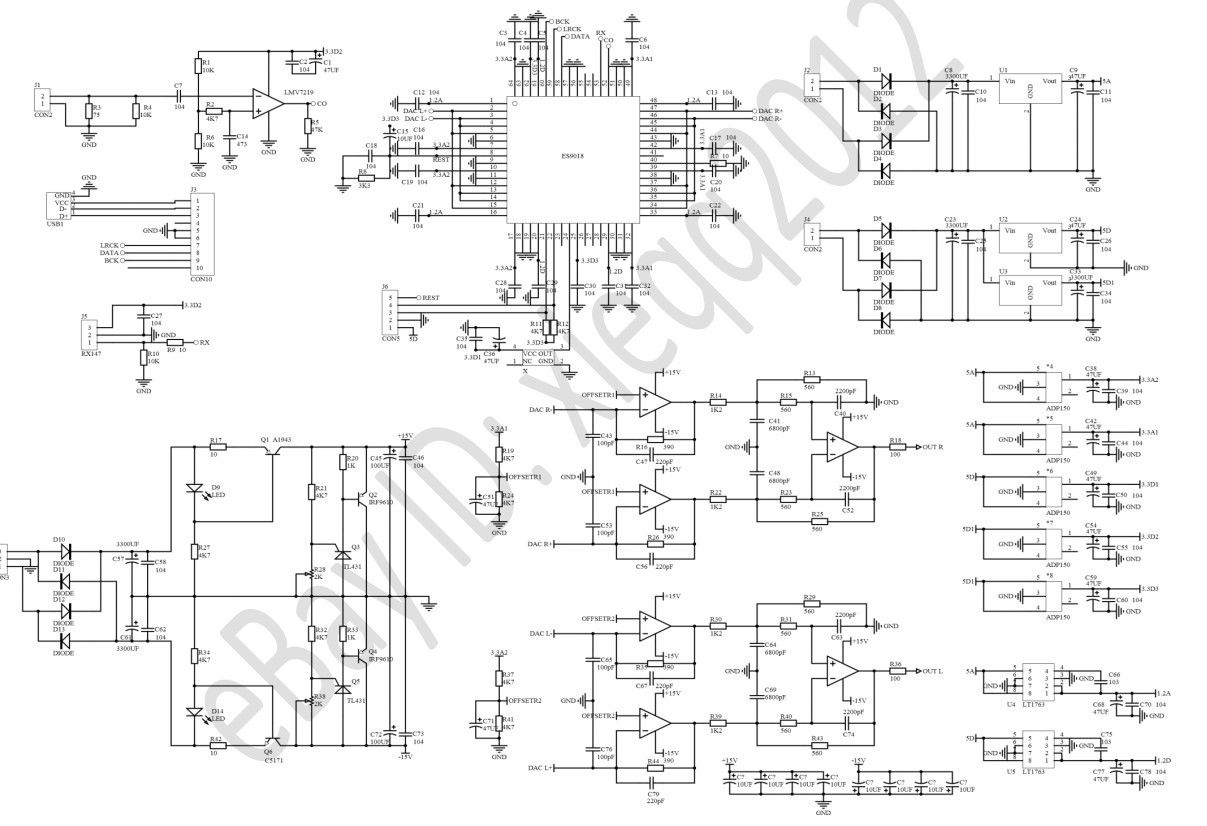

This interesting because the values shown on the ESS circuit is near identical to the one contained in my Ebay 9028 PRO DAC board a the last stage.
On another board the similar circuit is as shown in the attachnment. This board however does not allow for an XLR output.
So is this because one is trying to provide both XLR and Balanced and one dedicated single ended?
This is a good discussion of which might be better considering that the needs for balanced and single ended must be met.
I had been wondering about the values chosen by ESS versus another design and using the same op amps and functionality and what the tradeoffs were.
