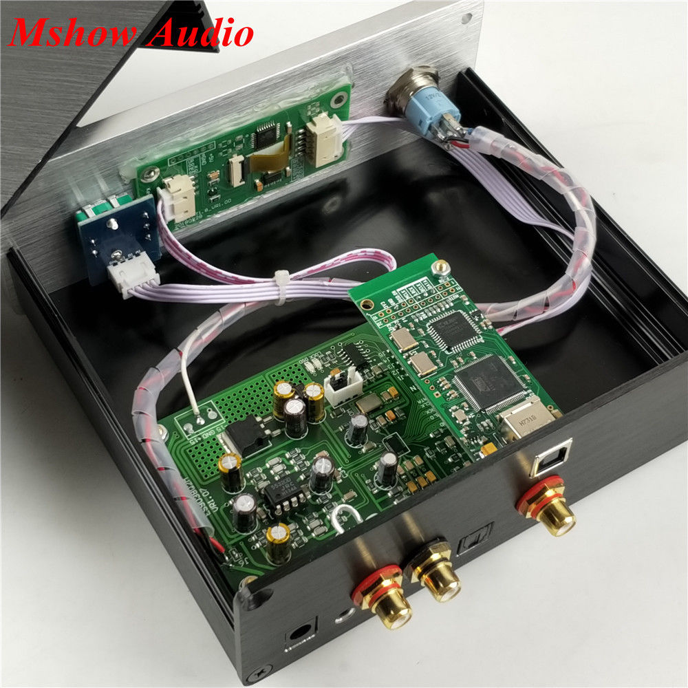

I am using a generic brand ES9028Q2M box which sounds quite good to me, at only half the SMSL M8A price and allows me to use an Apple Remote for the input and function control.
NEW ES9038 ES9038Q2M DAC HIFI Decoder AUDIO IIS DSD DOP 384KHz + Amanero USB | eBay
The ES9028PRO package is another step up in sound quality. To be honest, I do not know how audible the sound improvement is. I just trust Markw4 and Mikett that it is worthwhile. Then I can judge it myself when I get the ES9028PRO. And the other half of the fun is to do the mod.
