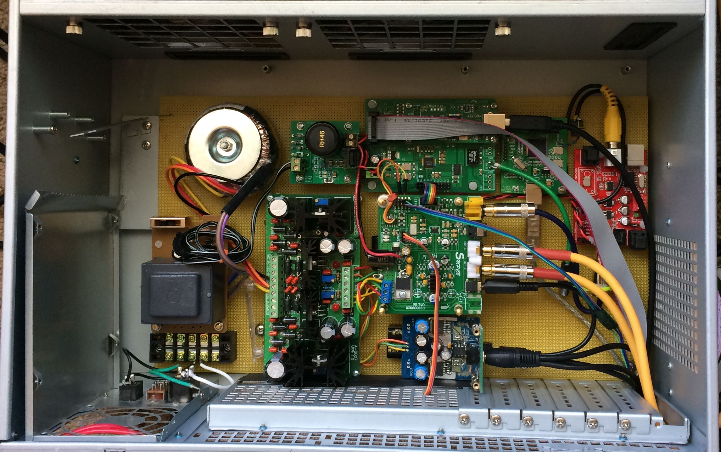

Since we seem to be showing off packaging ideas, I have my test circuitry in part of a steel file server case. I can test different power supplies and SRC options, etc. using this.
Eventually I will put some selected components in a smaller box, but i don't want people to start getting the idea I am opposed to cases. I'm not. But, for a DIY project I would like to see performance come first and then a case found that fits rather than finding a case and adjusting sound quality to fit.
