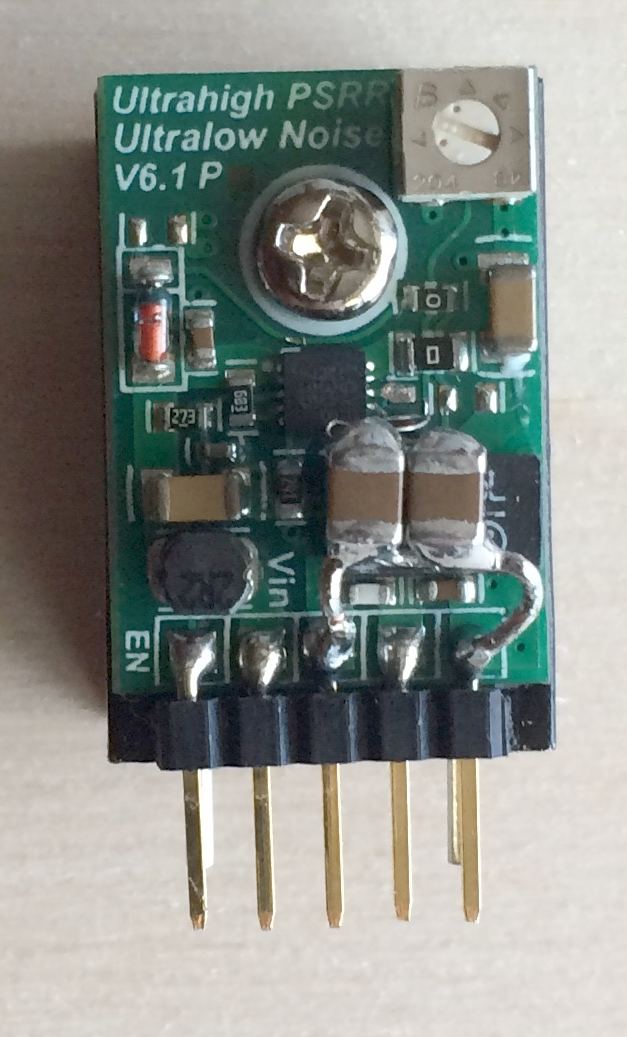

Looks a bit chaotic. Somebody should probably tell them about noise in tantalum caps they may be considering for LT3042 regulators. I am trying to mod one of the little LT3045 modules with 2 each 10uf X7R in parallel to get a little closer to 22uf. Haven't tested it yet, though.

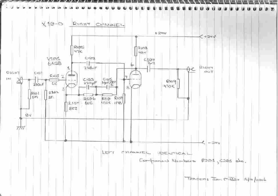

I thought was to use one of these X10D clones as an output stage as it is simple solution, already being assembled and it looks to be a faithful copy of the original, so with a couple of good NOS tubes should sound good.

X10D have a schematic?
It is probably a voltage amplifier, and for low distortion with these DACs you need a virtual ground, or virtual offset of about +1.65v, which is called the reference voltage. You need four of those circuits. Then the current from the DAC runs into that offset virtual short circuit and is converted into a voltage signal. Done properly one can get down to -120dB distortion by such means.
On the other hand, the DAC output can be taken as a voltage, but the distortion is then about -75dB, which to me is unlistenably bad, and awful.
Making the offset current to voltage converters out of valves probably require development of a new and somewhat complex valve circuit. I don't think anyone I know of has been very successful with that so far. And you would need to make four of such circuits to do it the proven way we do it with opamps.
So, I would advise that the 'proven' approach requires opamps for that initial analog DAC interface circuitry. After that tubes would be fine.

I think this is the correct schematic:
Taken from this thread:
Musical Fidelity X10D schematic
The X10D is a low gain buffer rather than an amplifier.
