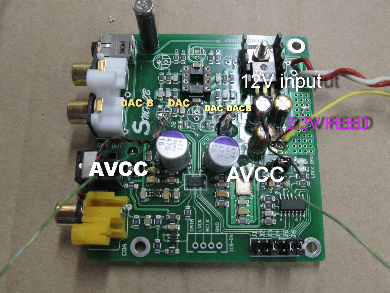

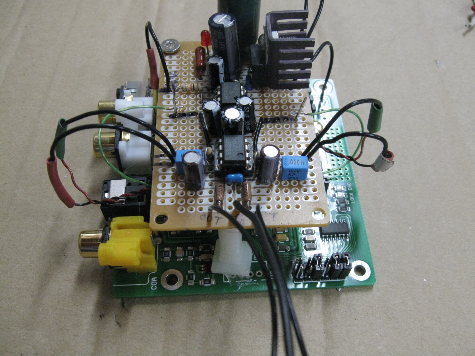

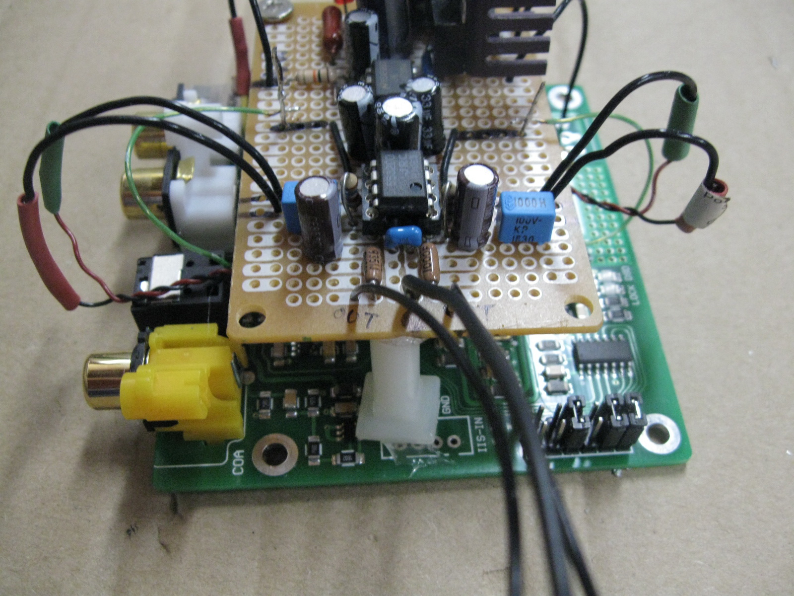

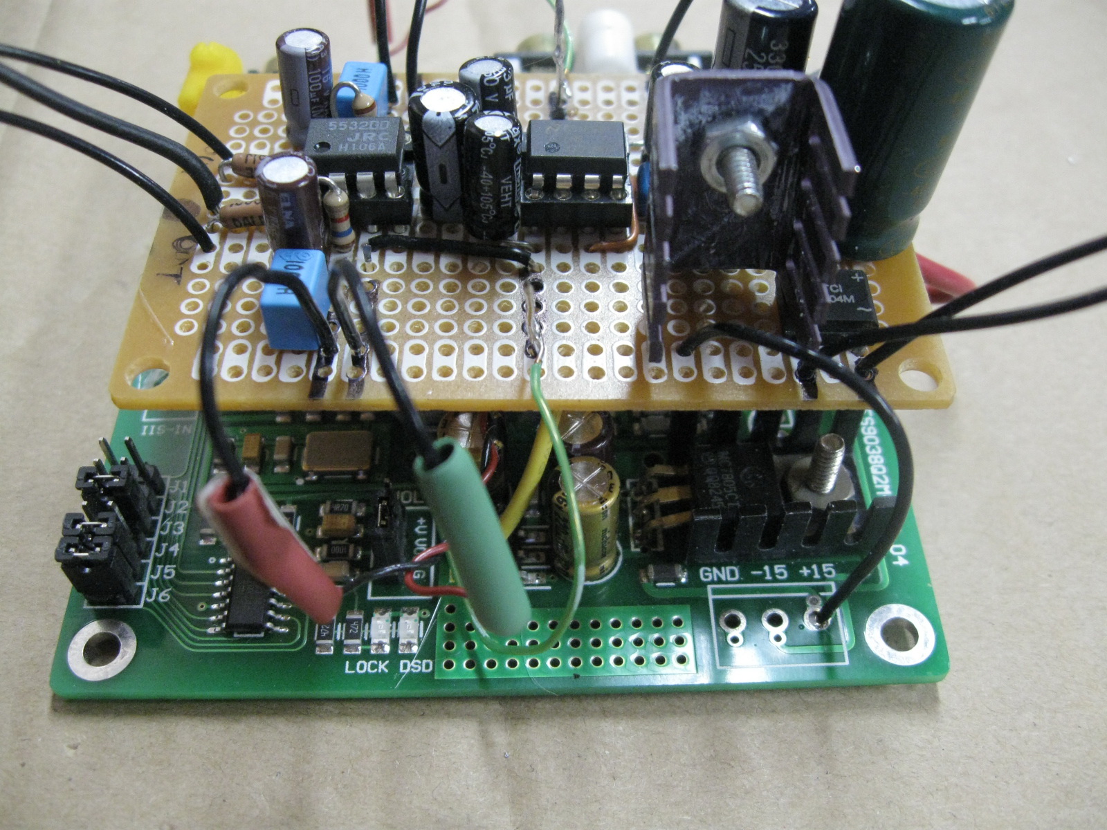

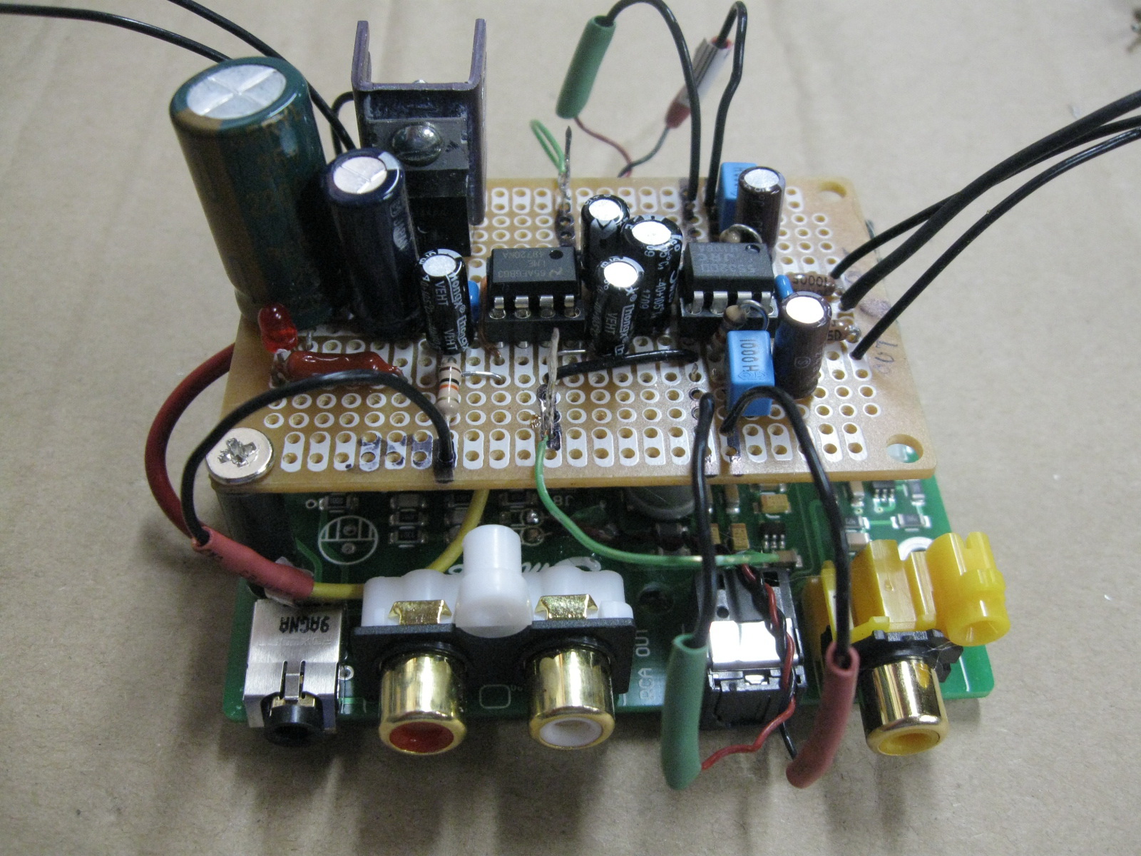

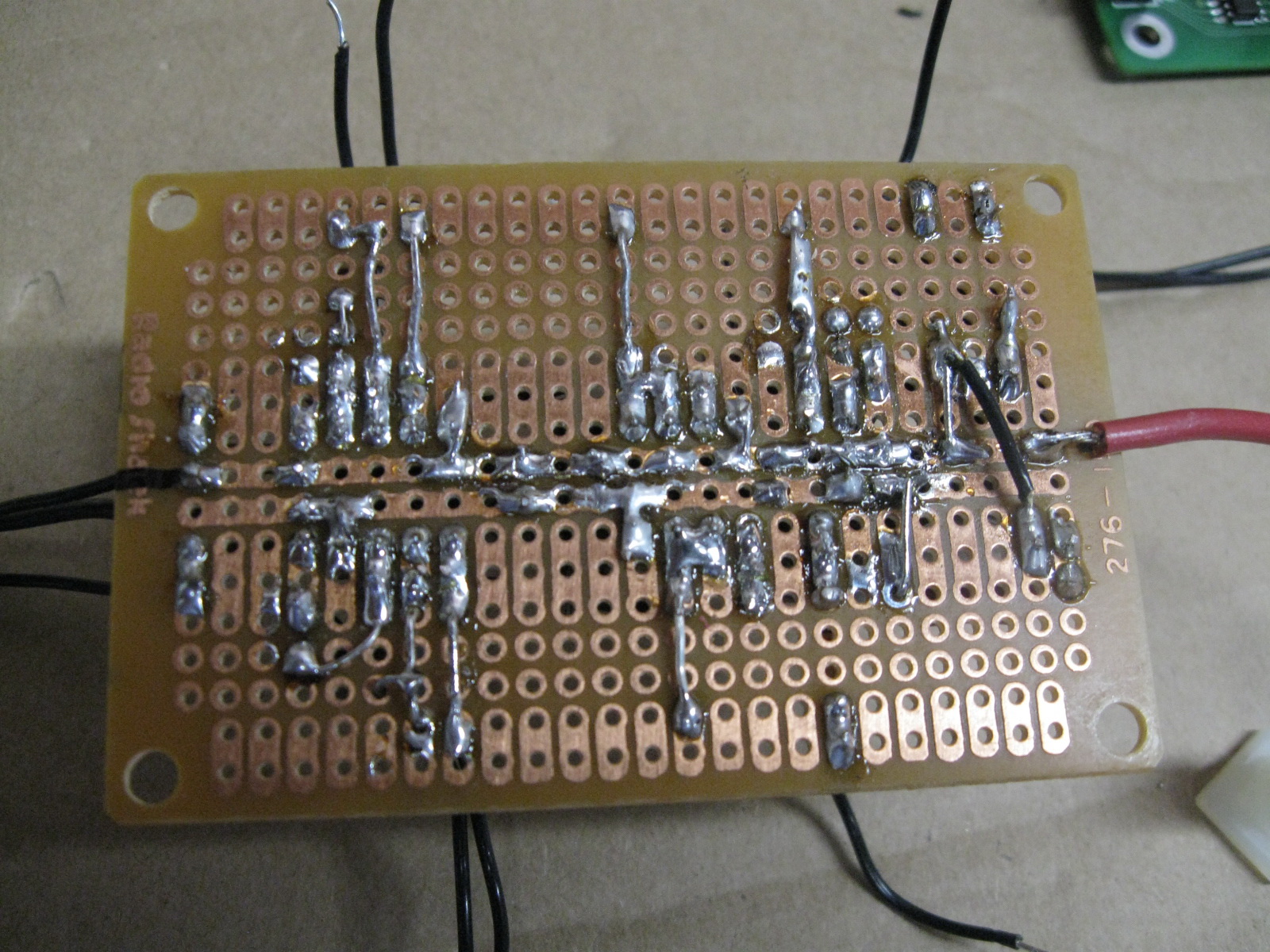

Here are the pics of the duaghterboard and DAC combined into one.
I powered it up. AVCC Feed was correct, 3.3V indicating the the 3 term regs including ams1117 was working.
Regulated AVCC was correct.
But I was still getting a positive 3 V and 9V at the output. I checked everything over six times. I changed op amps. The single op amp circuit as per ESS is simple and you could see the circuit just by looking at the board. I must have gone over that 10 times in total.
Here is what I cannot understand. With the coupling caps at the output of the ESS circuit, should there not be ZERO volts at the output?
I reused the decoupling caps originally on AVCC and repurposed them to coupling caps.
Electrolytic caps can leak a little current through the dielectric. They can also transfer some charge when you turn on the +-15volt power, and then again when you turn it off. That would occur even without any leakage current. So, there there needs to be a path to ground to discharge them. Your DVM is probably 10MegOhms input inpedance which might take awhile to discharge them but it might eventually. You could tie some 10k resistors from the outputs to ground if you want.
Also, if you are going to use opamp AVCC regulation, the AVCC caps in there now are too big. They appear to be 470uf. The ESS schematic and application note text says 47uf, or possibly 10uf could be used for certain opamps. Also, you appear to be using much longer wires for AVCC wiring that ESS recommends. My wires for that are maybe 1 cm long. Of course it is a very short distance on the back of the board to the bottom of the 47uf AVCC cap pins. Another good reason for putting everything on the bottom, that and the ground plane offers some shielding from all the RF down there in the digital circuitry. Looks like your sensitive analog circuits are right next to the RF with no shielding. Might be worth considering removing your board and the mounting spacers from the top and putting that stuff down under the bottom.

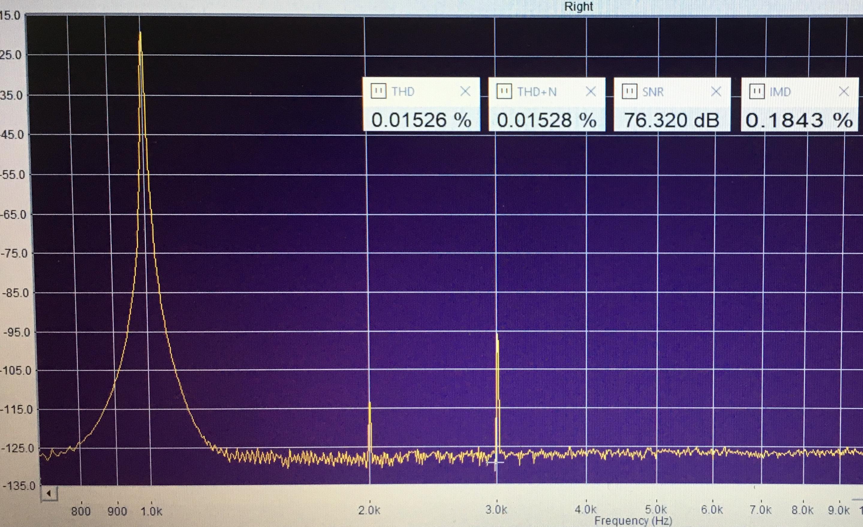

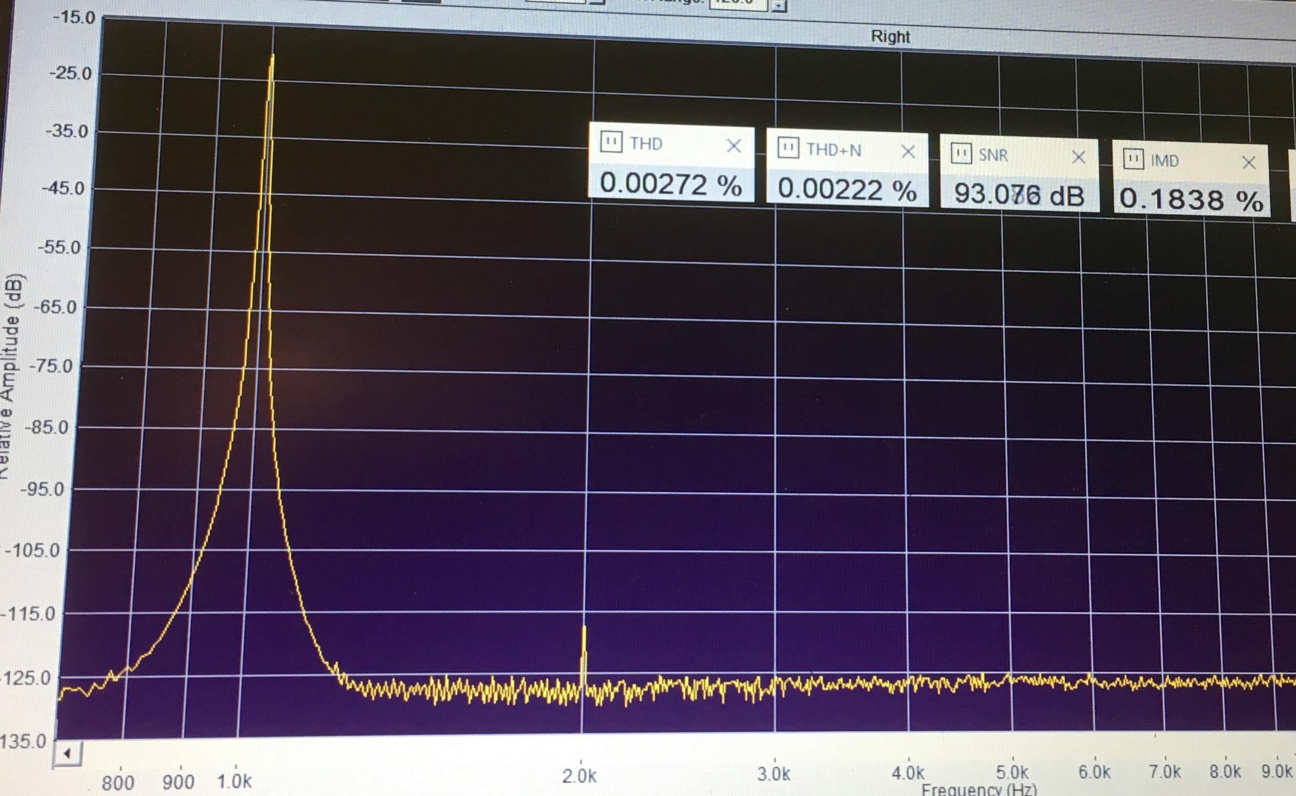

so, after relatively simple mods (separately regulated AVCC and I/V stage added ES9038Q2M Board ) THD went down from -76dB to -93dB. the SQ improvement is pretty evident - vocal "sibilance" is gone and bass is more "resolute".
in the spectrum the 3rd harmonic is bellow measurement noise floor now, however the 2nd one changed little. any suggestions what direction to dig now in order to get rid of it?

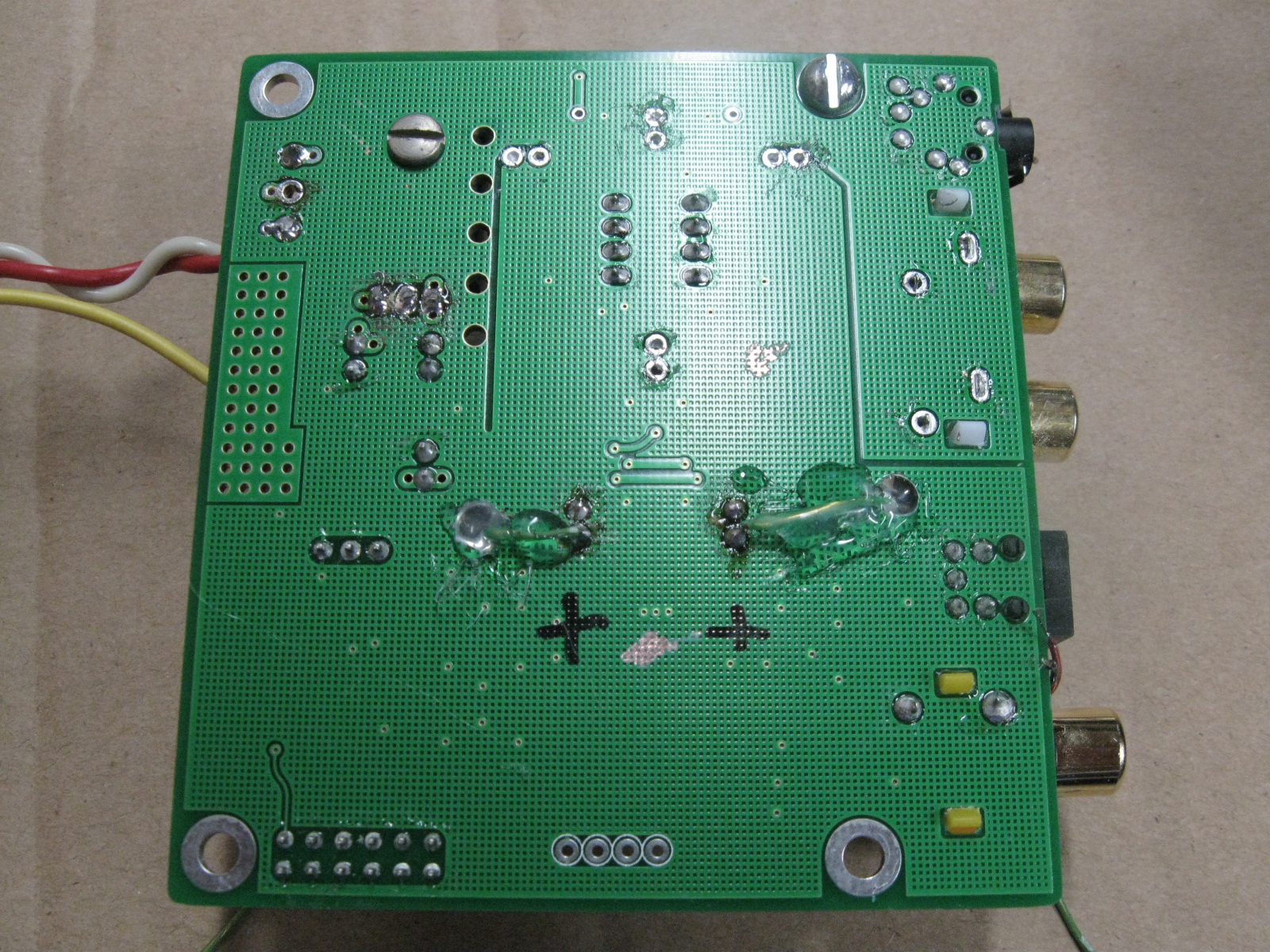

Then...part 2. In my quest to figure out what was possibly wrong I was measuring voltages directly on the ICs and the tip of my probe shorted pin 8 Vcc+ on the op amp (12V) to pin 7. That's 12V to AVCC, a tiny spark and then seconds later, I saw some smoke from the underside of the daughterboard. I think the ESS chip is fried...AVCC will not tolerate that high a voltage.

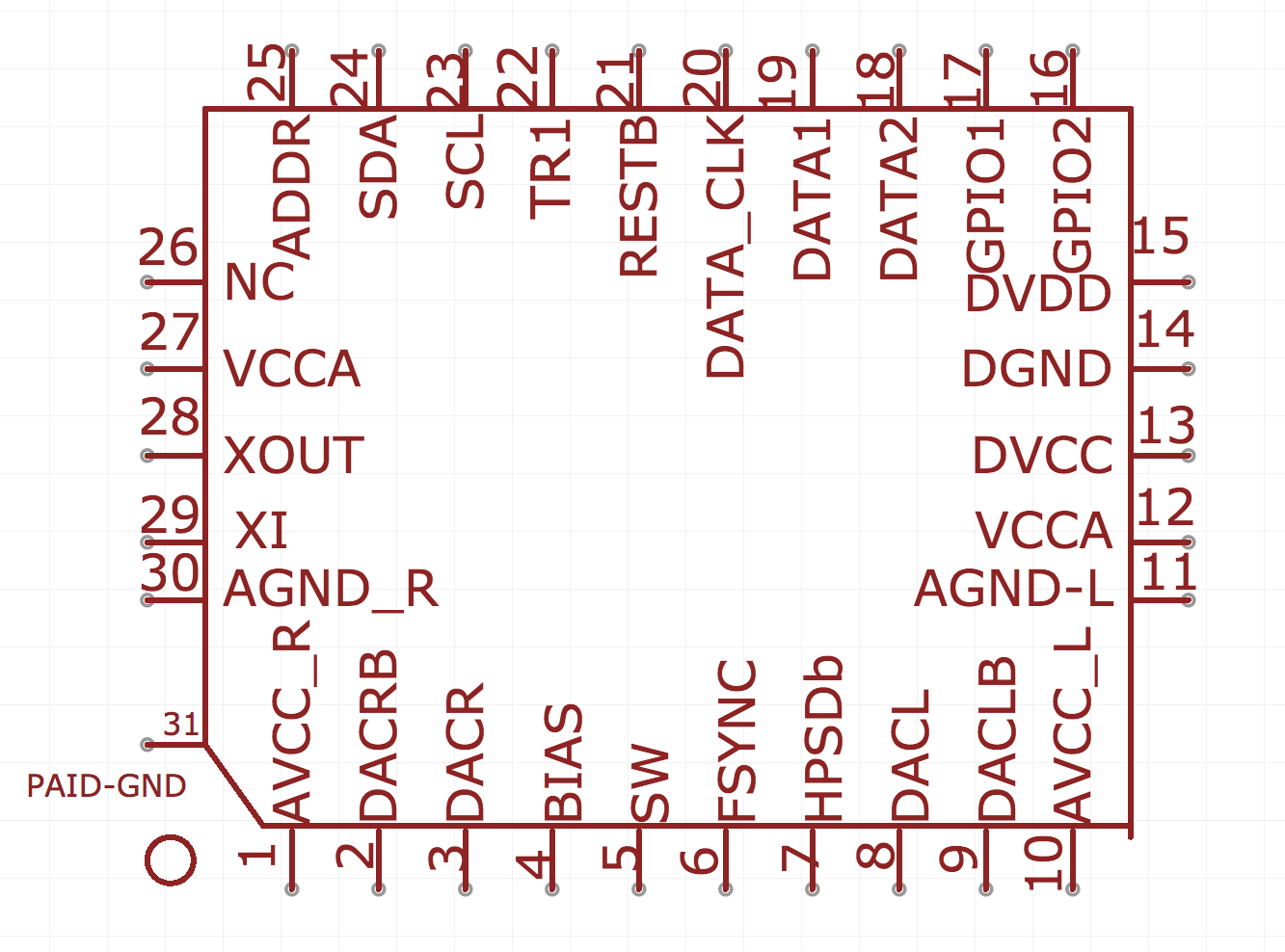

Also I was double checking the pinout of the 9038q2m. It appears that markw4 connection description on the where he connected DACB and DAC is reversed. Makes no difference in the 3 op amp output. I think.
In the single op amp solution that ESS recommends, that possibly will make a difference.
When I posted pictures of DACB and DAC it was based on looking at the Chinese boards and how they hooked up their voltage output stage. At that time we didn't have any other information about the DAC chip. Since then someone posted the pinout diagram below. It may only matter for keeping the channels in phase with each other, which seems like the most likely thing.
However, while I don't think it should probably matter which one is used for which when using the minimal IV output stage, the only way to find out for sure would be to swap the leads and try it both ways. Don't think anything could be hurt by doing that.
