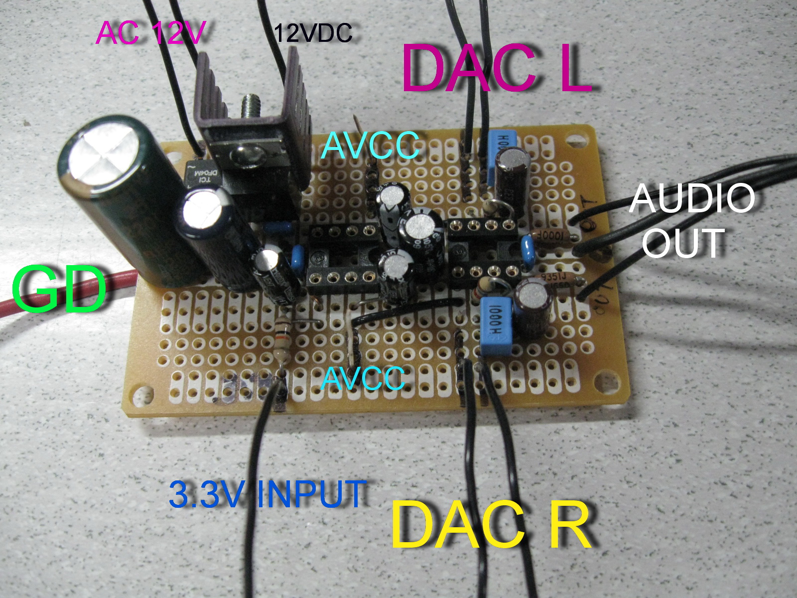

Here it is and I forgot to connect the op amp power underside but basically done
Next stop is to start hacking up the DAC board

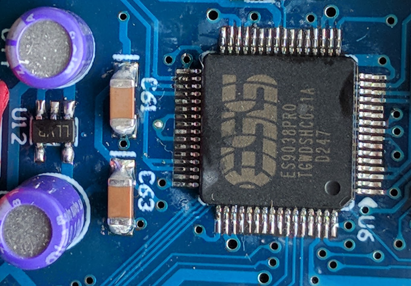

Mark. In terms of qiuck pulse shot you have right about ringing. I mean at square response that is huge ringing. You know what i mean. You have documentation for es9038q2m maybe you can reveall why your board has 1.2V regulator new board not. Or it has internaly regulator that is hardware or software enabled. At my dac pin 15 has a classical smps noise pattern which trought capacitors polute gnd and trought caps again polute nearby supply pins. One good thing is that es9038q2m has muuuuch smaller noise on output.. I think similar as Ak449x so not much noise get in first opamp even in current mode. Thank you
why your board has ...
I don't know why, there should always be an internal one that just needs decoupling at the pin. Maybe external makes less noise? I don't know. If the DAC board was better designed there would be separate digital and analog ground planes so noise would be less of an issue. I guess one doesn't get that for $39, or whatever the boards go for these days.

Just wonder why do you need extra +12V? What op amps will be used on that board?
And with a single dual opamp for the output stage I would leave it in the original socket, reworking surrounding parts. AVCC buffer goes underneath. Less wires and no drilling IMHO.

On the pictures I posted earlier you can clearly see that the direct line between pin15 gnd and main gnd pin goes very near the the chip and crosses the output signal( in the ground layer). I would assume putting noisy gnd current here would affect the traces above? Would it be better to put pin 15 gnd pin into a wire and route it separately to main gnd pin?
I am struggling with through hole as it is , Surface mount is a no go for me. No skills there and not possible when I am this old. The other thing is that most of the parts were in my old parts box. There are some parts in there that date back to the early 1980s no late 70s actually 1979 to be exact.
I will be running the complete DAC including the IV from a SINGLE 12V. no Negative 12V. This aspect would also require more work on the DAC board. The other aspect is that the DAC remains fully digital and the grounding area is all fully digital as well. Off board will all be analog. Hopefully that helps with noise. Also the reason why I stepped back to this board rather than stage 2 is to discover just how good this DAC can be without special parts. The parts used were primarily in my parts bin.
