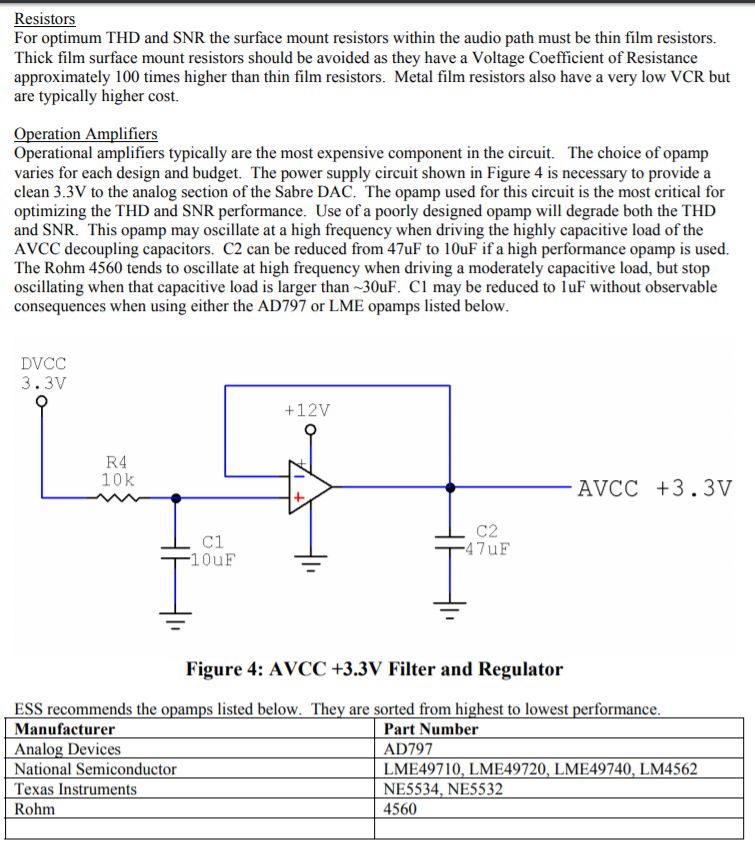

Personally, I am using an opamp regulator for AVCC as ESS recommended in the documentation on their downloads page. All opamps in my circuits are LME49720. Those opamps are virtually the same as the opamps used in Benchmark DAC-3, except for maximum voltage rating. A DAC-3 uses +-18v rails rather than +-15.

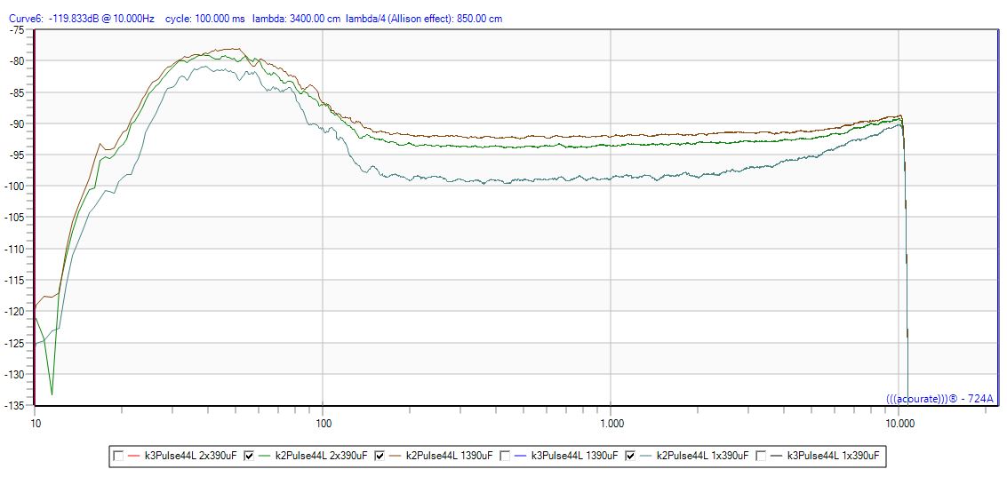

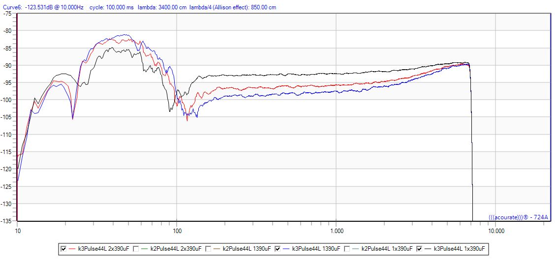

I did some investigation on destortion at output relating to the capacitance value on AVCC. I just compared to the current value of 390uF polymer on board (+1000 uF at the output of my ext. 3,3 reg PSU board).
First to mention, with all cap-values the f-curve was flat (measured with 44.1kHz SPDIF entry and at RCA output with -4dB digital attenuation). This could not be the reason for additional bass impression.
I realized with doubling the on board cap from 1x390uF to 2x390uF the K2 around 20Hz and > 200Hz increased for more than 5dB! At the same time K3 decreases for 3dB >100Hz.
Increasing on board capacity to 1390uF further reduces K3 for 1dB >100Hz and K2 increases only a little for 0,5 dB over total f-range compared to the 2x390uF on board.

Here some measurement pics to above investigation.
Probably the increasing K2 is responsible for the "better" bass performance when increasing cap values..

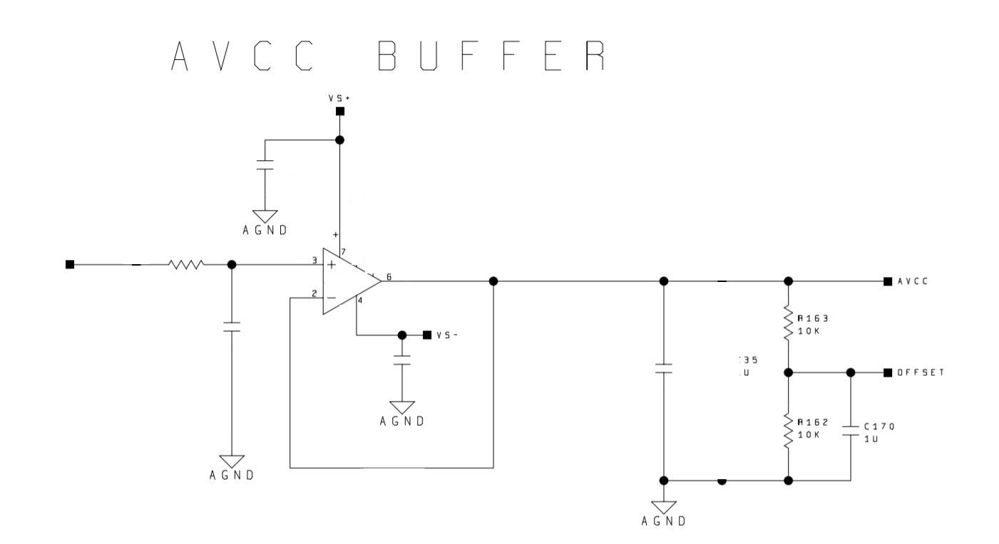

Attached below is information about the AVCC circuit that I used. There is one opamp circuit for the left channel AVCC and another opamp circuit for the right.
However, I only used one input filter that is shared by the two opamps. The filter cap is 10uf.
I mounted the circuit on a little board on the bottom of the PCB and picked up the +=15v from as close as I could down there. It may not be clear from looking at the pictures that I got power from the bottom of the -15v filter cap for the opamp on top of the board which was nearby on the bottom of the board. For the +15v power, I brought it down to that area on the top of the board by repurposing a no longer used trace on top, added more filter caps on top of the board then drilled a hole and brought it out on the bottom near the AVCC circuit. More power decoupling caps were added right at the pins of the dual opamp used for both AVCC circuits.
The input 3.3 voltage was taken from a low noise 3.3v regulator I added just to help keep the analog part of the DAC circuitry more isolated from digital noise and as clean as possible. Whether or not power for the 1.2v regulator should have come from there too or not was a guess since I didn't and still don't have a data sheet.
All the opamps I used were LME49720. Lately, I have been trying +-16v for the opamps. Have to be careful with that. Don't know if it makes any difference yet. But, I am curious since Benchmark uses +-18v and LME49860 opamps.

Thank you! So no ceramic caps for C1 (not clear from ess slide).
I still wonder what is the advantage of using this opamp AVCC buffer +3,3V reg. instead of taking 2x 3,3V regs? Does PS for opamp need to be of same high quality as such 2 regs or could it be of lower quality?
C1 is electrolytic. I edited the previous post a bit. Not sure if you noticed a few minor changes.
Maybe two very clean high-quality regulators could be used instead of opamps, but have to look at it carefully to see if performance would be as good. Without looking at specific regulators and doing some analysis, my guess would be using opamps is preferable.
The reason for using two circuits is to help keep excellent stereo channel separation. Even using two single opamps instead of one dual opamp might help. It can make an audible difference even if one might not think so. Same with using two separate headphone amps, one for each channel. It might seem like overkill but if you compare it with shared circuitry the physical separation can help.

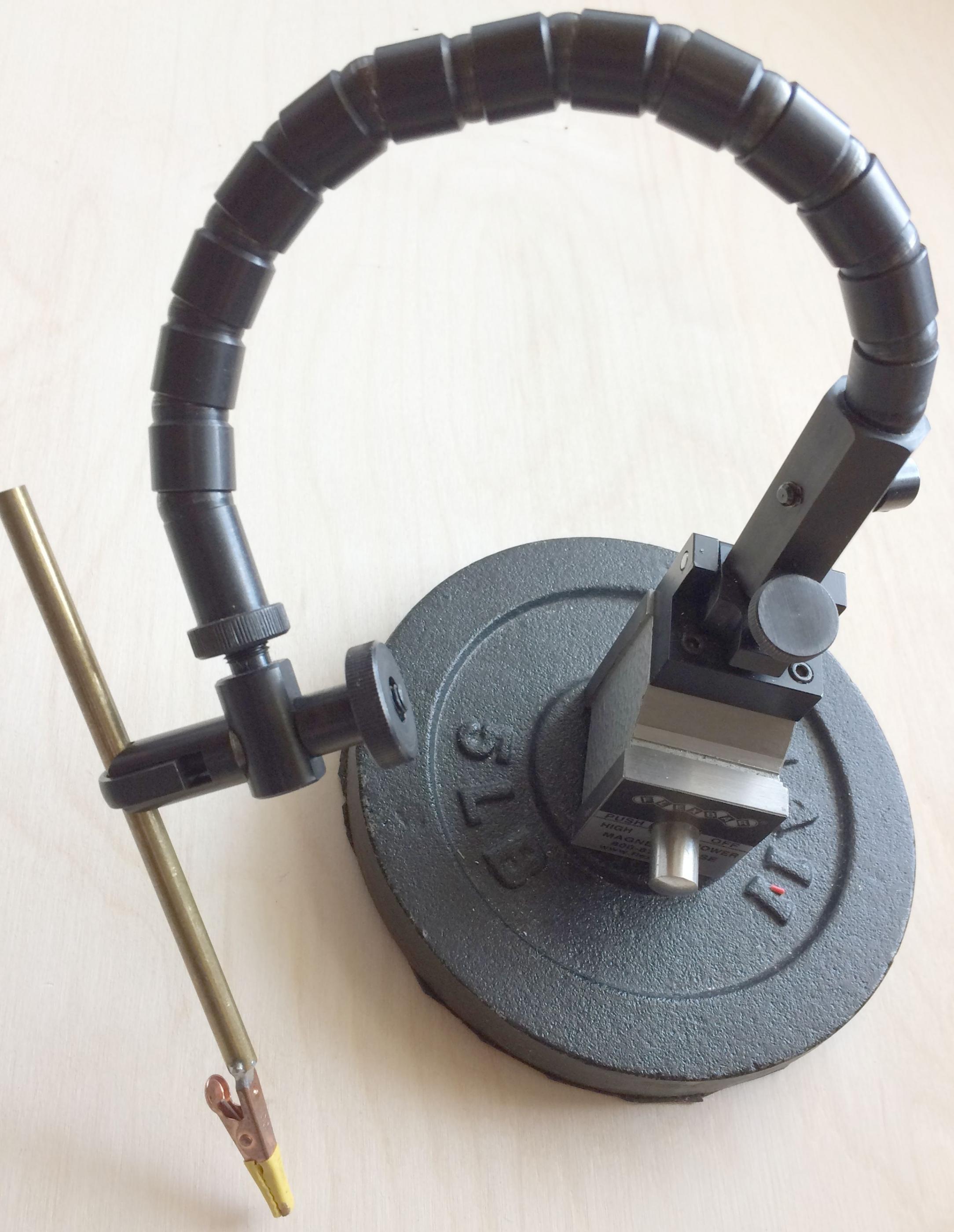

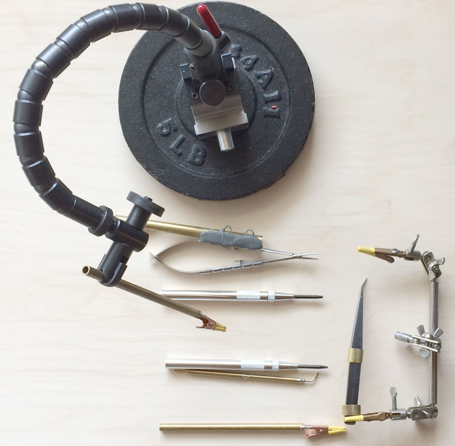

I will say that working with tiny parts and working with hot air and so on are things I am getting more comfortable doing as I gain experience. It helps to collect some old circuit boards from old computers or anything with small parts on it. Then experiment, practice, and learn how to remove and replace components. There are also SMT soldering practice kits available. Good stuff, less daunting and more fun the better I get at it.
I will post a picture below of a gizmo I made to help with it.

I would try the ESS recommendations first. They probably did some analysis and testing we may not be equipped to do.
Also, usually buffers use up opamp gain to help achieve low net distortion and produce good performance. As a result, distortion is worse than an opamp alone. That is certainly true of the LME49600 headphone amp or pretty much any power amp.
