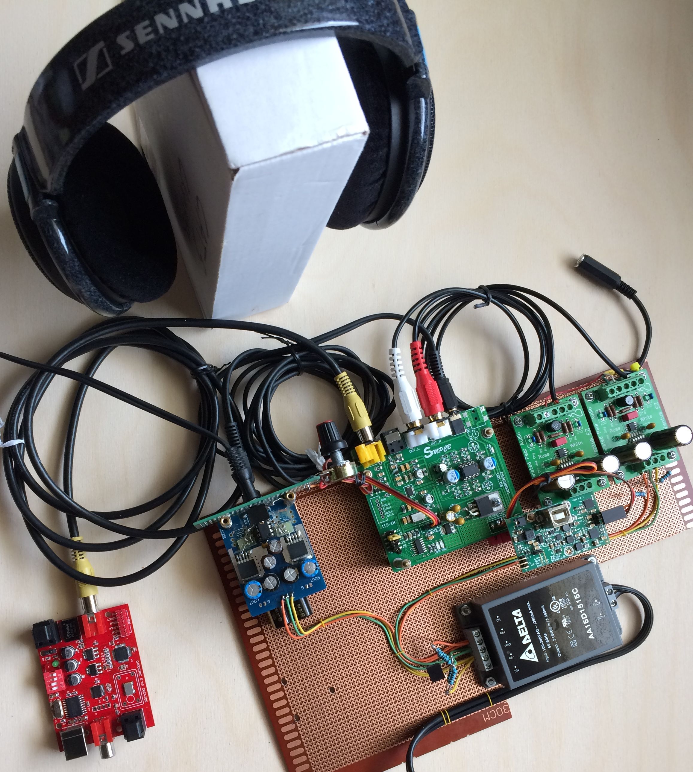

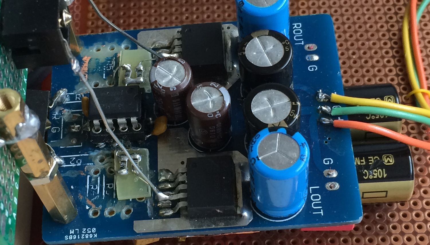

Promised some photos to show how the test setup is looking these days and to offer a look at the modified headphone amp.

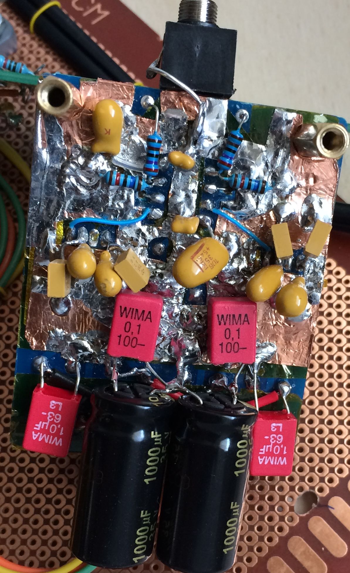

The headphone amp has a number of modifications as can be seen in the attached photos. On the bottom of the board, mylar tape was put across all the traces to insulate them, then adhesive-backed copper foil was cut and put in place, and the pieces soldered together. Tantalum and ceramic bypass caps were added at each IC. Those caps are mainly there to assure stability, freedom from power supply related oscillations, and reliable operation.
However, if you look at the test setup picture I also have some Twisted Pear LME49600 headphone amp mono-blocks for sound quality comparison. They are hard to beat for stereo separation, which was what prompted me to add the film caps and extra 1000uf electrolytics on the bottom of my modified board. Now stereo separation is very close to the mono-blocks.
My modified headphone amp and the Twisted Pear boards also differ in that the latter are optimized for unconditional stability with a capacitive load and mine are optimized for lowest distortion. So long as the power supply is clean, and the DAC has been modified to produce very low distortion, I prefer the accuracy of my low distortion version. For example, cymbal tails sound cleaner to me with it, but if power or DAC quality is poor, you will hear it for sure. The Twisted Pear headphone amps seem to be more forgiving and sound better to me when everything else isn't just right. That is my personal opinion only, of course.
I also showed the Sennheiser HD-600 headphones I am using. That model has been used for mixing and in mastering rooms for many years by many different people. I recommend them for good sound quality when listening to a reproduction system of the quality we are going for here. Unfortunately, they are not cheap but that is the way it is with transducers, good ones cost a lot to make. Don't know any cheap way to get around that.

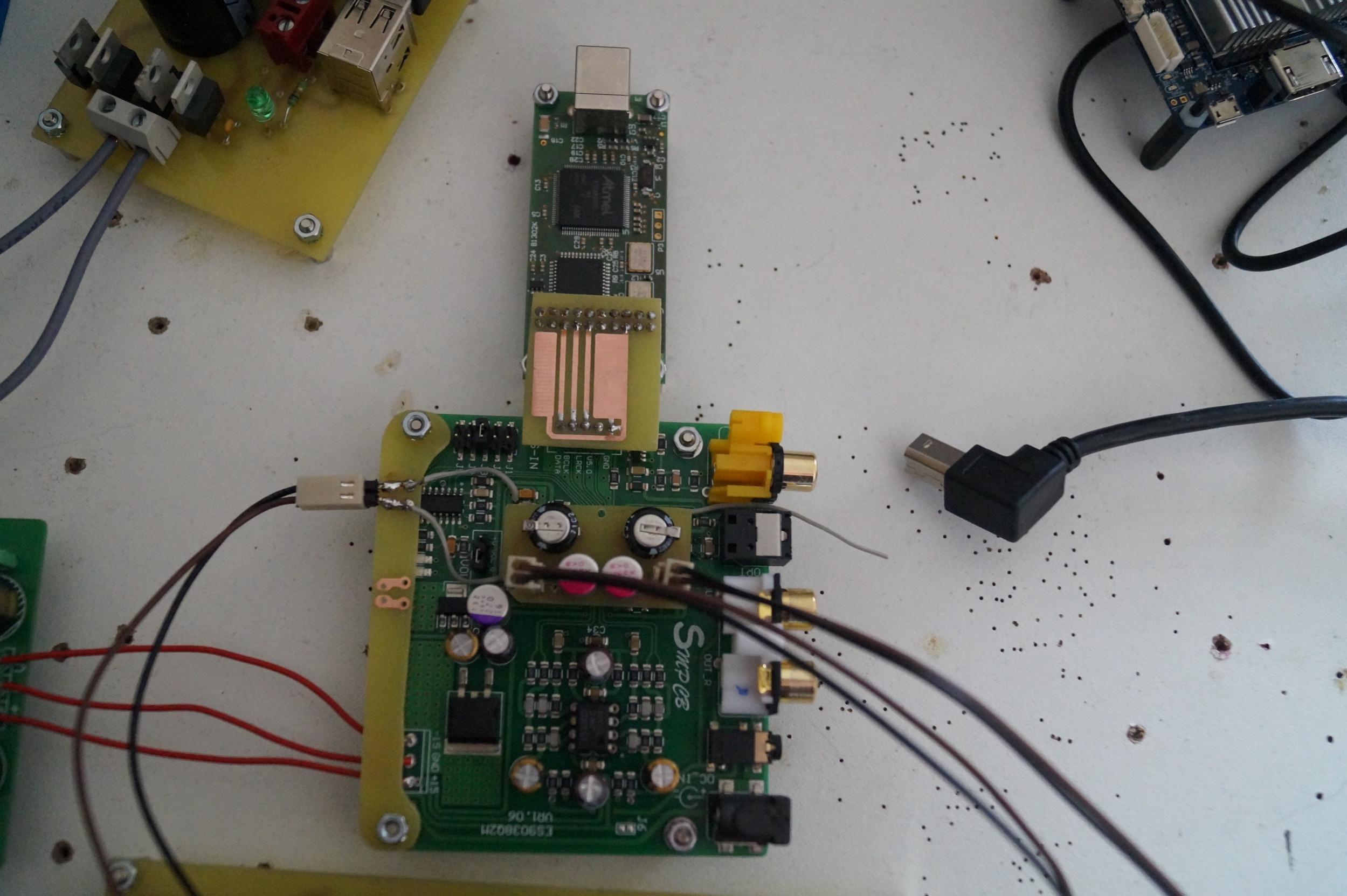

Will this Amanero board work? It has been through a group buy on this forum years ago and has been well documented aswell. I also found a forum that said it worked with Android. It's possible to run it with external regulator and they have some software tools for it on the amanero site. They use good clocks for this price point too. Amanero Technologies
Amanero board would probably work. Depends on what you want to do though. I am recommending upsampling to 211kHz or thereabouts before going into the DAC. It sounds a LOT better, IMHO. In that case, the Amanero board would be interfacing to one of these (or the equivalent, if anybody can find such a thing): Free Shipping! 1pc SRC4392 asynchronous Upconversion with USB coaxial optical I2S Decoder board-in Integrated Circuits from Electronic Components & Supplies on Aliexpress.com | Alibaba Group
I am assuming here that the microcontroller on the SRC4392 board is configuring the board to accept the PCM the Amanero puts out. The SRC4392 chip should be able to accept 32-bit PCM, but in the worst case, you might have to take control with an Arduino or something. I have not tried it though so I cannot tell you for sure.
The thing is, if you want very high sample rate DSD then no use upsampling. But, if you want the best CD and DVD experience, which is the vast majority of what people listen to, then you would probably find upsampled PCM a much, much better choice. In that case, you would not necessarily need an Amanero board, it might be overkill.
Another option would be to use the Amanero for very high rate DSD and get a cheap USB to SPDIF board for PCM. They would route into the DAC perhaps differently or you might want to make a switcher. Don't know about that yet. We will have to see if we can get master mode I2S working with the ES9038Q2M. If so, then you might have to decide what you want to do at that point.
EDIT: It may also help to understand that right now I am going from the SRC4392 into the DAC using SPDIF. If we get to the point of getting master mode I2S working with the DAC, then the I2S port on the SRC4392 board would probably end up being configured to act as an output. In fact, I only assume it is an input right now, I haven't verified that. Easy enough to change it around with a 3.3v Arduino Trinket though. The project I am doing is definitely a work in progress. It is not done, although it is quite usable at the point I am at now assuming you have SPDIF out on your computer or stereo. Many motherboards and computers, all MACs, have it built-in although the owner may not be aware of it.

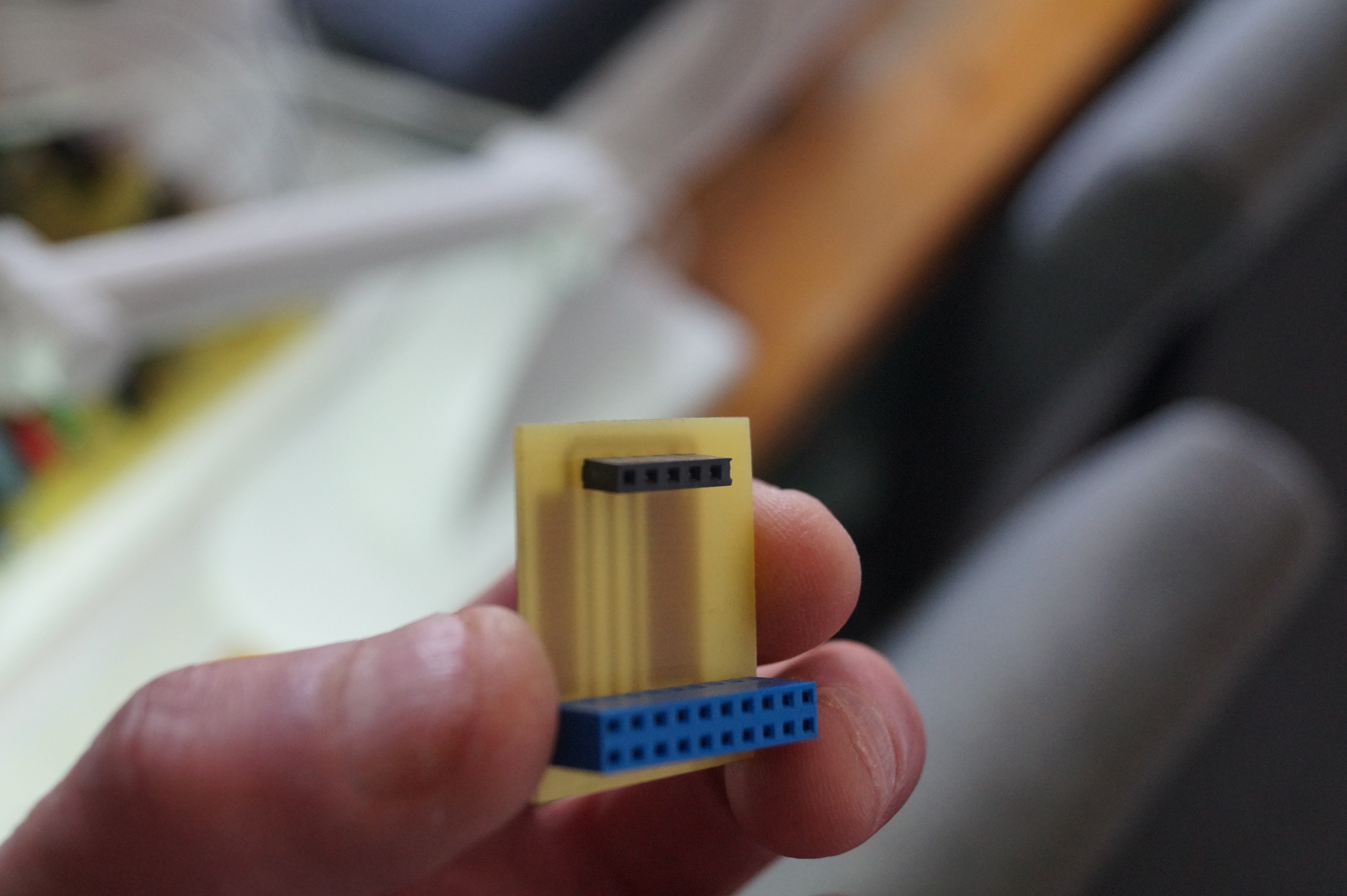

Note, that while v.1.04 have pins already soldered on the board, v.1.06 just have holes for pins and you have to solder them yourselvesExcellent questions, I have the same. The board is still on the slow boat from China.
