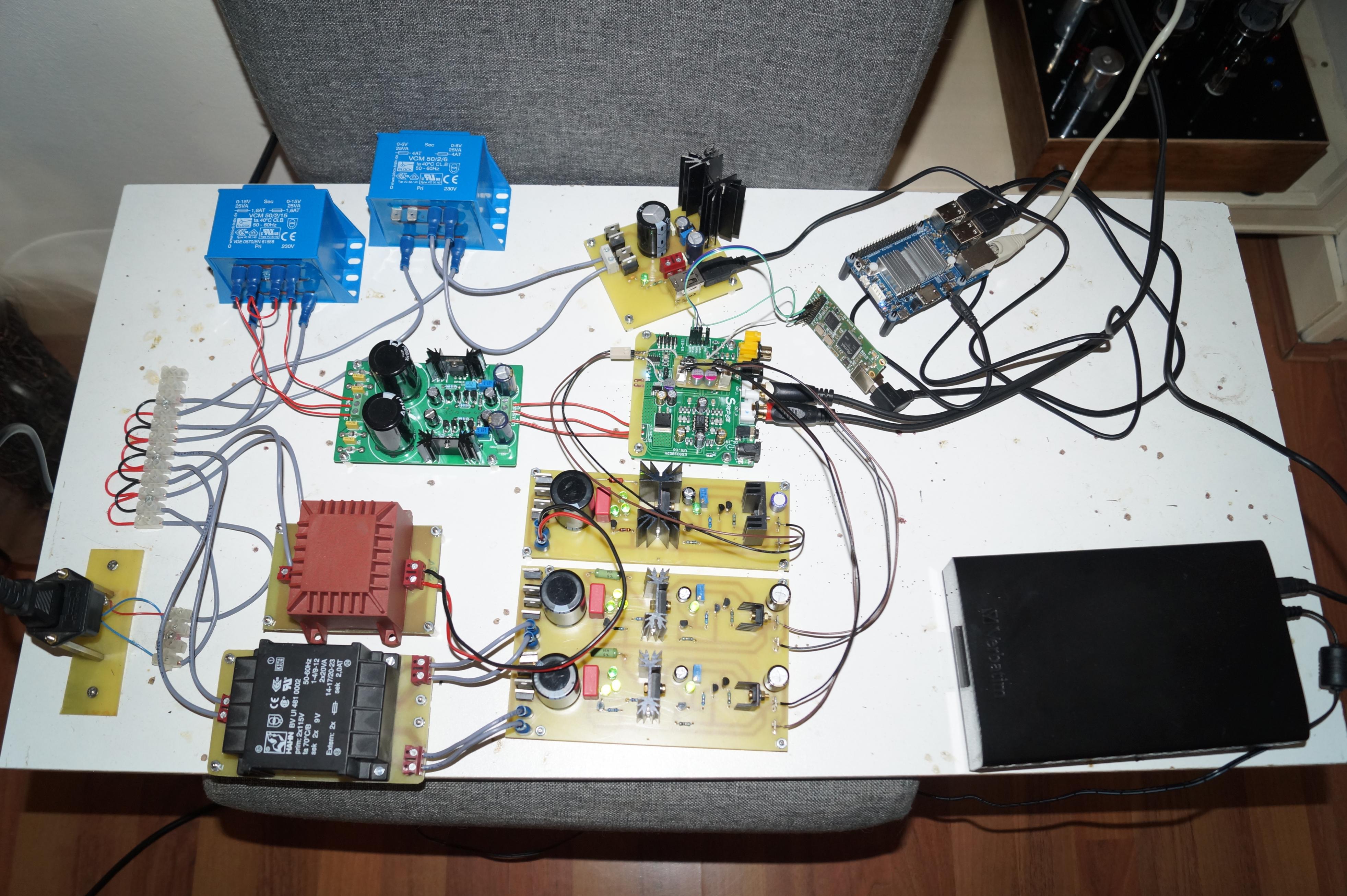

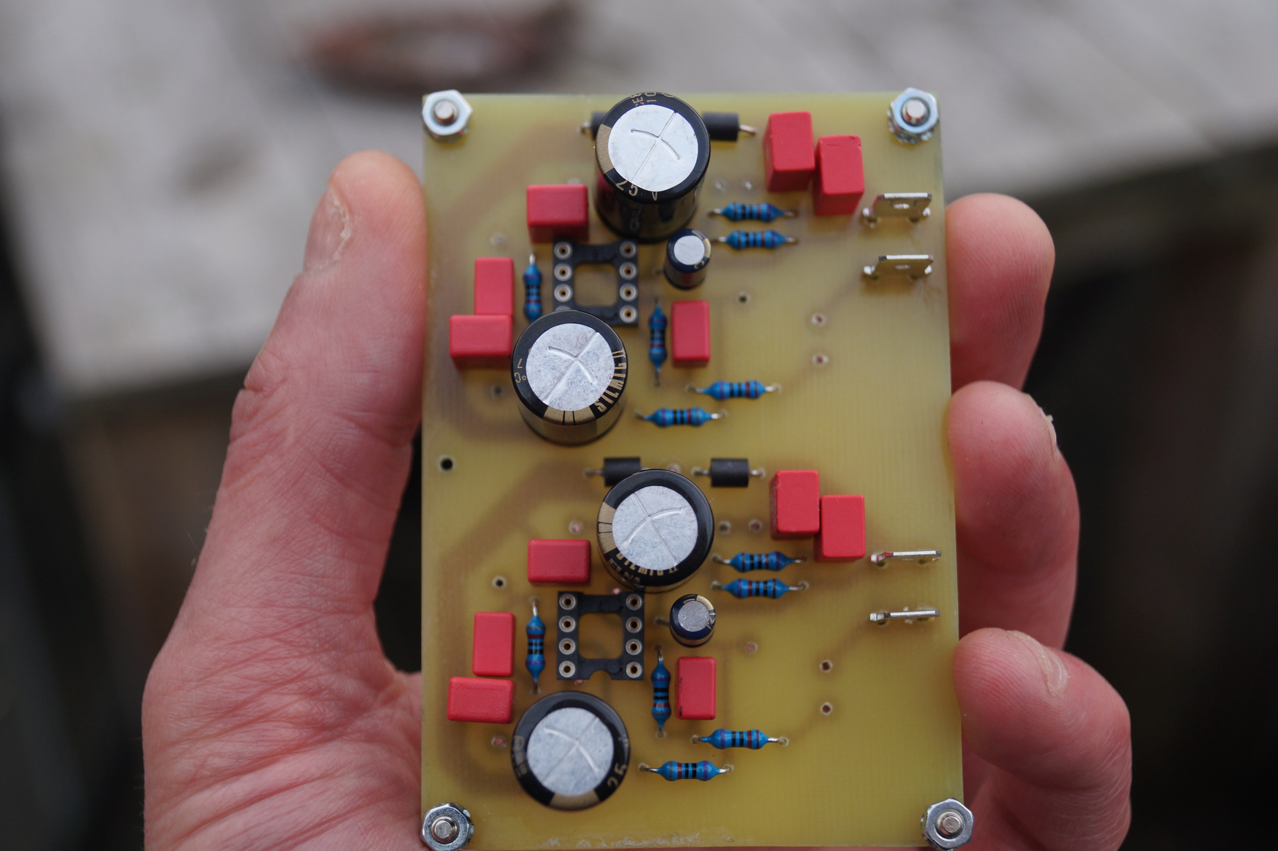

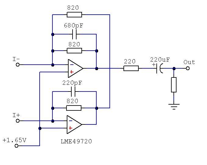

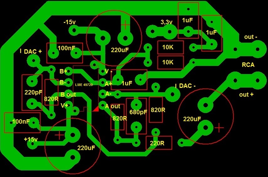

Look wat i dit.
I put in 3 Salas 3,3v shunt,s.
But the biggest improvement came from giving the dac a lot of uF on the
AVCC supply,s.
It went from harsh narrow soundstage to big roomfilling with the biggest base
that wil blow you away.
I am not even thinking about putting in an other opamp,great sound!

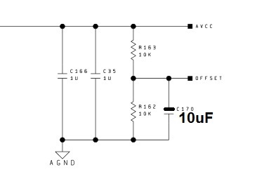

@Democles, I have no Salas Regs. Would adding the caps still give the improvement without the Salas? You used .33F supercaps, what is the value of the other (electrolytic? in parallel?) caps? Thanks.
Not Democles, but IIRC, Victor said he added three 1800uf capacitors in parallel with each of the existing AVCC caps. He soldered them onto the existing caps at their terminals on the back side of the circuit board. He also designed his own opamp IV stages and posted the schematic in another thread. The schematic is copied to a fairly recent post by me in this thread, within maybe the past week. His measured performance was very, very good.
actually Victor did that for a different board - ES9018k2m :
DVCC - without changes. AVCC has 3 x 1800uF capacitors in parallel with the onboard tantalum capacitor.
tantalum one was 10uF. i do not know how much different ES9038q2m analog part is.
i believe shunt regulators are not supposed to have so huge capacitance in front of them. this was somehow discussed in one of the ES9018 threads regarding Trident regulators.
in general it is not so clear for me what is the principal advantage of discrete shunt/serial regulators over integral LDO regulators for AVCC. most likely not the noise value. current flow handling then?
I don,t know.
Did the mods all together.
Adding more uF to the AVCC (2x) gives the sound a lot more room and base performens.
The sound of my bord is stil changing.
I have to give it some time.
The cap,s in parallel are 180uF,but by adding the 0,33F supercaps les might be
better.
But giving the AVCC its own 5v supply,s is a good thing.
I used Salas supply but I think any low noise wil do the job.
I have put a Sallas on the clock supply but that gave no big inprovement.
So doing the 2 AVCC might be enough.
@Markw4 see post 514:)
Next step wil be adding a bord with the Victor scematic and hear if it brings something.

Personally, I am using an opamp regulator for AVCC as ESS recommended in the documentation on their downloads page. All opamps in my circuits are LME49720. Those opamps are virtually the same as the opamps used in Benchmark DAC-3, except for maximum voltage rating. A DAC-3 uses +-18v rails rather than +-15.

Therefore and in reference to my previous post, based on what I have found out and observed so far I am puzzled to find out that other people are reluctant to go ahead and use an opamp regulator for AVCC. It works well and you probably cannot do any better with other approaches in terms of the end result sound quality you can get if everything else I have mentioned is done as close to perfection as possible.
Also, since excellent sound quality results can be obtained with an opamp IV circuit, adding one more dual opamp to regulate AVCC doesn't seem like it should be a big deal. It's pretty easy to do and then you don't have to worry about whether your AVCC power is good enough or not.
