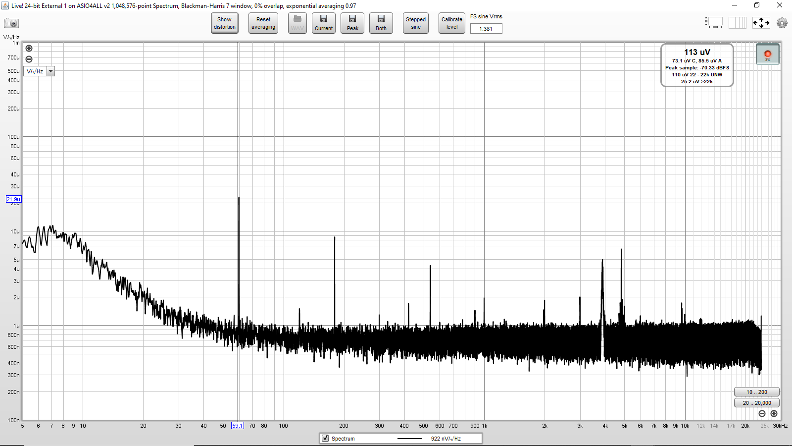

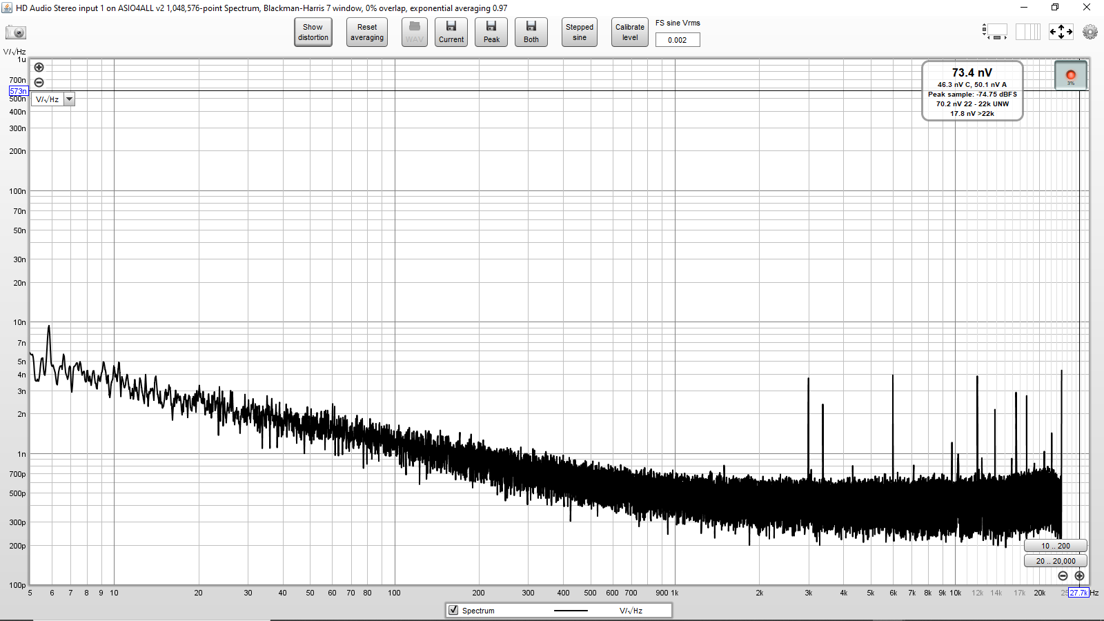

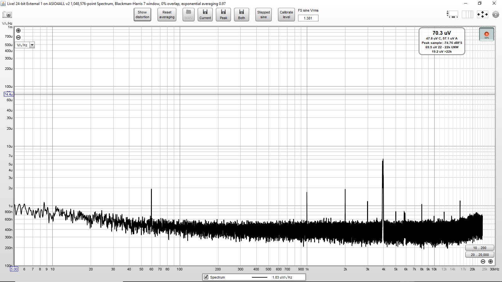

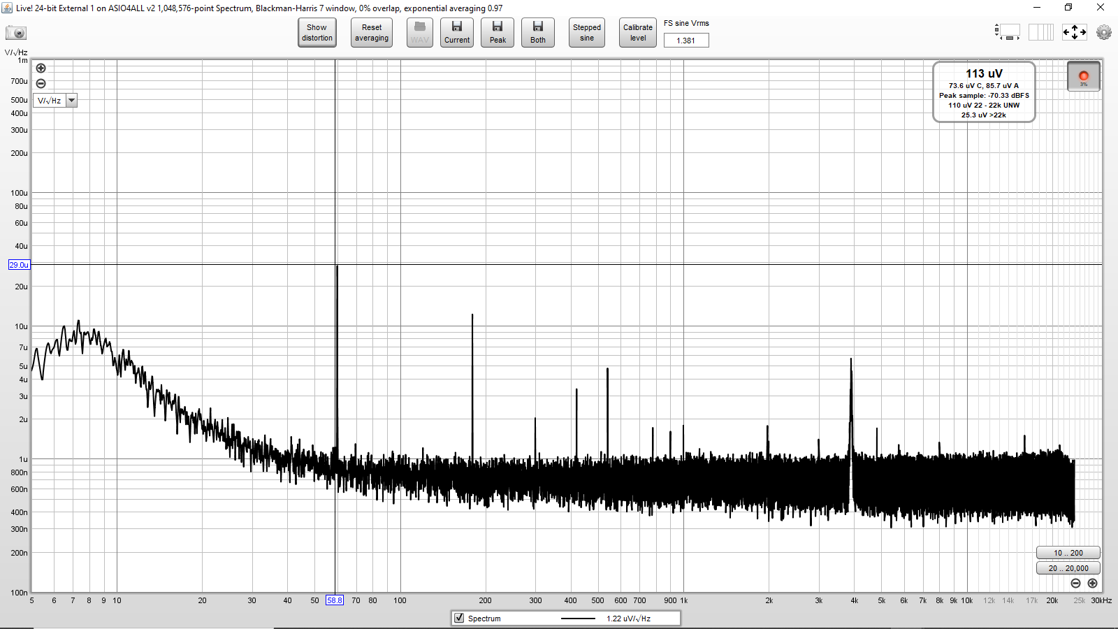

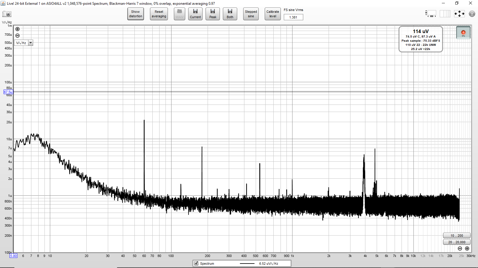

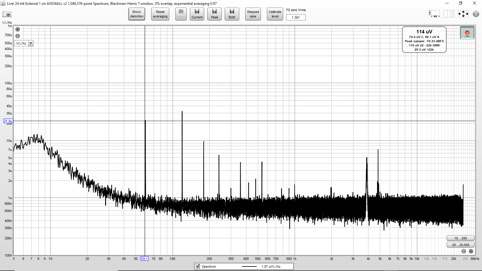

I think we have found it.
In this experiment the first picture is with the external USB audio interface "Sound Blaster Live! 24 Bit SB0490". Note the 60Hz & 180Hz.
The second picture is with the internal REALTEK sound interface that is built into the laptop. The 60Hz & 180Hz is gone. (However it is traded for some high frequency spurs that we at least now know are nothing to do with the LNA.)
Note that the levels shown are at the output of the LNA with 60 dB gain. So input levels are 1000 times smaller than shown.
[The other experiment where I placed the SB0490 inside the shielding changed nothing.]
  • LNA OPA228 Input Referred Acer Aspire Realtek 60 dB Gain Inside Cookie Tin Inside Heavy Stainles.png
  • LNA OPA228 60 dB Gain Inside Cookie Tin Inside Heavy Stainless Pot LNA Ground To Pot.png
bohrok2610; said:
Is the second picture with the LNA switched on? The "perfectly normal ubiquitous 1/f noise" is strangely gone. Have you checked the frequency response of the Realtek?

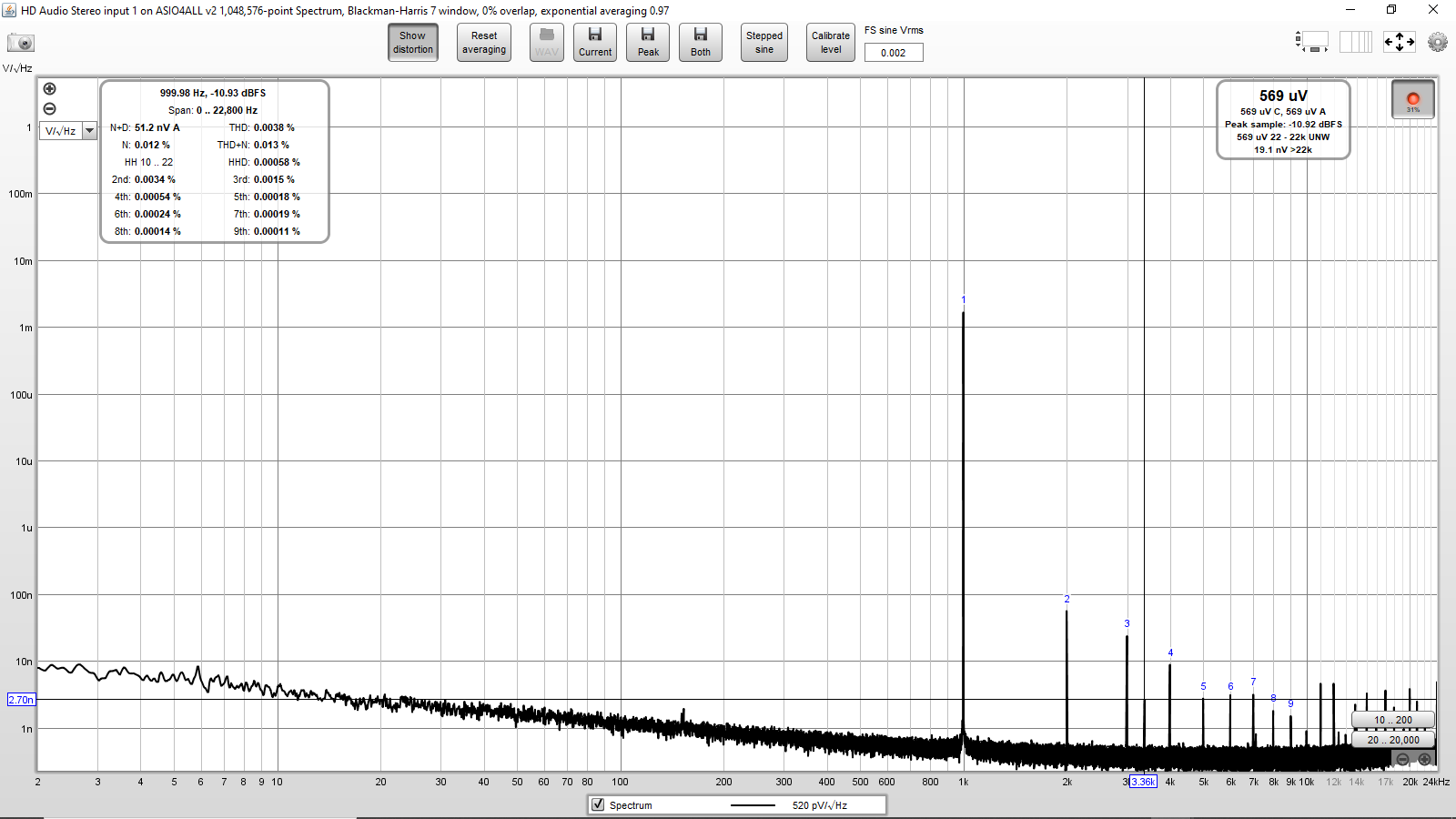

The LNA is switch on. For example, see the image attached to this reply where I use the REALTEK and a 60 dB attenuator to supply the LNA with a 1kHz test signal.
Perhaps the strange LF response came from the SB0490 and is gone now that I am using the REALTEK? I could make a loopback frequency response check of the REALTEK.
With this example (using the 60 dB attenuator to make a test signal) do the results look respectable enough to do noise tests on the ES9038Q2M and AK4396 power supplies? (These results display input levels. There is a 60 dB attenuator after the generator and the LNA has 60 dB of gain.)
In the future I would like to get a better interface but for now I hope that the LNA with the REALTEK will be sufficient. In the future I can also look at getting EMI filters and better transformers.

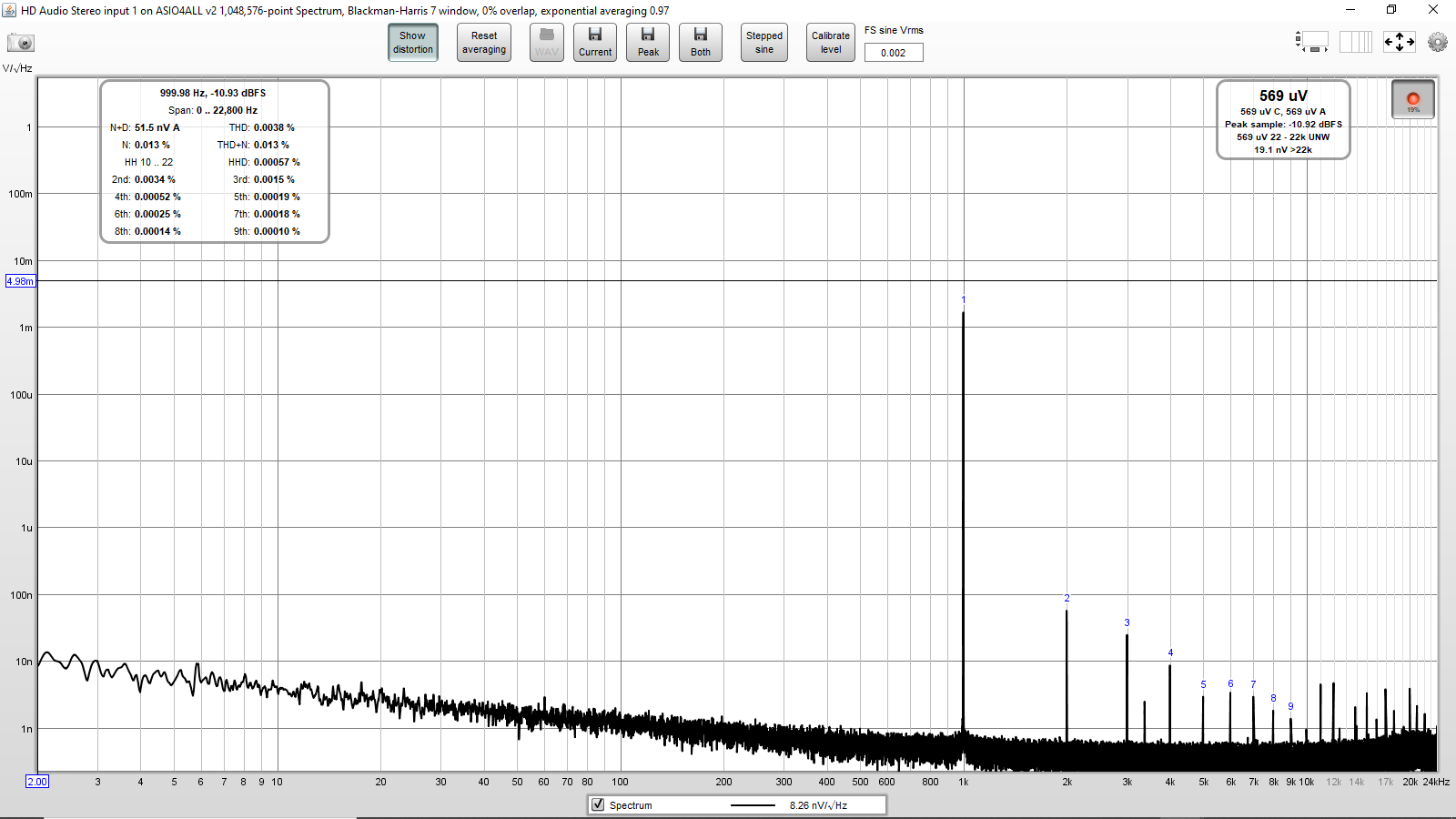

I have repeated a series of measurements/checks.

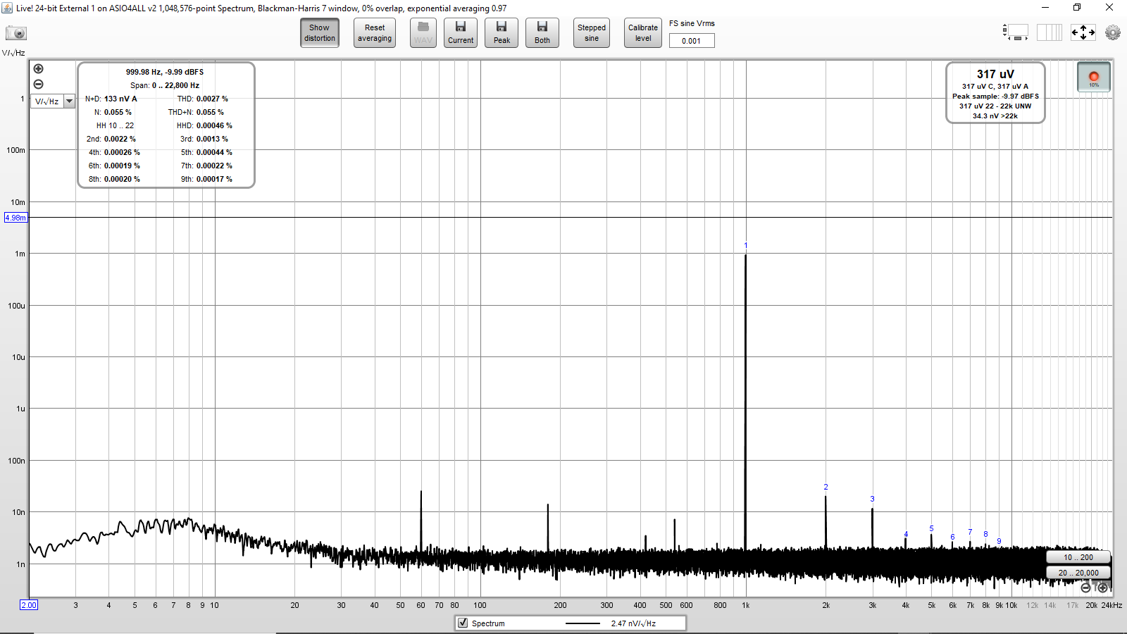

The first screen shot enclosed is: SB0490 Output 1kHz Sine Generator to 60 dB Attenuator to 60 dB LNA to SB0490 Input
The second screen shot enclosed is: REALTEK Output 1kHz Sine Generator to 60 dB Attenuator to 60 dB LNA to REALTEK Input

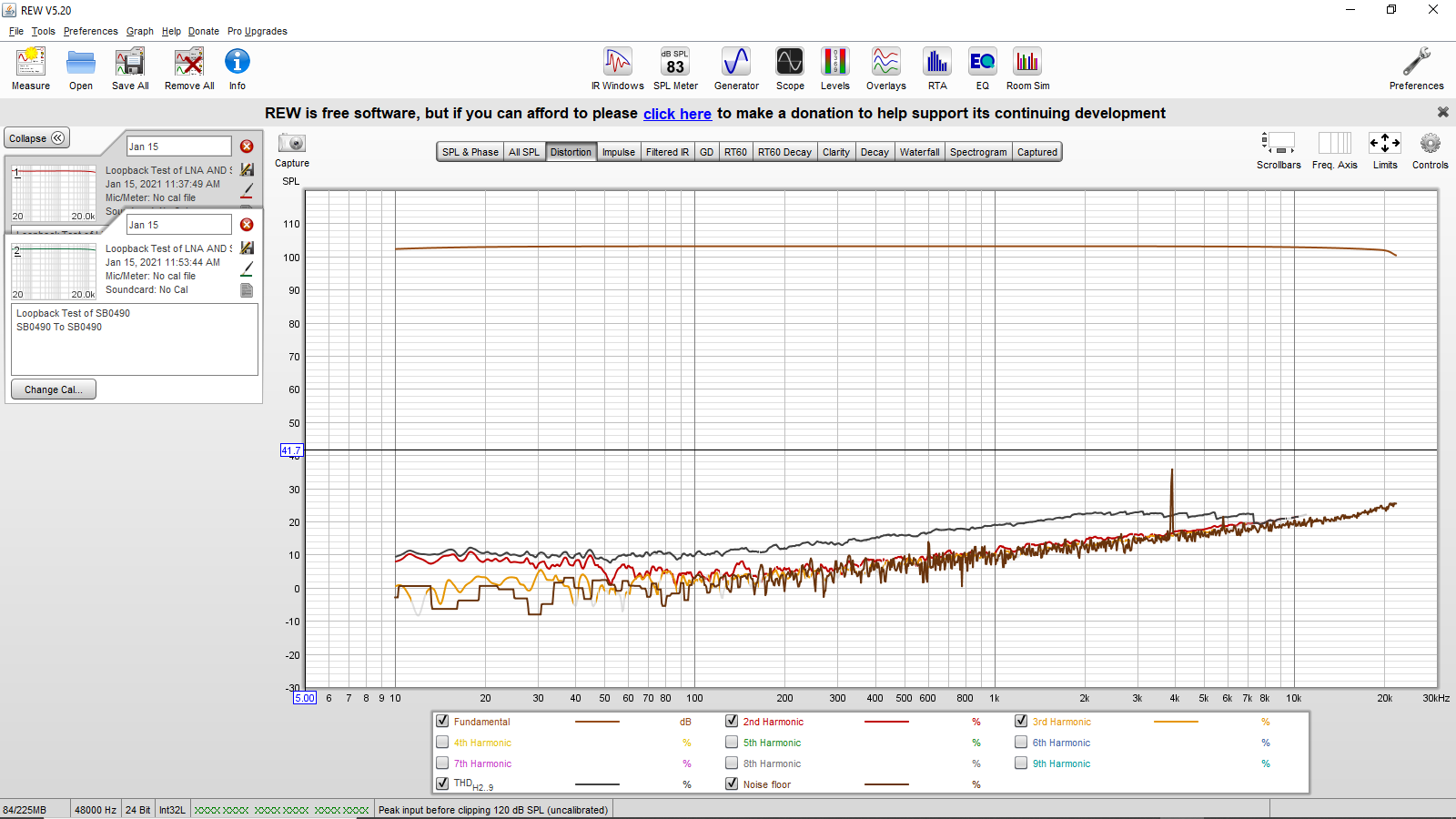

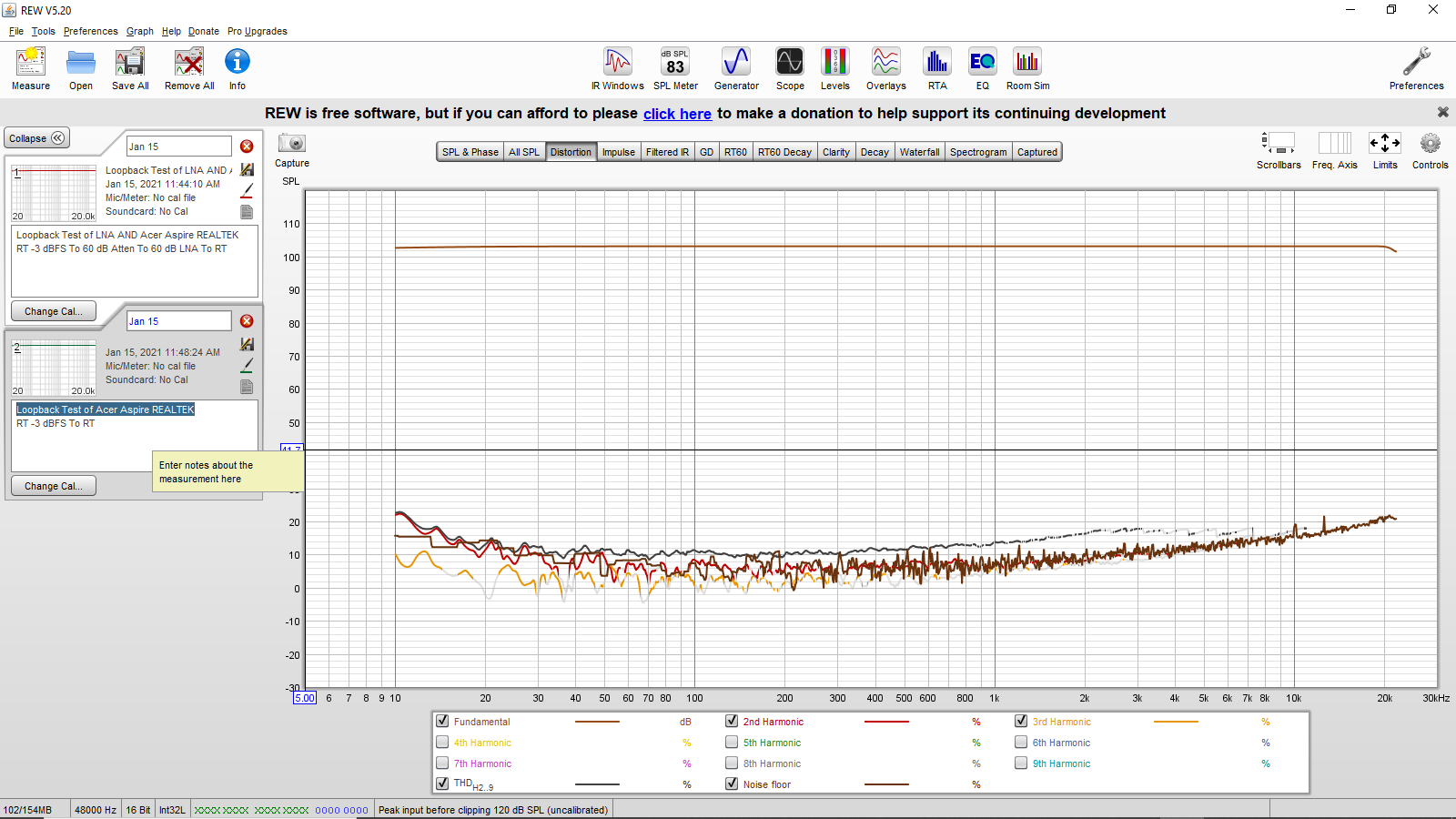

Based on the second picture in post #6485 the higher 1/f noise comes from the LNA. You should see that even with Realtek.

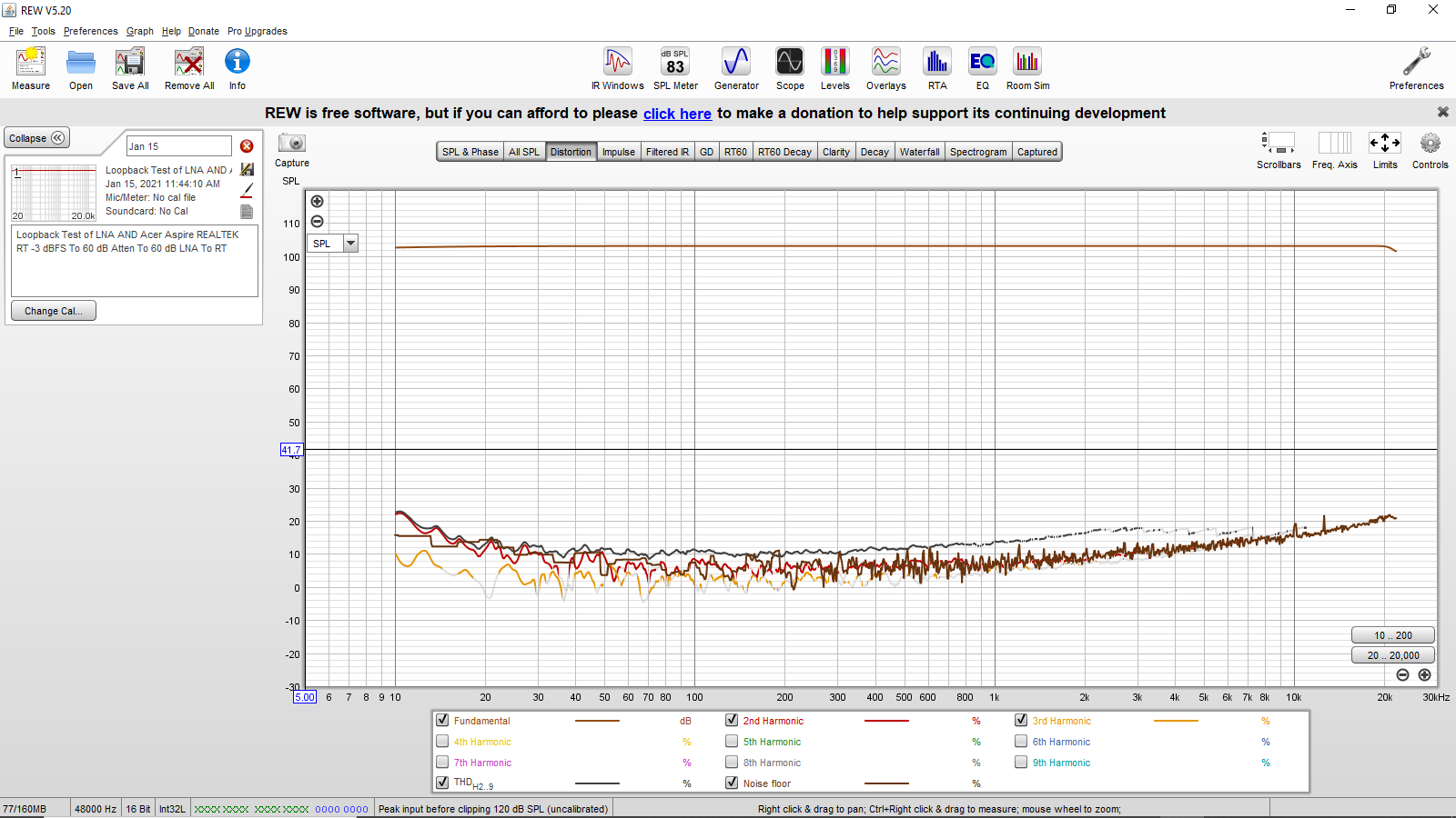

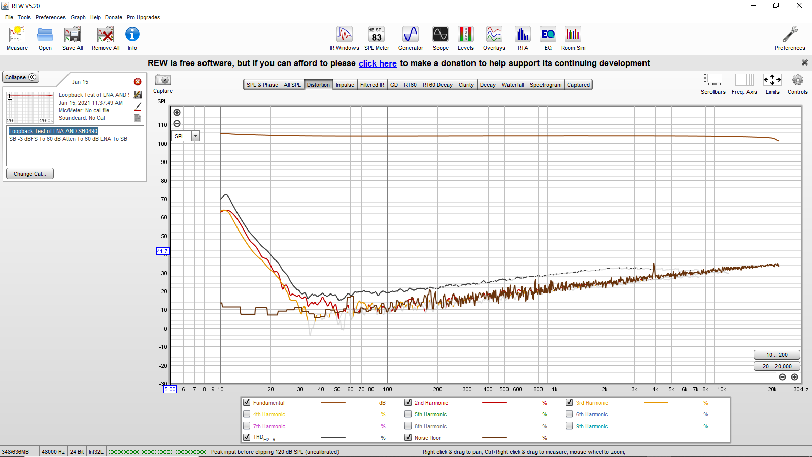

The first screen shot attached shows a loopback test of SB0490 to 60 dB Attenuator To 60 dB LNA back to SB0490.
The second screen shot attached shows a loopback test of REALTEK to 60 dB Attenuator To 60 dB LNA back to REALTEK.
