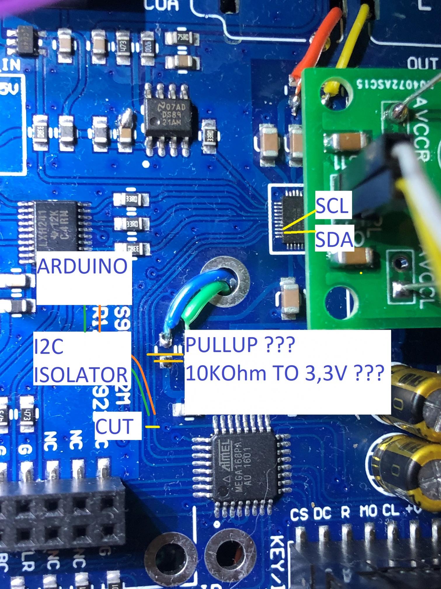

Daniel,
The Amtel MCU absolutely does need the pullup resistors in order for I2C bus to work. The resistors are part of the bus and the bus will not work without them.
Also, it doesn't sense to ask if the MCU is always high. The MCU has many pins on the outside and many other parts inside. Each little thing can be at logic-high state or logic-low state at any instant in time. The state of each little part may or may not change millions of times per second.
In addition, devices like Amtel MCUs may be designed so that the function of some of its pins is programmable. The pin may be an analog input, a digital input, a digital output, have an internal pullup resistor or not, etc. Depends on how it is programmed. When a pin of the MCU is to be used for I2C bus, then that pin will be programmed to act as an input and as an (open-drain) output. If you want to understand more than what I can type in a few sentences, then you have some reading to do on your own. After you read some, then you may have more questions. If so, fine to ask them here. To get you started, you might check out: The I2C Bus: Hardware Implementation Details - Technical Articles
...And or: How I2C Hardware Works - I2C Bus
EDIT: In the picture you posted you did not follow the I2C lines from the dac chip correctly. One of the traces you labeled goes down through a via and does not go to the dac chip. Also, I2C pullup resistors could be 10k, although 4.7k might be a more commonly used value.
If you cut the traces going to the dac, the there need to be pullup resistors on side of the bus that goes to the dac chip. If the MCU sees that there are no pullup resistors connected to it, it will probably assume the I2C bus is temporarily busy and just wait for it to come back.
EDIT 2: Looking at your pic more closely, it looks like you did not find pullup resistors on the I2C bus. Remember above when I said the MCU pins can be programmed to have internal pullup resistors turned on? Well, that may be exactly what the dac designer decided to do in this case. If so, and you cut the traces, then the MCU will think I2C bus is not busy and it may think the dac chip is hung and try to reinitialize it or something. If you short the bus pins to ground in that case then the MCU might think the bus is busy.
I made an edit to your pic which I will attach. I marked the trace which you mislabeled. Also, I put little red X marks where I might cut the traces so there is a bit of room to work.

Thanks Mark,
I see my misstake now. I will cut the to traces that are to dac chip.
Not the one going to a via point.
I will connect pullups resistors to the point where i also connect cables. 4.7k to 3.3v.

Daniel,
Looking at your pic one more time, it kind of looks like that trace from the MCU that you mislabeled might actually go the reset pin on the dac chip. If so, the MCU can reset the dac chip at any time.
If the MCU loses communication with the dac chip, there is a possibility it will try to reset the dac. That could be a problem for what you are trying to do, so you might want to be prepared to check for that in case it does happen. However, it never was a problem with the MCUs on the older version dac boards. Depends how the new MCU is programmed.

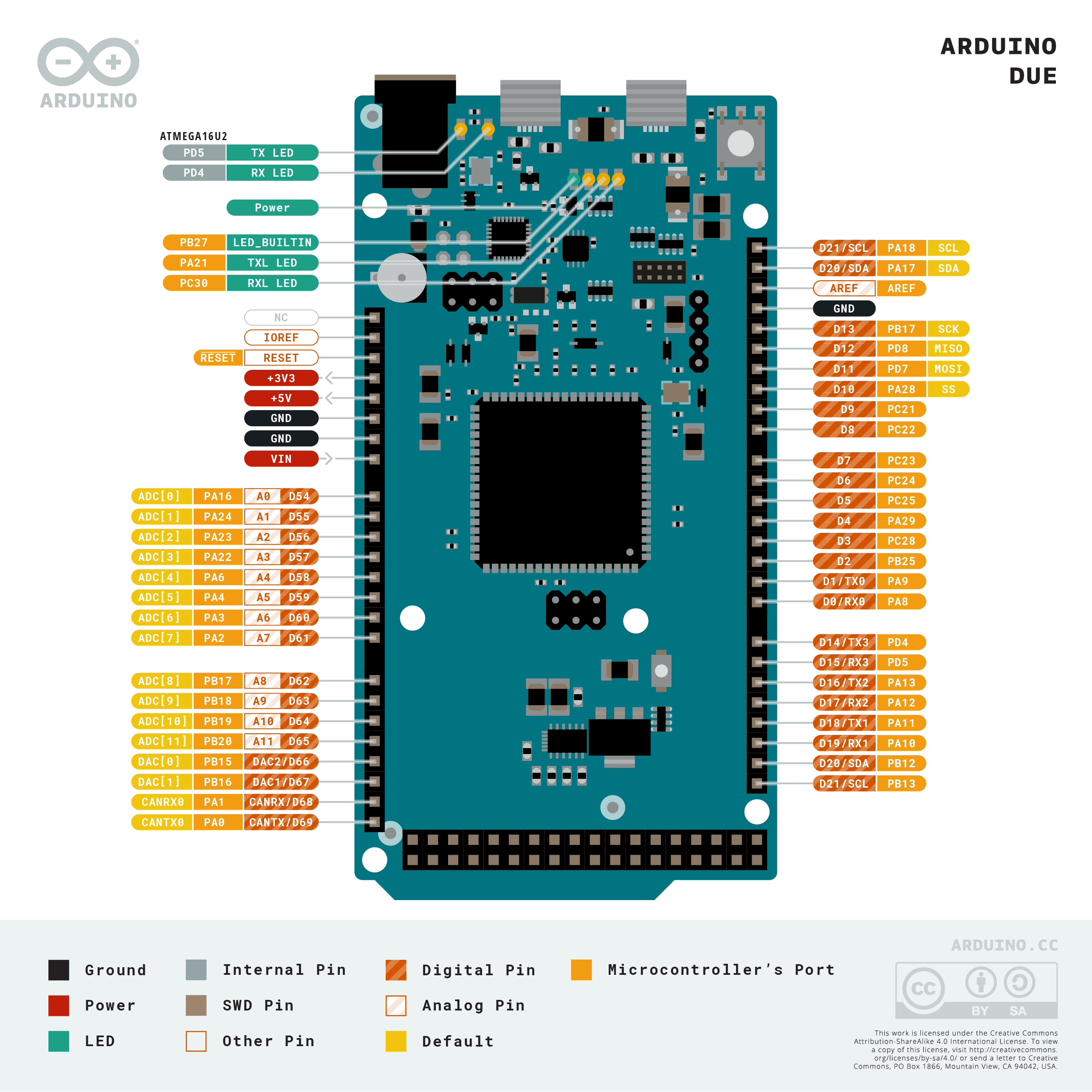

Hello Mark,
Yes i guess i done all that right. I have a library called SoftI2CMaster and i have installed it in portable mode.
I attached a picture of my Arduino.
In the bottom to the right i have to pins called SDA (D20 and PB12) and SCL (D21 and PB13). Is that something i should use?
BR// Daniel

Hi Daniel.
Looks like you have two sets of I2C pins, the other set being at PA17, PA18 (aka Port A pin17 and Port A pin 18, expressed in the form needed by the I2C library). We will have to read some more about your Arduino to see if one I2C set of pins should be preferred over the other.
...a bit later: Okay, some info about Arduino DUE I2C pins at: Arduino - Wire
Also, general info about the board is available at: Arduino Due | Arduino Official Store ...by clicking on the 'Documentation' tab.
A note about I2C libraries: The default I2C library for Arduino is called Wire. I used the alternate library called SoftI2CMaster because it has some features not available in the Wire library.
After reading at the above links, it looks like you could try using either set of I2C pins just so long as you edit the Arduino program to set the correct port and pin designators for the I2C pins you choose to use. They will probably need external pullup resistors, although if the line in the program that reads:
