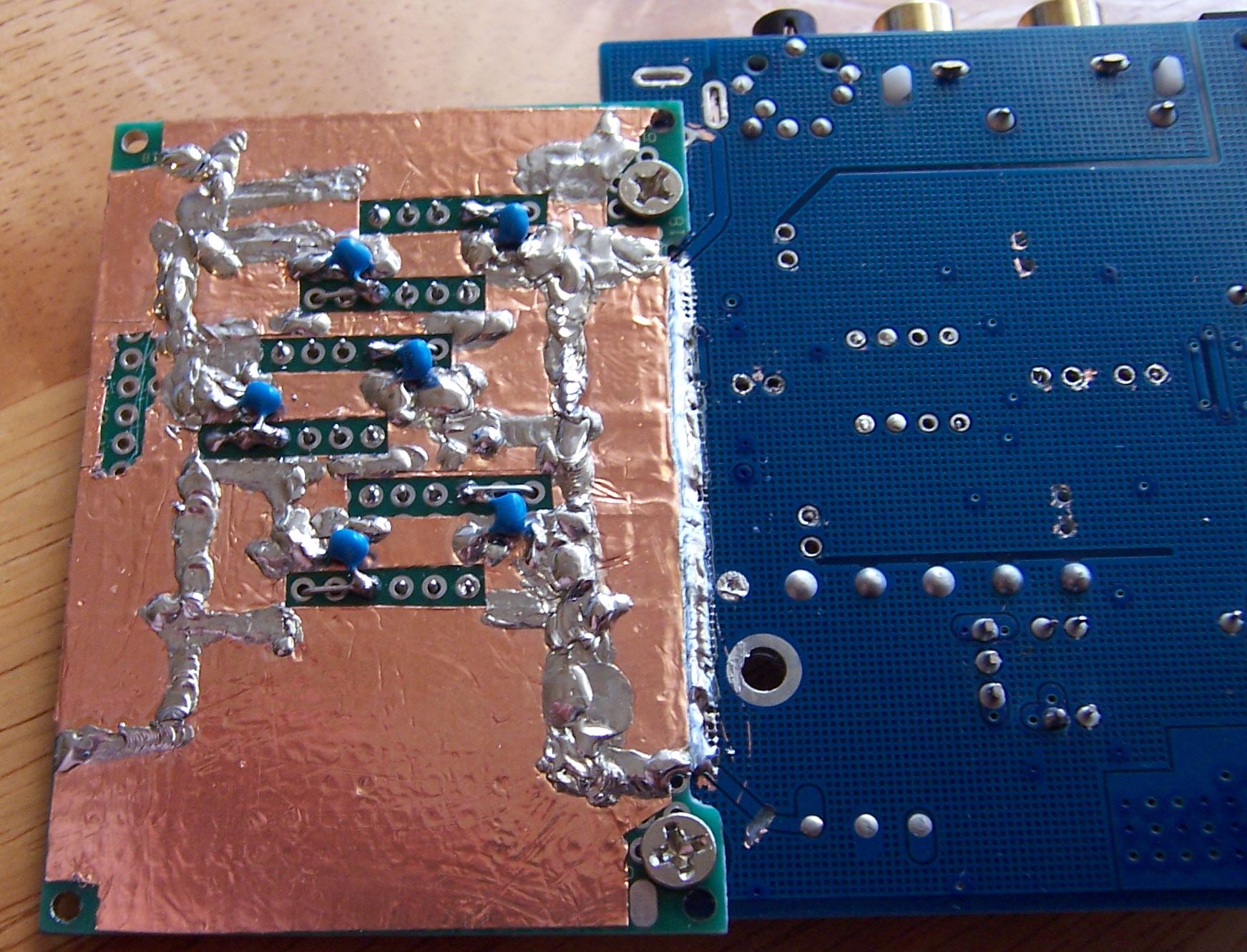

A good, continuous ground plane would be a very good idea. The ground plane of the output stage board should be directly attached to the ground plane of the dac board. Did you take a look at how I did that for the through-hole output stage design I made at request of some forum members? Also, if you carefully read what ESS has to say about output stage opamps in relation to the dac chip, its about the same as what I did. Many people fail to study the pertinent information: http://www.esstech.com/files/4514/4095/4306/Application_Note_Component_Selection_and_PCB_Layout.pdf

There is no virus in the through hole download, nothing executable at all. Your antivirus program is reporting a false positive if anything.
Its just a zip file mainly with an .rtf file that can be read with Wordpad or any number of other programs. It contains text and pictures of my output stage project in various stages of completion.
One of the pics showing how the two ground planes are attached can be seen below below.
