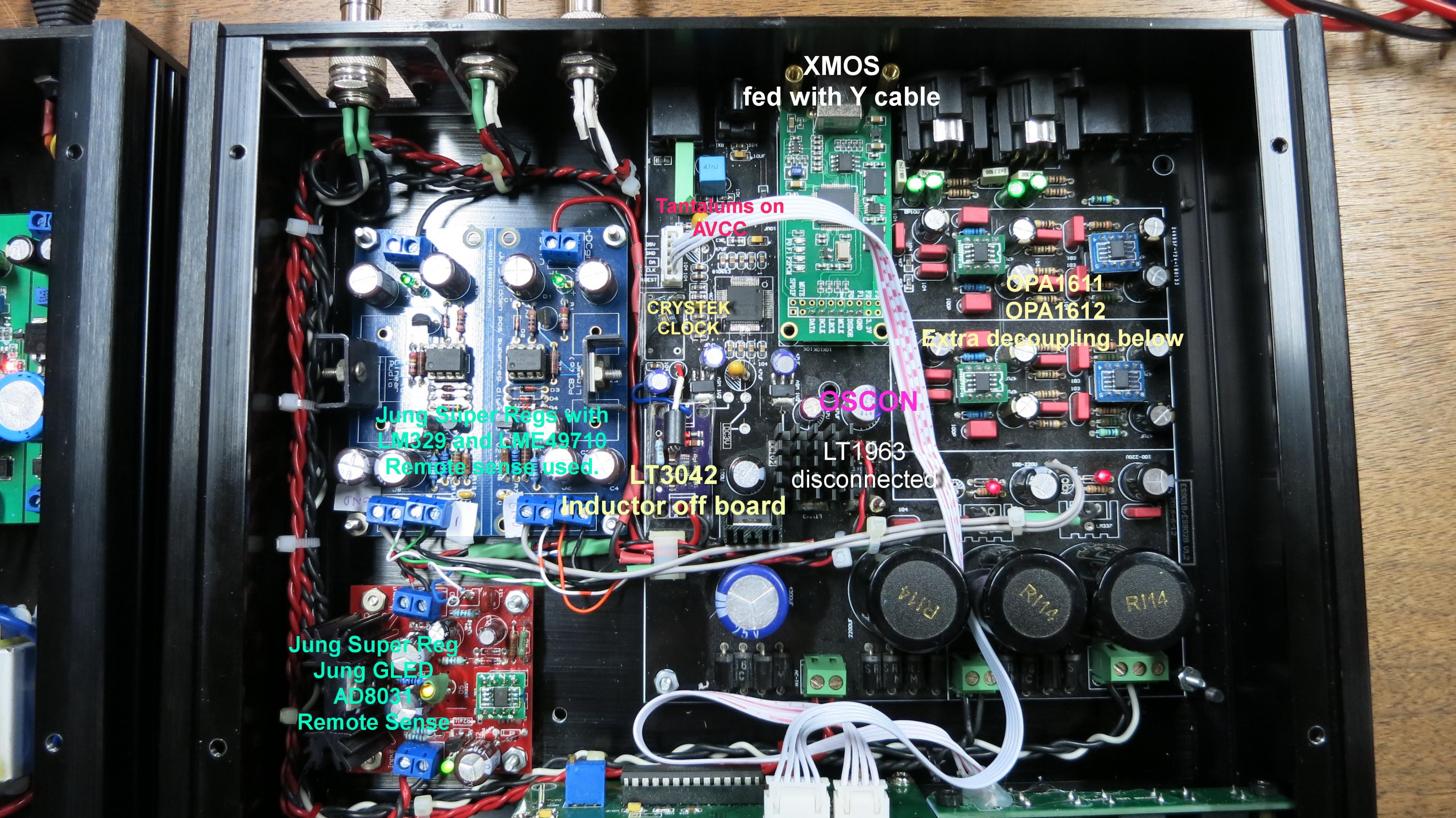

Thanks Mark,
Reason for asking was that i had a power board with low noise at +/- 9v.
I guess i can try it and compare with my 12 v 78xx board.
BR// Daniel
BR// Daniel
Daniel,
That sounds like a plan. Please let us know what you find, if anything.
Also, if it were me I would want to improve the sound of that board. One of the steps in that process involves separating the opamp power from the digital power. Your +-12v supply would probably be great for the opamp circuitry. On the other hand, a low noise +9v supply might be good for feeding the local 3.3v regulators that provide stable power for the clock, DVCC, and VCCA. That leaves AVCC, which is a tough one to get get right. We usually prefer to power it with opamp buffers and a low noise +3.3v reference. Its one of the first and most important things to talk about in more detail if you decide you want to improve dac sound quality.
Thanks,
Yes i was thinking about try to seperate the powerlines.
Is it that easy to cut the trace from the 7808 and feed something like 9v there?
I also have some two leftover 3,3v low noise regulator.
Maybe i can use them? But not sure where. I will use optical in so maybe some improvment there?

Yes, something like that. Best to keep wires from the power supplies to the dac board pretty short.
I used three 3.3v low noise regulators mounted on the back side of the dac board (ground plane side). One regulator for DVCC, one for VCCA, and one for the clock. The MCU can stay on the original 3.3v regulator that's already on the board.
Optical tends to be pretty jittery. Best to try to use good quality optical cable and keep it short, if possible.

The dac board comes with a one opamp voltage mode output stage design. It is *much* higher distortion than a proper 3-opamp current mode output stage design. The output stage and the AVCC power supply are two of the very biggest sound quality improvements that can be made. However, its some diy work to make it happen. Schematics for recommended output stage and AVCC supply are attached to post #3003.
A through hole output stage project with construction pictures is available at: Dropbox - Output Stage Instructions.zip - Simplify your life

Thanks for the helpful info. I will try to use my regulators to DVCC and clock.
Regarding the current output ##3003, it looks a little bit complicated for me 🙂
BR// Daniel
Regarding the output stage, I agree its its not the easiest thing to build. It probably would have been considerably easier if using SMD components, but some people didn't think they would be able to take on soldering things that small. Could be there is some 3rd party output stage that could be adapted, but can't think of one offhand.

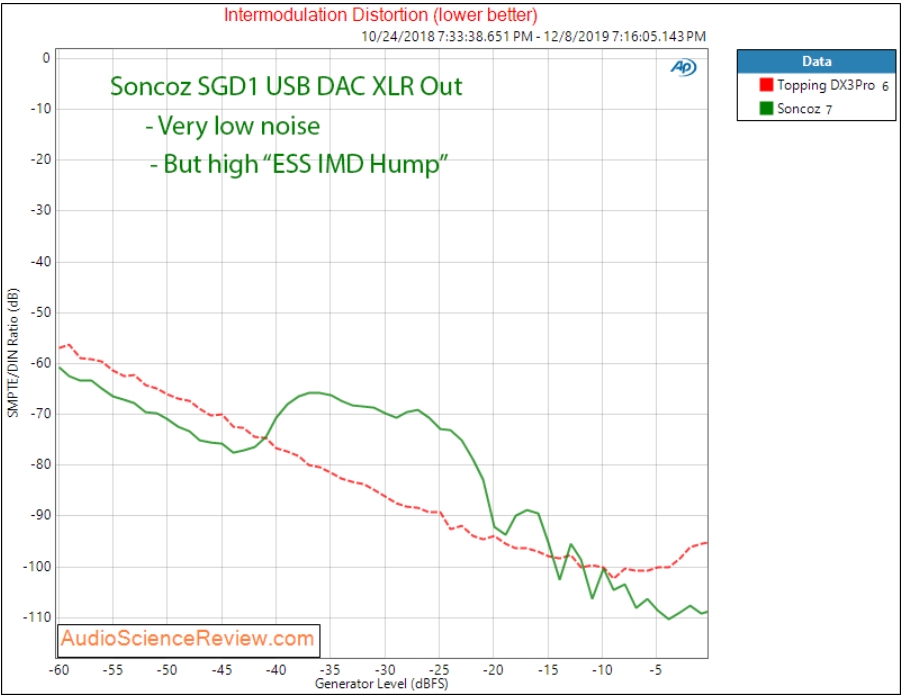

Sure, I'm using a PSU modified Soncoz SGD1. Same designer as for the Khadas toneboard. The designer solved the issue of the ESS linearity hump by correcting the opamp feedback capacitance/loading issue. It uses 2 X ESS 90382QM and fully balanced OPA1612 and RT 6863 Opamps for IV, supplied from separate regulators and transformer. Sounds and measures excellent out of the $470 box. Easy to do supply mods and versatile inputs. Saw off my heavily supply modded Katana with ease.
John
John
Interesting. The review at ASR says it has a very high ESS hump:SONCOZ SGD1 Audio DAC Review | Audio Science Review (ASR) Forum
...was that fixed in a later revision?
Anyway, how would you propose to compare output stages? Get two of SGD1, remove the output stage from one, and substitute another output stage?
Yep, it was fixed earlier this year. There is a thread there detailing how it was done and the recalculation of the filter cap and resistor values. I can't afford a second unit so I'll make the modifications a listen to the differences over weeks and months to decide which I prefer. Short term and even double blind testing doesn't work for me. Lots of listening does.
