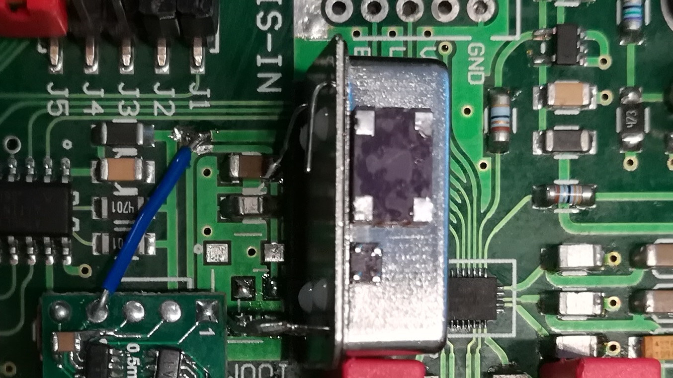

Thank you Mark, i thought similar but was not sure because past modifiers that swapped ordinary clocks to NDK but probbably in designs with no sample rate indicator.
I installed back 100mhz clock ...blah... couldn*t hear to music anymore. Sharp, harsh, light sounded... i luckily found one tcxo from audiogd but big size and installed it...very similar to ndk. It will stay inside for now. This dac is just for playing in this times that all world is stopped to do business.
Now sound has similar fuller character as Ian stack with dual es9038q2m.

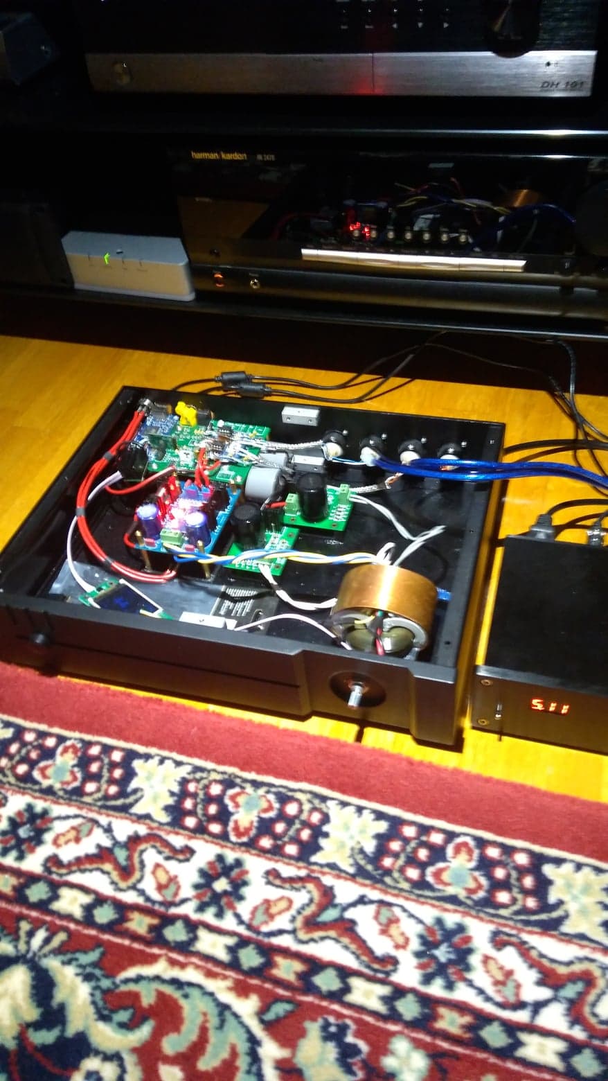

Anyone got some recent pictures of their progress?

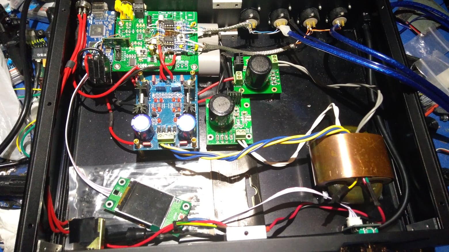

I finally got mine to work with no distortions or problems 🙂. It sounds holografic compared to my previous dac and the sound signature matches my speakers very well. The new R-transformer didn't come with a shield so I added a copper shield around it. I don't know if it makes any difference though^^. I also skipped star ground since there is very few ground loops because of the multiple psus and it didn't prevent hum in the previous configuration. The new R-transformer goes into dual Lt3042 5v into Lt3042 3.3v/liFe and into AVCC. The +-15V ac line goes into Walt Jung regulator and into opamps. I still got slight hum but I think that is the temporary xlr to unbalenced connection(without summing opamps).
I still haven't got the new amp complete, so I had to jerry rig something into the old amplifier, so disregard the blue rca cable.. The housing for the screen also need some coats of paints before I can complete the build.
I measured the LiFePo4 batteries today and they had only dropped 0.05V on two weeks. They are permanently connected to the AVCC, and standby discharge doesn't seem to be a problem.
