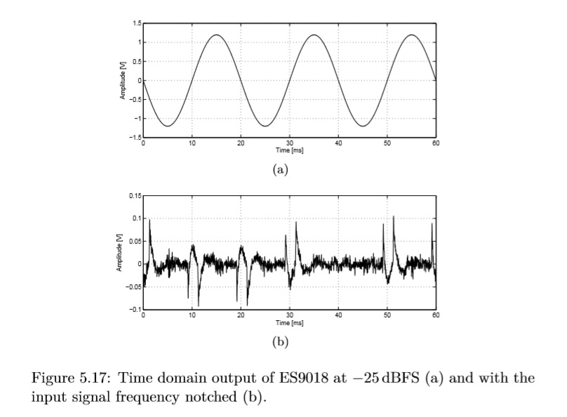

While all that was going on, in another thread here Scott Wurcer revealed that at some point ESS asked him to confidentially take a look at an ESS dac they sent him to see if he could find any problems (Scott is friends with ESS's VP of engineering). Scott said he found a few problems and expressed some concern that other people hadn't found them since he felt they were pretty basic. This apparently happened before the latest ESS chips came out. Maybe around ES9018(?), not sure.
Not too long after Scott posted about the above, in another thread he posted an image from a document ESS sent him that he said was old enough that it would probably okay with ESS to share. I will attach it below for reference.
Scott Wurcer later suggesting investigating the newer ESS dac distortion by running a sine wave through it at a low level, then running the analog output through a notch filter in order to take a look at the time domain distortion waveform. I think he may suspect that the same anomaly shown in the attached pic may account for present day hump distortion. If so, it is obviously an error inside the dac chip, since it is too random in occurrence to be caused primarily by the I/V opamp.
In anther forum thread John Westlake, a well known commercial dac designer opined that he suspects the characteristic sort-of-unnatural sound of ESS dacs is probably due to something in the modulator (not a direct quote, but words to that effect IIRC).
Hopefully, that's enough history on the subject to satisfy curiosity.
Bottom line for me: Move on to AK4499. Its a better dac chip, IMHO.

This explains the excessive brightness of this DAC.
Some of it, perhaps not all of it. Sometimes these dacs have multiple problems. Only way to know for sure seems to be to fix each problem one by one until the dac sounds good to you. For me with ES9038Q2M that was very difficult, among other things only DSD ever sounded to my liking.
