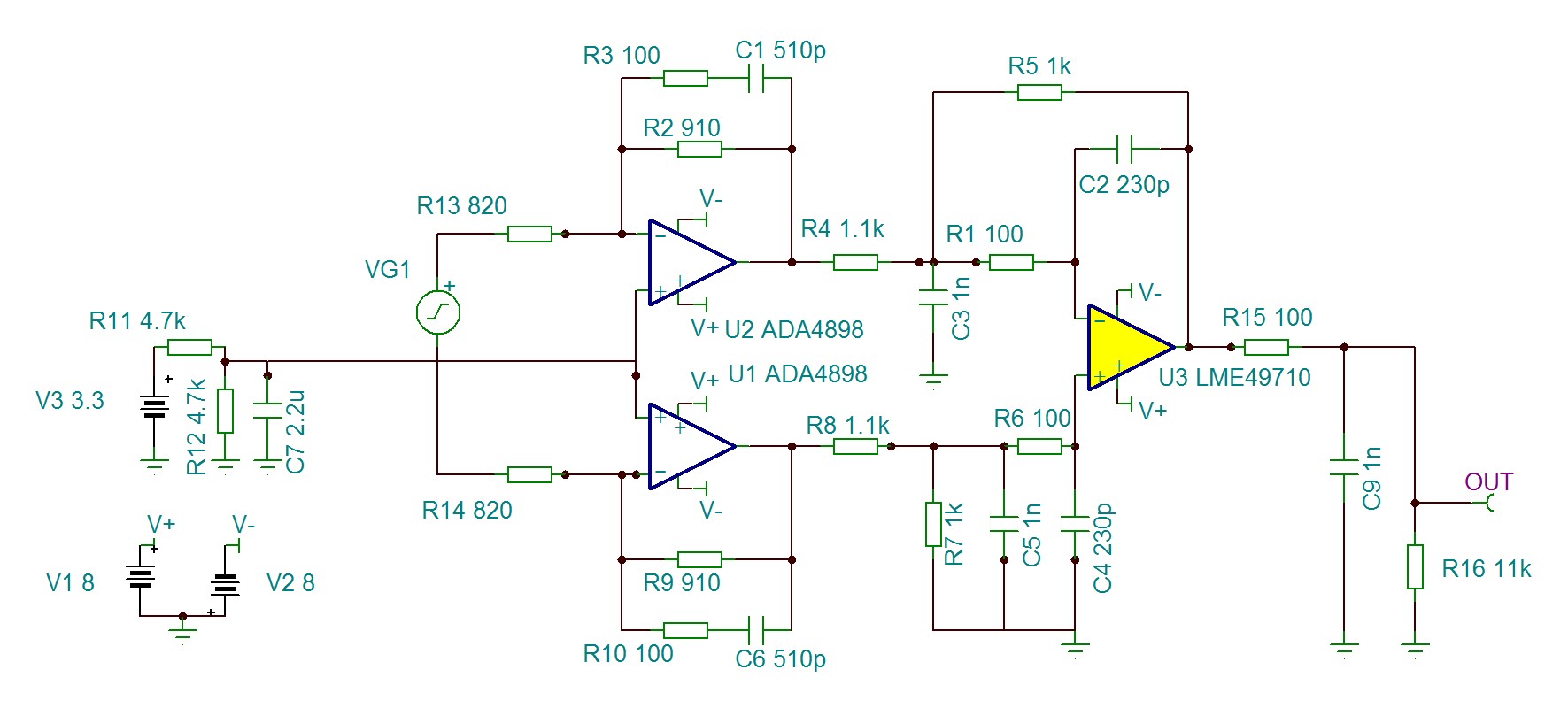

What do you think about this I/V stage ?
IMHO, it has some problems. Presumably you know Ian reports using transformers instead of the output stage you ask about. Using transformer I/V with Sabre dacs is very hard for me to understand since it makes distortion so very much worse.
Regarding the output stage itself, it is based on a standard 3-opamp design. AVCC Vref for left and right channels are tied together in the output stage, and in the dac it was designed for, which audibly reduces stereo separation.
The output stage is designed to use an OPA1622 in the differential summing position, with the OPA1622 mounted on a DIP-8 adapter. The opamp choice and the choice to mount it on an 8-pin adapter are both mistakes IMHO. The opamp is really for driving low-power headphones with low distortion, not the best choice for output stage differential summing. Also, it is a 10-pin device that needs a reference pin tied to ground for lowest distortion. An 8-pin dip adapter can't ground the pin properly.
Since there is a dip socket for the differential summing opamp it is possible to use another opamp instead, but the resistor values around the differential summing opamp are too low for other opamps besides OPA1622. The resistors were optimized for lowest noise, not for lowest distortion or nor for good compatibility with more suitable opamps such as OPA1612. Wish it were otherwise.
In short: Sorry, but not recommended.

Is it the last Schematic for the output stage ?
You could use that one, which I did, or you might want to use the parts values in the schematic below which is said to be of a Topping D-10. Same basic idea but filter values are a bit different.

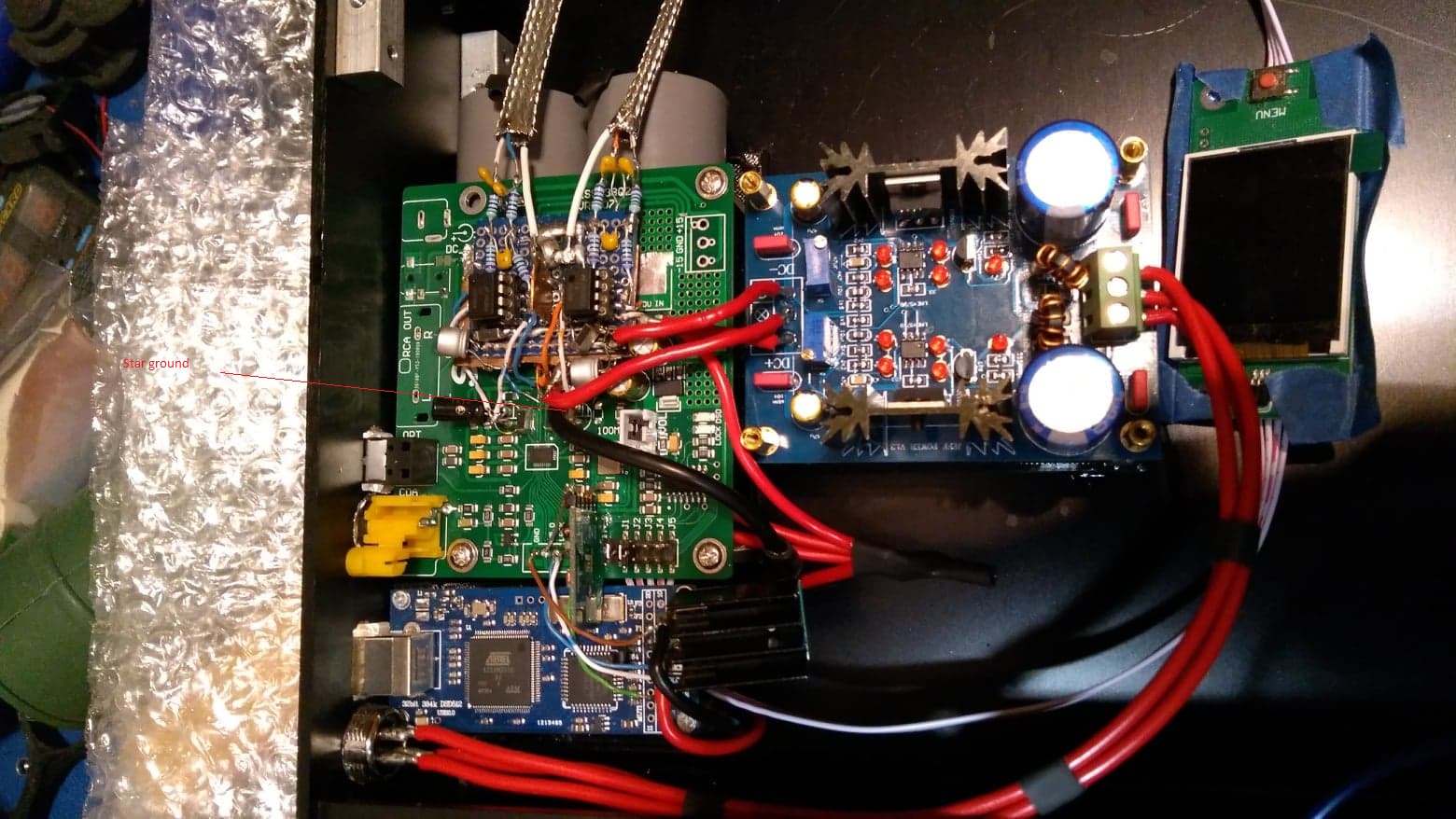

Finally got the dac to work with a new board! (First board were slightly defective.) That is also the reason some of the wires is somewhat melted since I've had to solder some of the parts several times. I belive in super short wiring so 2 LT3045 in placed right under the pcb together with 2 LiFePo4 32700 batteries(dual mono supply). Whole dac is powered by three outboard linear regulated supplies. One +-15V, the 5V supplies shares casing, but still a proper cable spaghetti:confused:
I've only listened to it for 6 hours but the sound is holografic with depth that I've haven't had before. So for now I'm very happy with it working and didn't let the magic smoke out!
