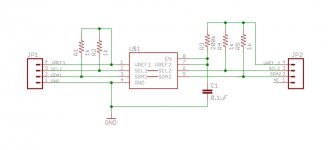

Hi Mark,
The Sparkfun Level Translator Breakout I used has 1k bypass(pull-up?) resistor on i2c lines. Do we need additional pullup on the dac board?

Hi Kay,
No, those shouldn't be needed. The existing 4.7k resistors on the board are probably plenty of pullup. I think I would remove the 1k resistors on the dac side of the translator board myself.
Each pole of the DPDT relay is a switch having a 'common' (or pole) with two connection positions (the 'throws'). Each common (pole) goes to an I2C bus line going to the dac chip and pullup resistors. In the default condition, when the relay is powered off (called 'normal'), the dac chip I2C lines should connect through the relay normally-closed pins to the appropriate pins on the mcu. When the relay is powered on (energized) the normally-closed pins become open and the MCU will be disconnected. Since you have the translator, you there is no need to connect it through the relay although you could. If you wanted to connect the translator to the relay, you would connect its appropriate pins to the the normally-open (n.o.) pins on the relay. The relay would then disconnect the MCU when the relay is energized and connect the translator to the dac chip instead.
Because most 3.3v relays draw more current than an Arduino output pin can drive, it is necessary to use a transistor to help. If you Google something like 'use arduino to control relay' you should find explanations of ways to do it. If not, please let me know.

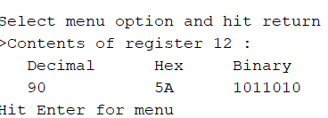

I succeeded lifting the MCU i2c pins. Also succeeded reading the register 12 (snapshot below). Did this direct without the sparkfun by connecting sda,scl & gnd directly to Arduino. Am guessing that sparkfun breakout connection is loose or not working.
The problem I have now is reading and eventually writing the register contents. The readout comes in decimal, hex & binary as shown. Now how do I translate them to the datasheet which does not seem to follow any of the types?

Hi Kay,
Congratulations on successfully lifting the pins! How hard was it?
Also, it is 2:30am here, I will have to write more later this morning. In the meantime, probably best to pull the I2C lines without powering off the dac or arduino. Either one can damage the other, more likely the dac can damage the arduino if one is powered off while the other one is on, due to possible over-voltage on unpowered pins.
Later, I can explain how to protect the chips, and how to understand the bit and byte notations used.

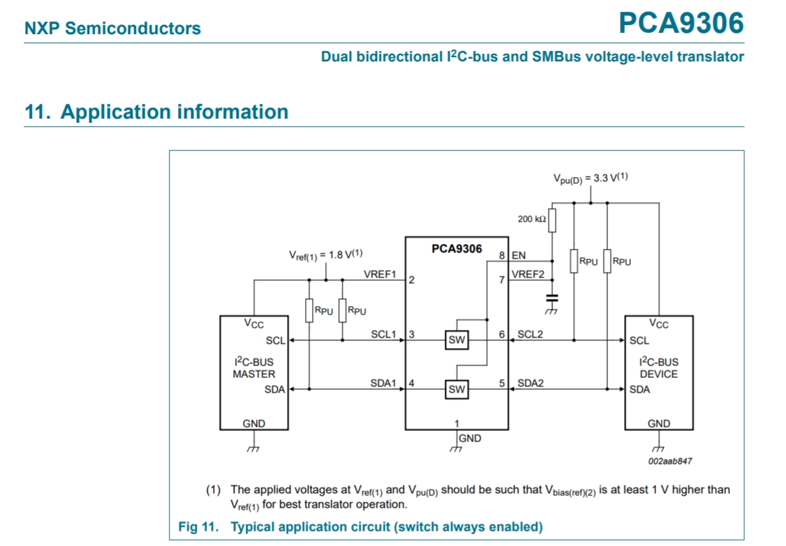

As I mentioned briefly last night, the risk of connecting a 5v arduino directly to the dac is that both connected chips are only safe when they are both powered on, or both off. If one is on and the other is off, then overvoltage can damage the one that is off.
First, maybe we can talk briefly about how the translator is supposed to work. JP2 is supposed to go to the higher voltage device, in the case that would be the 5v arduino board. JP2-4 powers the pullup resistors for that side, and so it should be connected to the Arduino 5v pin in order to power the translator. The dac chip connects to JP1. Looking at PCA9306 datasheet we can see that the JP1 side should also be connected to the local 3.3v power (the MCU 3.3v rail on the dac baord). The only difference is that you removed the pullup resistors on the dac side from the translator board because the dac board already has pullup resistors for that.
All that sound right?
If so, and the translator (PCA9306) is bad, then we need to think a little more about what else we might do for chip safety.
Since the dac board has the only pullup resistors, in theory the arduino can't pullup the dac pins when the dac is powered off. That is, unless perhaps the line in the I2C program that says:
#define I2C_PULLUP 0
were changed to make it equal to 1. In that case the arduino internal pullup resistors would be enabled on the I2C bus lines. Even if the pullups accidentally did get turned on, it still might be okay since the pullups in the arduino are in the range of 20k to 50k ohms (IIFC) and they would make a voltage divider with the dac chip pullup resistors. That would pull down the overvoltage on the dac pins, perhaps to a safe level.
The greater risk might be if dac board is turned on while the arduino is off. In that case dac pullups could overvoltage the arduino pins. I would use reverse connected schottkey rectifier diodes from each of the arduino I2C pins to the the arduino +5v pin. If the dac were turned on first, the schottky diodes would be biased on, and would clamp the I2C pins to less than .3v -.4v or so above arduino VCC. That should be enough to prevent catastrophic damage to the I2C pins.

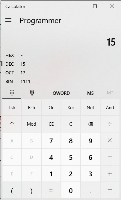

Hi Kay,
Data entry to the program is always in decimal, so you have to convert any bit pattern you want to write to a register to decimal format so it can be typed into the program. There is a built-in Windows Calculator that works great for that. You can set it to normal, scientific, or programmer modes. We use programmer mode. You can click on DEC, BIN, or HEX to set the data entry format you want to use. Any numbers entered into the calculator are displayed in all three formats.
In data sheets or sometimes in other documents or books, bits in a word may be described or referred to in style we don't see too often. ESS data sheets might be one example of that kind.
Lets say we see something like:
[7:5]
There are 8-bits in an I2C bus word and they are numbered from left to right starting with the most significant bit, Bit-7 to the least significant bit, Bit-0. The above notation refers to a group of bits ranging from bit-7 to bit-5.
We might also see something like:
4'd0
That type of terminology is seen in the Verilog language. The 4 means refers to a 4-bit vector (a combined group of 4-bits that are used together).
The d means the number that follows will be in decimal format.
The number after the d is the numerical value of the 4-bits.
For example, if we see:
4'd15
We have a group of 4-bits with a value of 15 expressed in decimal. Please see the Windows Calculator image below. If I click on DEC, data entry will be in decimal. If I enter 15 decimal, one can see that the binary bit pattern is 1111. That says 4'd15 represents a set of 4-bits with the pattern 1111, where the leftmost bit is the numerically most significant bit in that group. That pattern can also be represented in hex format by the letter F.
Moving along then, we can think of the 8-bits in an I2C register in different ways. The bits can represent a row of switches where a 1 would represent the switch being turned on, and a 0 indicating a switch is turned off. Or the bits could represent a number used for something. Maybe the bits in a register represent a row of status LEDs we can read out. It could be that some of the bits in a word are switches and other bits are used to represent numbers. Its up to the hardware designers to define the function of each bit.
As programmers, we treat bit patterns as numbers whatever they represent. We decide what switches we want turned on or off, find the 1 and 0 bit pattern for that, type it into the calc and it gives us the decimal number representing that bit pattern which we can type into the arduino program.
Hope the foregoing helps. If not, please let me know if I missed something, or didn't explain well enough.
