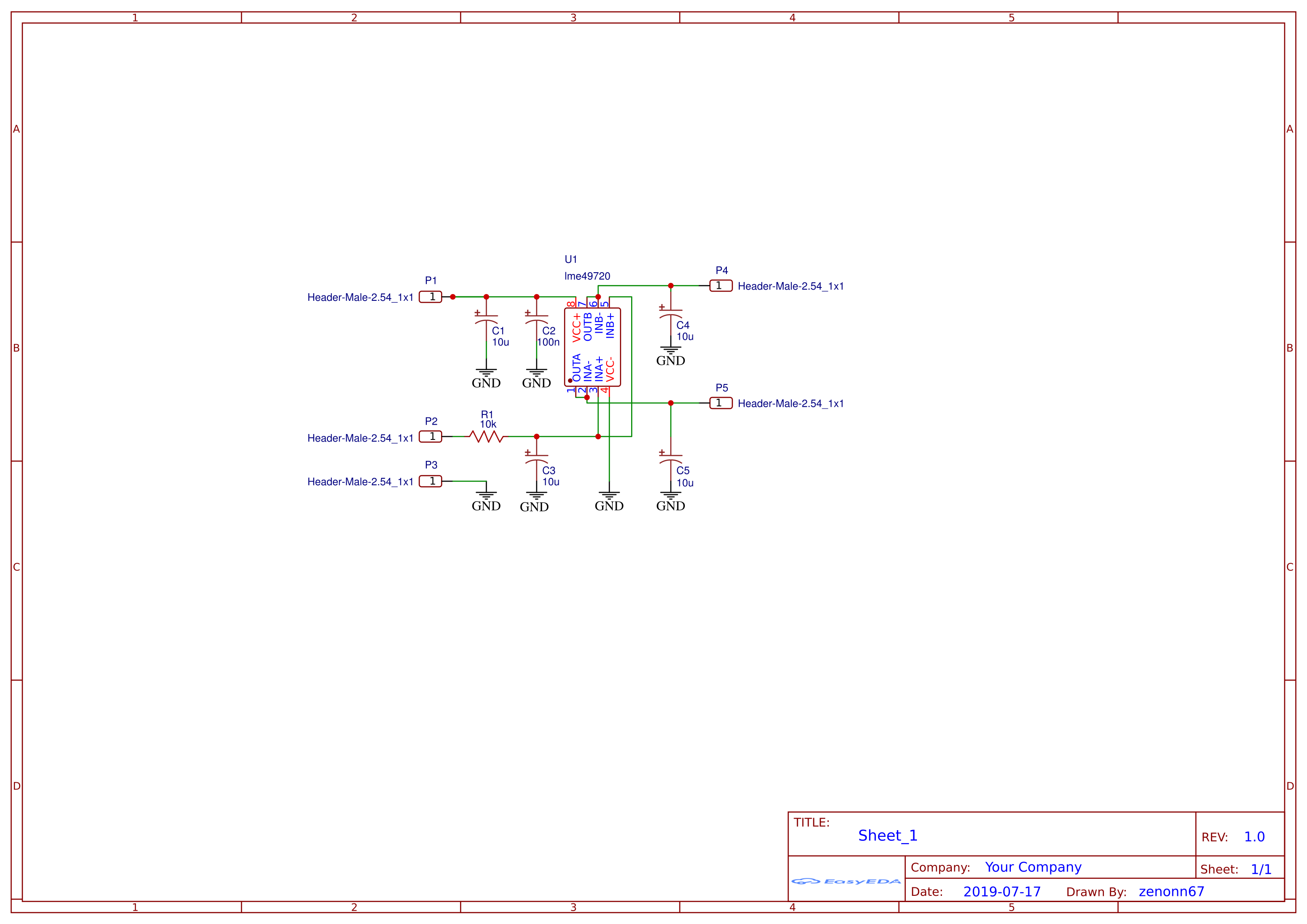

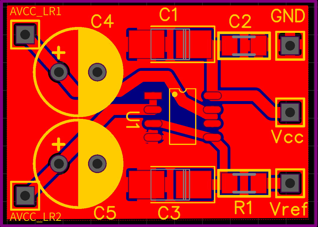

PCB (AVCC_LR)
*.json project files in zip.
