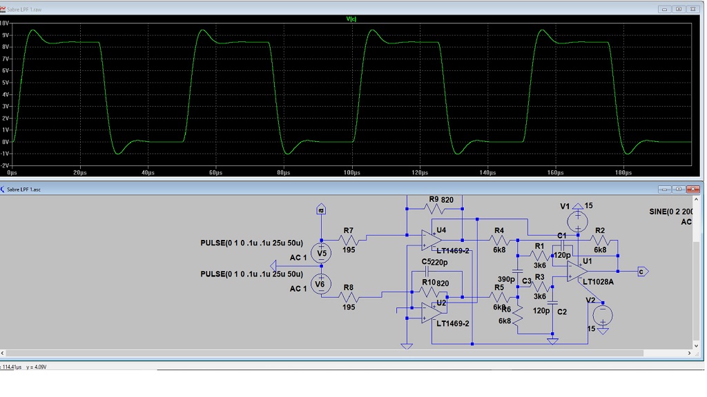

Hi Mark,
Is this the output stage that you recommend ? If I'm going to all of the trouble to build an output stage on vero board I might as well go all of the way to add a few more components. I haven't done this before so I want to make sure that I understand what's going on. Dac input is the + out from the dac channel and Dac B is the - out from the dac channel. The first two opamps are really the different halves of one double opamp like the lme 49720. The last opamp is a single opamp like a lme 49710. And the ground is the power ground. And I need to make one for each channel. So I'll need two double opamps and two singles (or another double to do both channels). Am I on the right track ?

Paul,
I simulated your OP stage / low pass filter and ran a 20kHz square wave
through it, check below.
It shows pretty bad transient response. This is because the LPF is not linear
phase. This will affect the sound adversely.
For a DAC like this with significant HF energy, I recommend a 3rd order,
Bessell or Gaussian low pass filter response which will have perfect square
wave with rounding and no overshoot.
Further to this, I would not use Vero board. Uae a solid copper covered piece
of board as a ground plane and mount everything, usually dead bug style.
You can do PS bypassing direct to GP and keep everything really optimum.
For the LPF values, download a free filter design program, the rest is easy.
If you guys are trying to get really high performance out of this DAC, best do
things properly.

Hi Terry,
It is a nominally 70 kHz Guassian LPF that we use (not the schematic you used there, and that Paul asked about), with component values reasonably close to desired. I believe Paul is now planning to build our current version. Aside from I/V cap value, the time constants are pretty much exactly the same as a DAC filter published years ago by Scott Wurcer. In addition, it sounds fine. I'm not going to worry about measuring and fine tweaking that part now, since there are bigger issues to take care of.
Regarding dead bug layout, what we use is as close as it is going to get with many components soldered directly to the ground plane. I was asked to do a through-hole component layout beginners could do. When I did my own first one I did it very differently, perhaps more like you are suggesting, but it scared too many people away from trying it. Dac mods are worthless in this case if nobody wants to build one. Hopefully, Paul and any other folks interested in modding the Chinese dac board will decide to go ahead with it as the downloadable how-to shows.

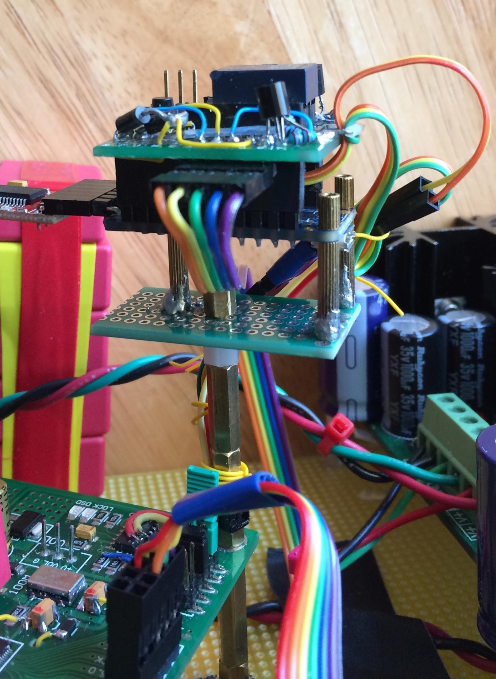

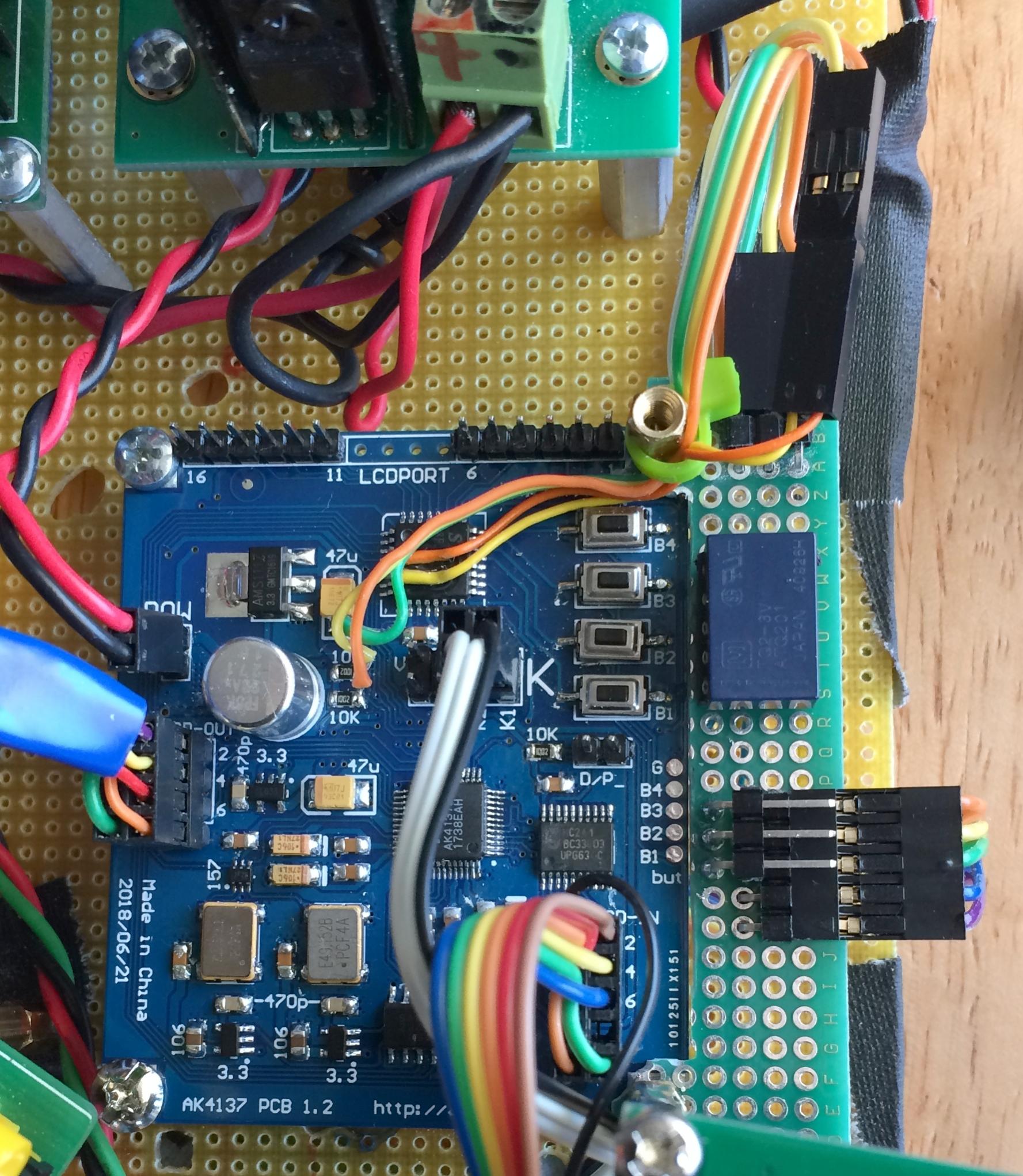

Getting closer to being ready to try AK4137 in DSD slave mode. Pics attached below.
It can be seen there is an extra 3-pin header on the AK4137 seizure relay board which is for monitoring AK4137 I2C bus. Plan is to use those header pins as test points to capture normal MCU control of AK chip using a cheapie $10 logic analyzer. The cheap little USB logic analyzers work fine for capturing and decoding I2C bus activity. However, it takes about a $700 USB logic analyzer for use with I2S bus. Big difference in speed between the two busses, and that's why I can only capture I2C bus.
