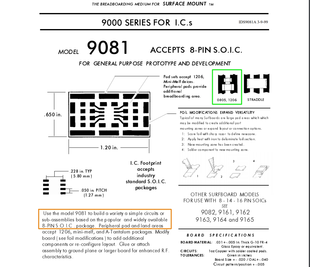

Regarding SMD sizes, thanks for pointing that out. Am I reading it right that the 9801 surfboard accepts 1206 and 0805? And you mentioned that ltc6655 and opa1612 are not the same size, that must mean soic8 and msop8 are different sizes?
I also wanted to try lt1763s you mentioned in other posts. Will the 9801 board fit them?

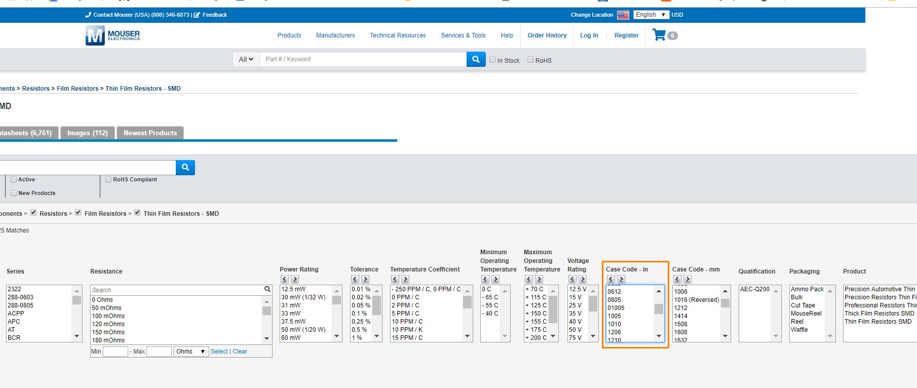

Hi Kay,
Those are the sizes of SMD parts (in .1 inch units and decimal point omitted, IIRC) that are the maximum and minimum it can accept given the pad sizes and the spacing between pads. If you look at the surfboard data sheet there is a diagram showing how they might fit. Please see attachments below.
The cases are a little different, but not necessarily enough not to fit on surfboard pads. If you google those part numbers and download the data sheets, there are size diagrams showing the dimensions (which you can use to check and see how they will fit).

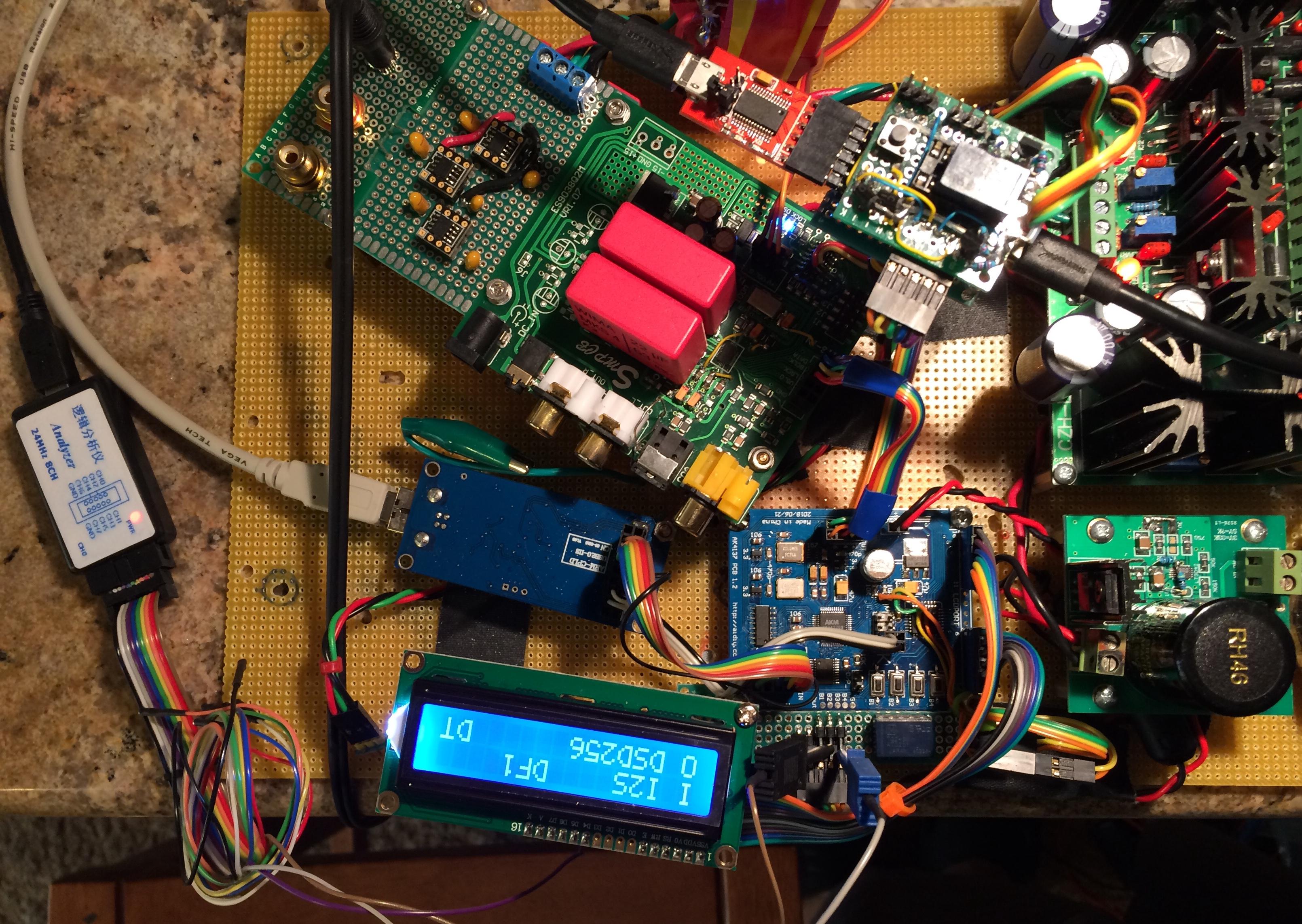

Test setup is configured to start working on AK4137 I2C programming. Captured its boot up sequence to the AK4137 I2C registers using the little cheapie logic analyzer in the pic below. Text file with decoded I2C is attached also if anyone cares to take a look and compare it with the AK4137 data sheet to see what its doing.
In the I2C capture file, the address of the AK chip is 0x20 which is seen associated with each bus transaction. The first write of each pair of writes is the register address to be accessed, with registers 0-5 being used here (a register 6 exists too). The second write in each pair is the register data to configure the chip.
