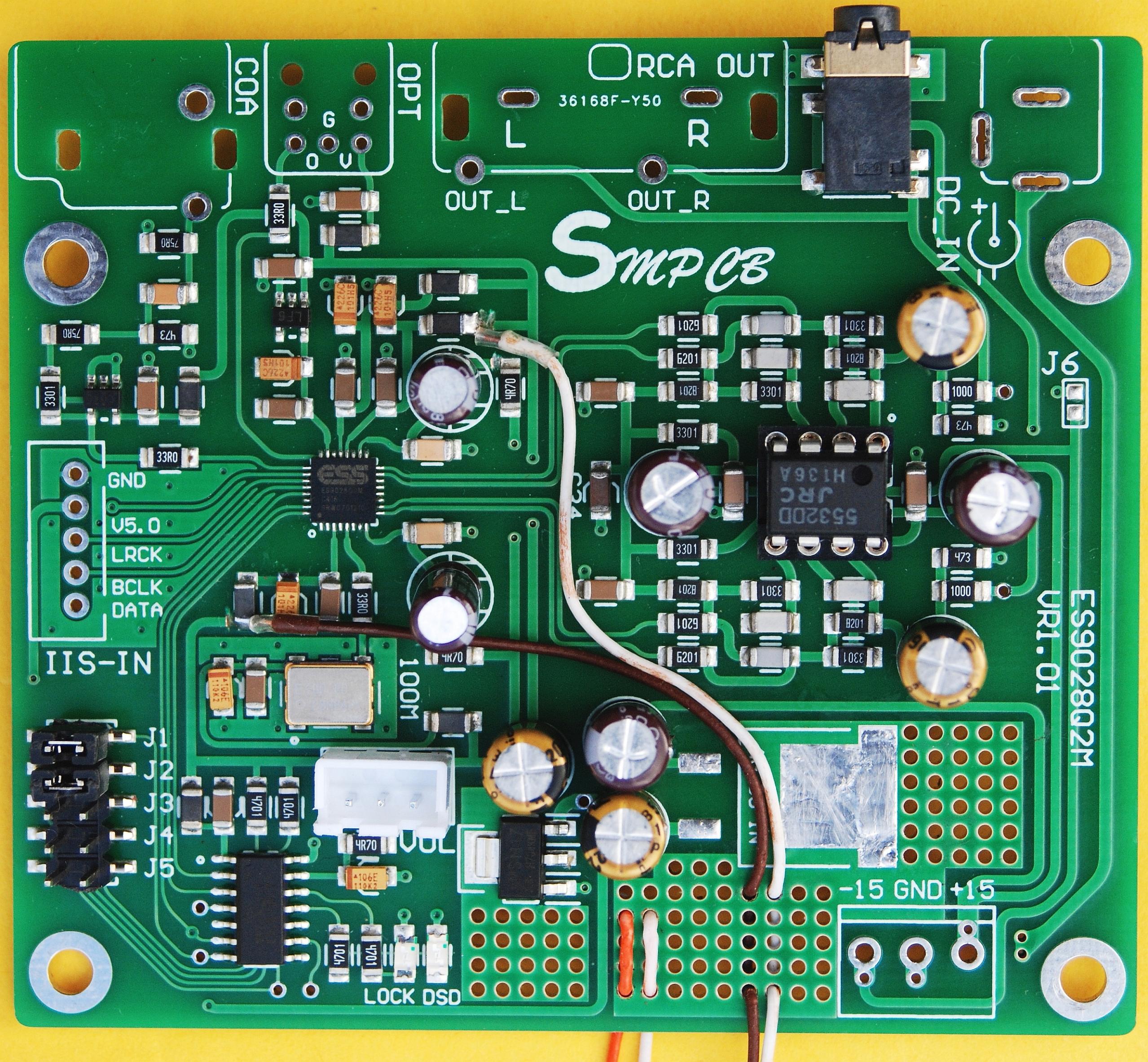

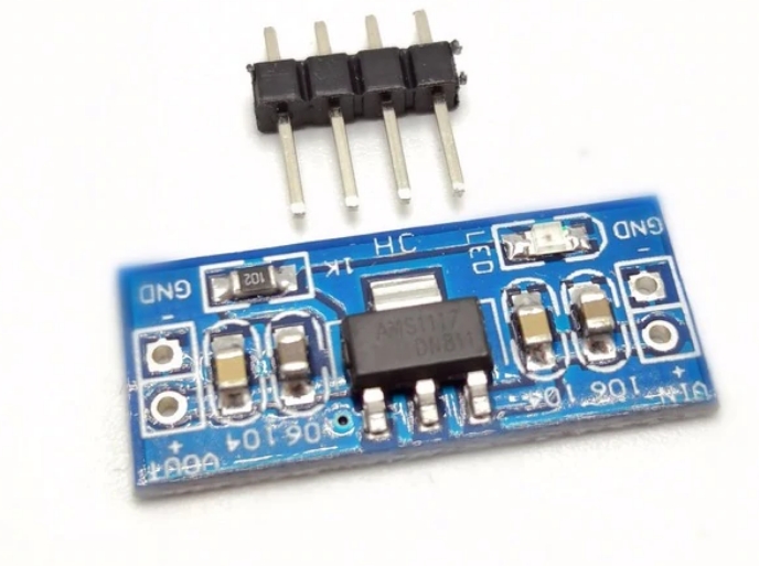

3.3v regulator modules are something like this:
10pcs AMS1117 3.3 DC DC Step Down Power Supply Module 4.5V 7V To 3.3V Voltage Buck Board Regulator Adapter Convertor-in Integrated Circuits from Electronic Components & Supplies on Aliexpress.com | Alibaba Group
they are a good price, so i just get more to grade them in pairs for avcc.

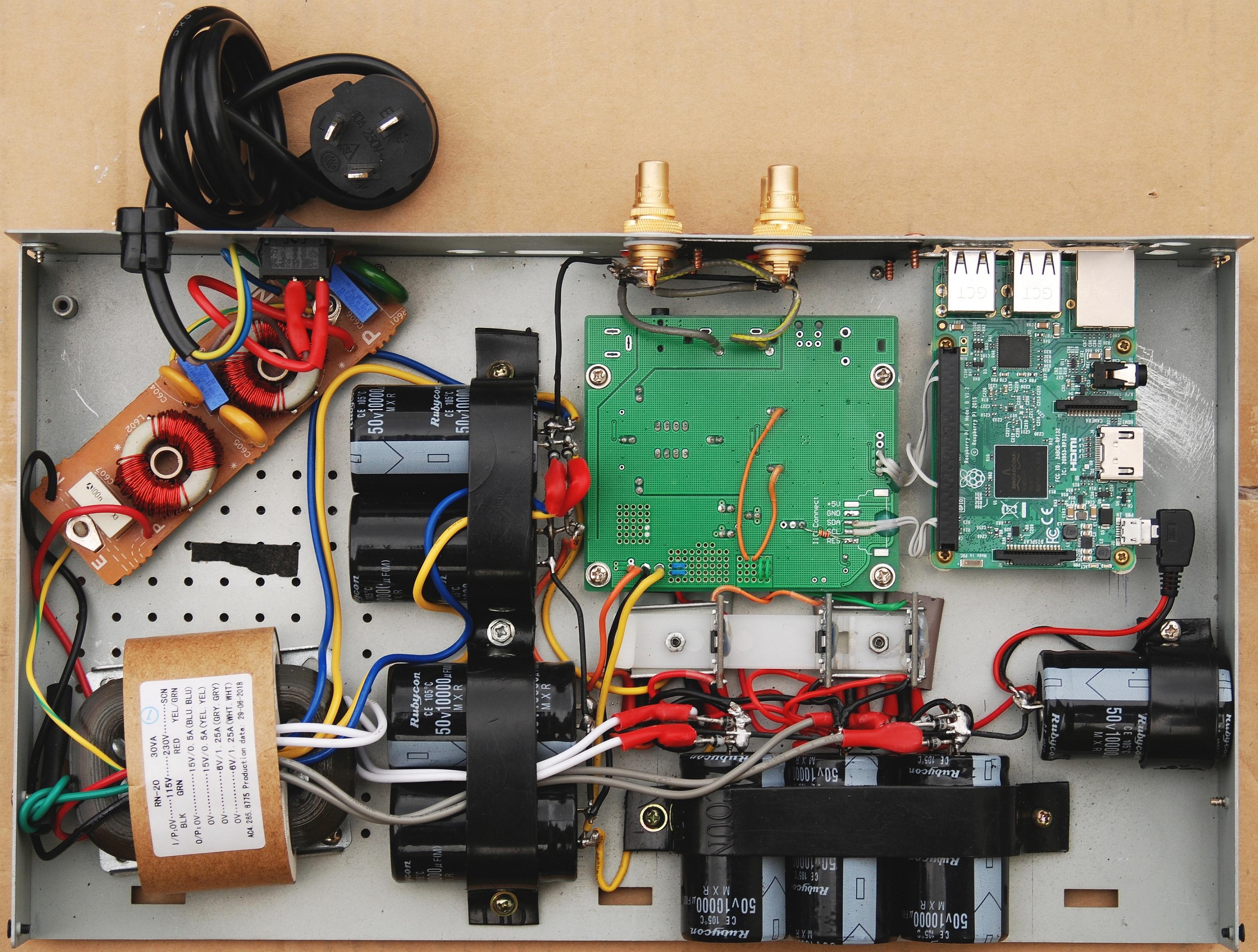

having big cap is advantage, i use eight 10,000uf rubycon capacitors, 4 for +-15v, 2 for rpi +5v and dac +5v, 2 for dac avcc and vcca.

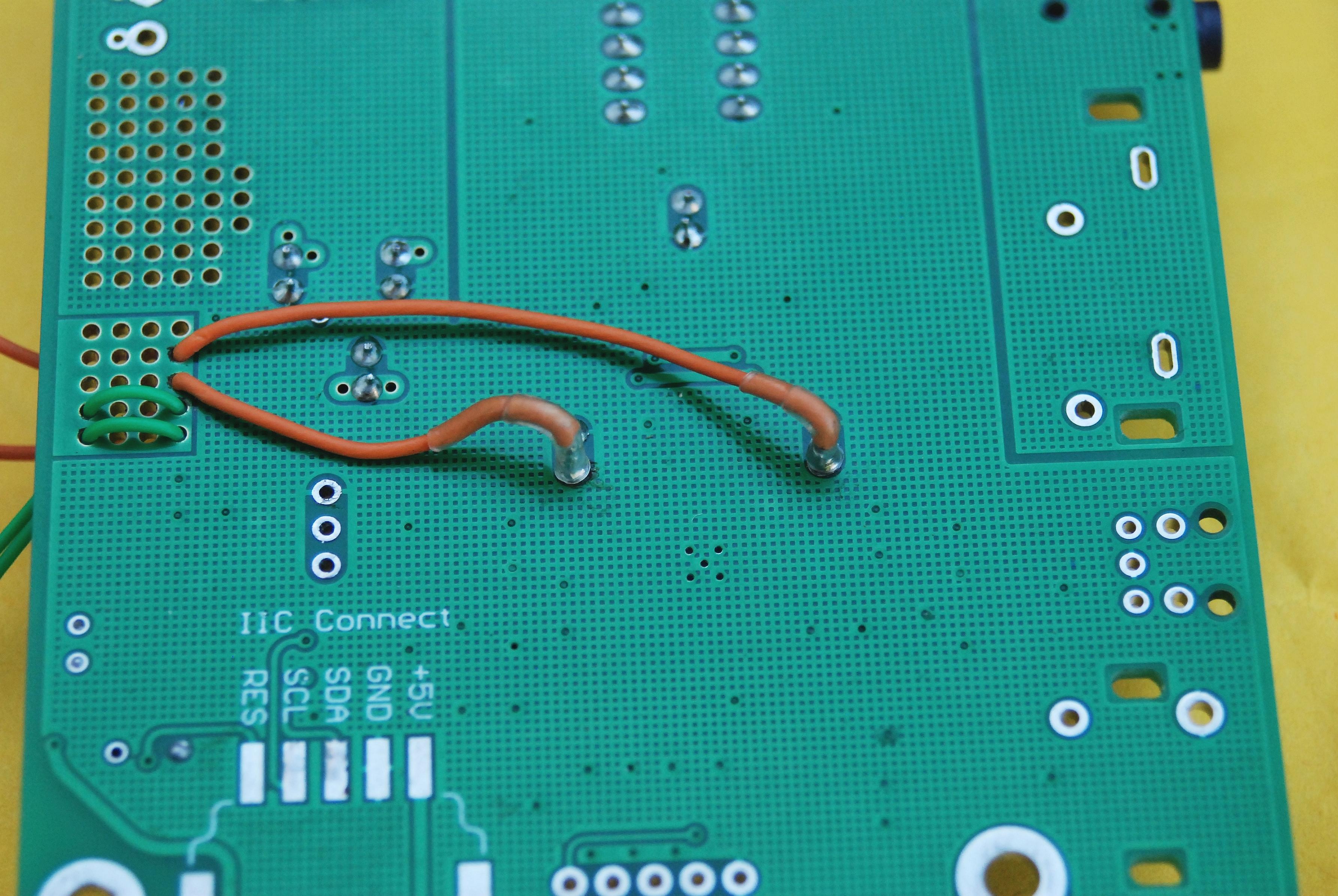

two 7815, a 7815 and a 7915 are underneath the three 1117's. 2 orange wires are chl and chr avcc, 2 green wires are vcca.
i made several units of this for myself and my friends, we all very happy for the sound quality.
it's quite straightforward, enjoy it.
cheers
cheers
