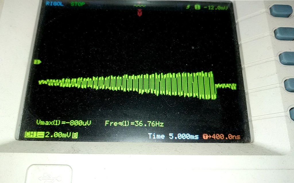

One more thing about this board\DAC. It is may be some kind of joke... But I can not force it to play square signals lower than 7kHz within 384k SR (through I2S). I have a file with the squared signals swept from 0 to 24kHz. And the DAC simply keeps silent untill the freq get up to ~7kHz. After that point it plays without problems till the end of file, till 24kHz. There is no problems when it's playing similar sinusoidal signals from 0Hz and higher. But for square signals lower ~7kHz (for 384k SR) DAC periodically loses the sync (Lock led starts "flashing"). But everything is OK with 192k SR.
